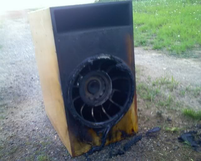

Holy christ!!!  that bitch got smoked!
Re: a Need to Vent
« Reply #9 on: January 06, 2010, 10:13:04 AM »
It was a 2005 RE XXX 15 with 2400 watts RMS going through it.
I threw that bitch out of the back of the van while it was on fire.

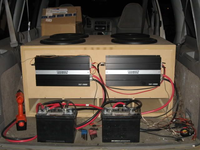

« Reply #11 on: January 06, 2010, 10:39:34 AM »
With the right box, you would be surprised with how tight the bass can be, even with 18's.
It was replaced with this:
It's no longer a daily driver.
Re: a Need to Vent
« Reply #12 on: January 06, 2010, 10:43:38 AM »
My god the fuckign door ripples like a damn puddle.  wtf man.
