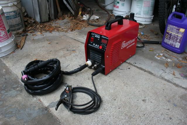

Here is the Cut50 after taking it out of the box and assembling it. I was going to get more pics of the assembly but there really wasn't much to it. Hook up the hoses and bolt on the regulator. Probably took 5 min to get it from the box to ready to go.

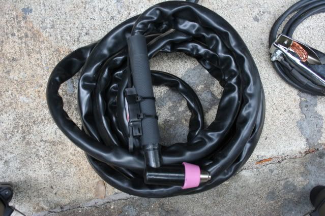

Here is the torch. It feels very solid. It has a nice weight to it that doesn't feel cheap at all. It also comes with quite a few tips. You could get years of use out of it without needing to buy anything

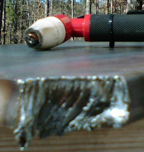

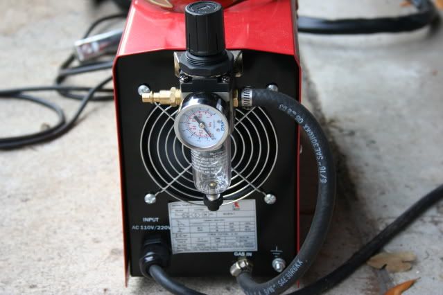

This is the regulator that comes with it. Again, I am amazed at the quality and simplicity of this machine. It's very user friendly.

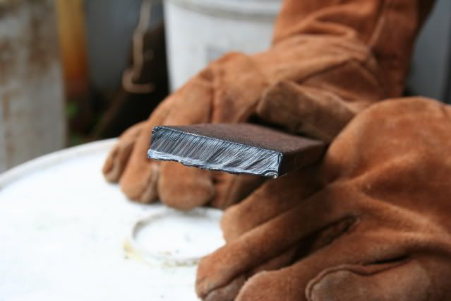

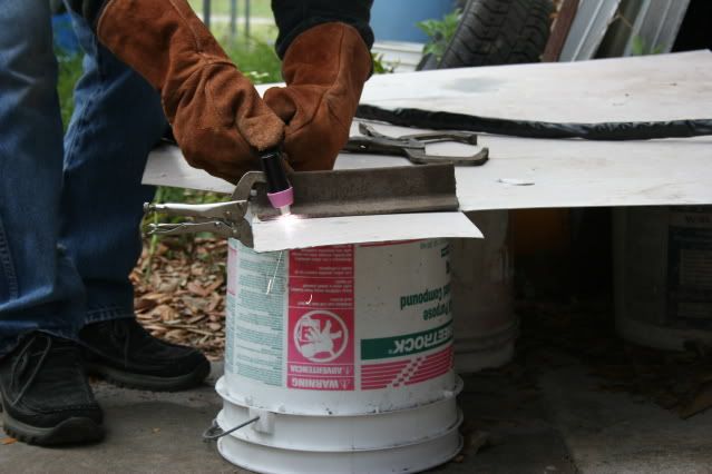

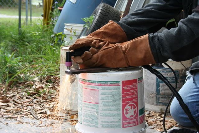

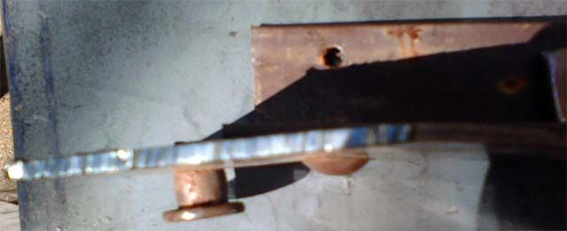

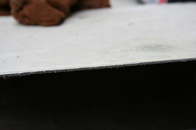

Here is my dad cutting some 3/8" steel. I think it would cut a full 1/2" but we didn't have any to try.

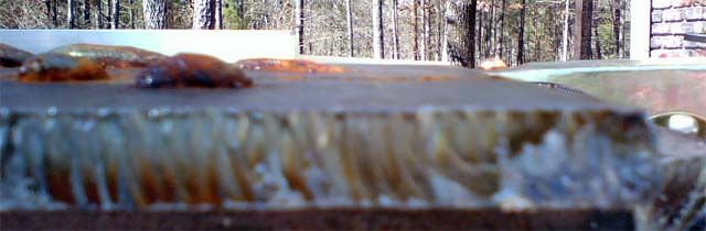

Here is the cut. This is after about 5 min of using it. A little more practice would make an even cleaner cut.

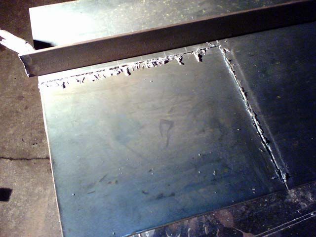

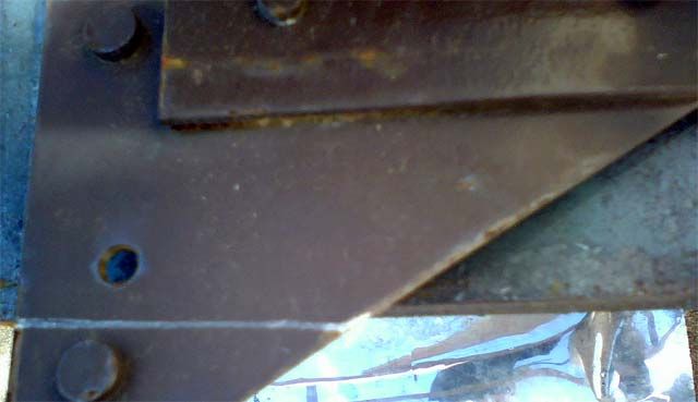

Here, he is cutting some aluminum. It makes some nice bright white sparks. The camera didn't really show them though. I really wish we had some thicker aluminum to cut, but this is all we had. I assume it would at least cut 1/4" aluminum, maybe more.
Here is that cut

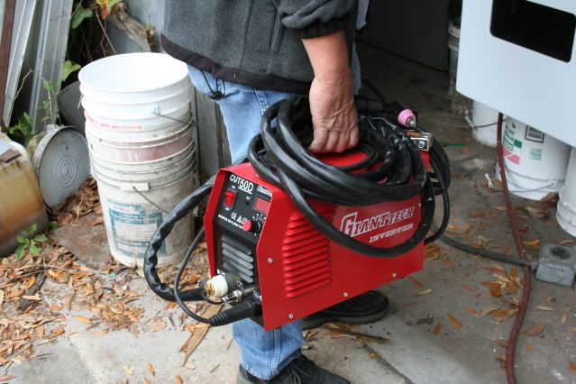

Here, he is carrying it away. It's very light and easily moved from job to job or take it to a friends house. Having a plasma cutter is like having a truck, everyone will be calling you to help them. It runs on 110v or 220v, so you can use it anywhere. All of these cuts were made with a 220v supply. One nice thing is that there is nothing to do switching from 110v to 220v. Just plug it in and it self adjusts.

Sounds promising.How much is that unit?
Re: GiantTech's Cut50 Review
« Reply #2 on: March 29, 2009, 01:41:00 PM »
not bad. how much was it?
these pretty much the same untis that Harbor Freight carries now?

$400 shipped is what he said in his thread

Snap a picture of the power cable to please

It's definitly fun to use. A lot of times I will cut with the plasma rather than my bandsaw just cause I want to.
I will snap a pic of the tip of my plasma torch. I have cut a he'll of a lot more than my dad has all on the same tip. It just has some black marks from arcing but it hasn't worn it at all yet

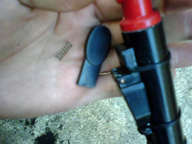

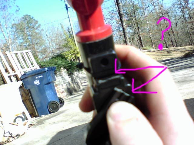

Here's what my 40amp did oh so long ago:

Here's what my first 40/amp unit did before it died on day 1 (spark gap):

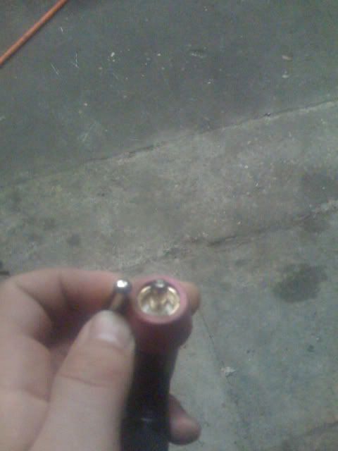

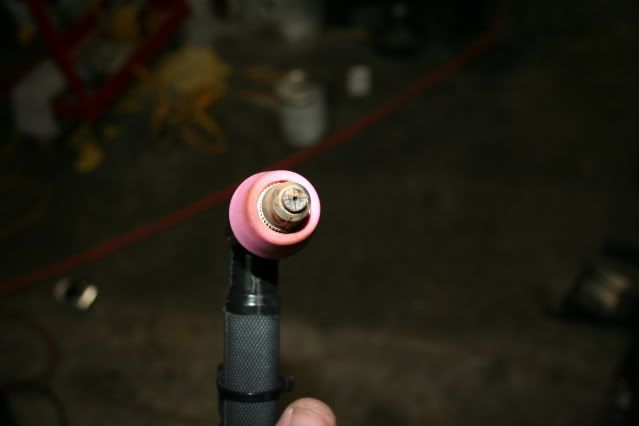

here is a new electrode next to the one i have been cutting with. i hope you can see it clearly. i took it with my iphone.
on a side note, i am using the tig, arc, plasma combo from Gianttech and not the stand alone plasma cutter. they seem to work exactly the same for cutting though
ok, so that pic is shitty. anyway, i will describe it for now till i can get the real camera in the garage. the only thing i saw was a very small crater forming in the tip. when i say small, i mean i had to look at it twice to realize that it was there and not just a black mark. again, i have cut at least a good 10' with that electrode. i have never used a name brand machine, but that seems like decent wear to me.
the electrode is over an inch long, does that make it a long one or short?

Thats a long electrode. Can't find any short ones on ebay right now. That's a good thing, if they phased them out. About the time I ran out of electrodes my shield cup was brittle and cracking apart.

The length of the electrode does not effect the life of the consumables.

The electrode length DOES affect electrode life. The short style electrodes were notorious for not making many cuts until they were eaten up beyond the HF's ability to jump start the arc.
