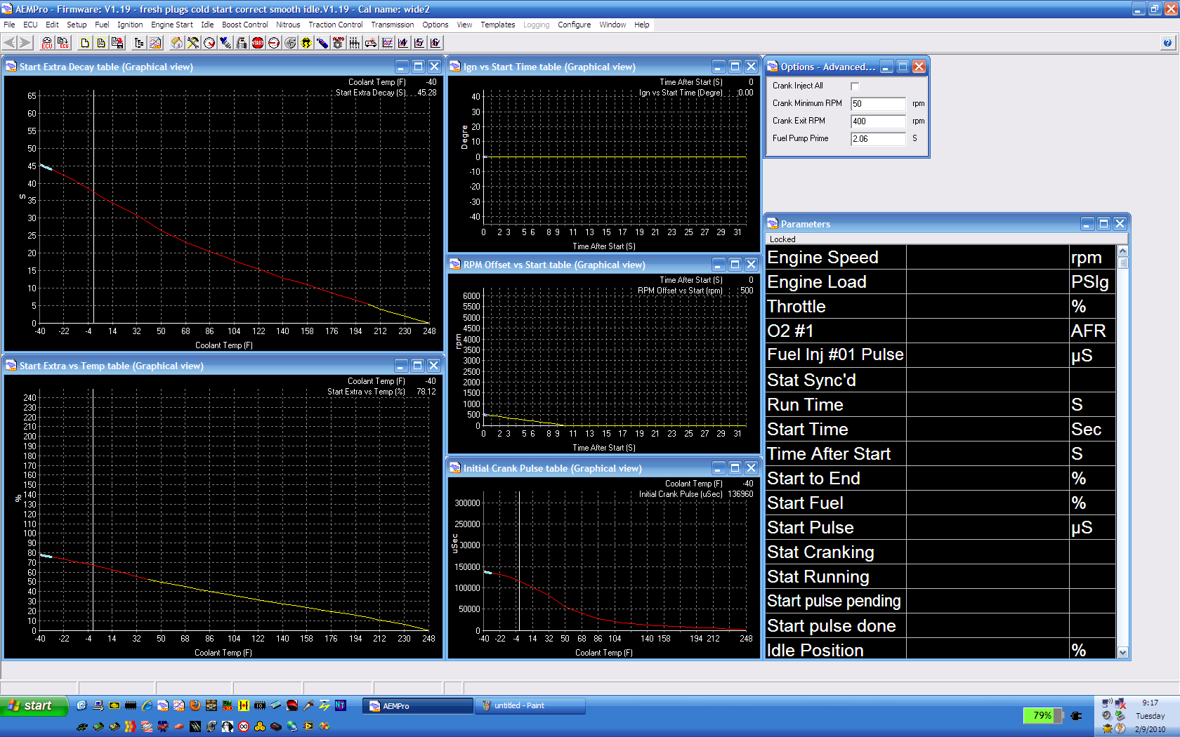

« Reply #14 on: February 09, 2010, 10:28:31 AM »
RB25DETT startup cal as provided by AEM, they tout these things in their forum as making significantly more power than stock and provide dyno sheets to back it:
What I came up with with E85 and 1200cc injectors (I think they're 1000's, the owner just knows what he was told)
I think it needs a hair more fuel sub-30 degrees.
