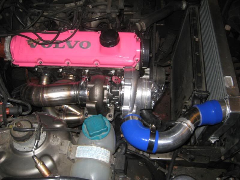

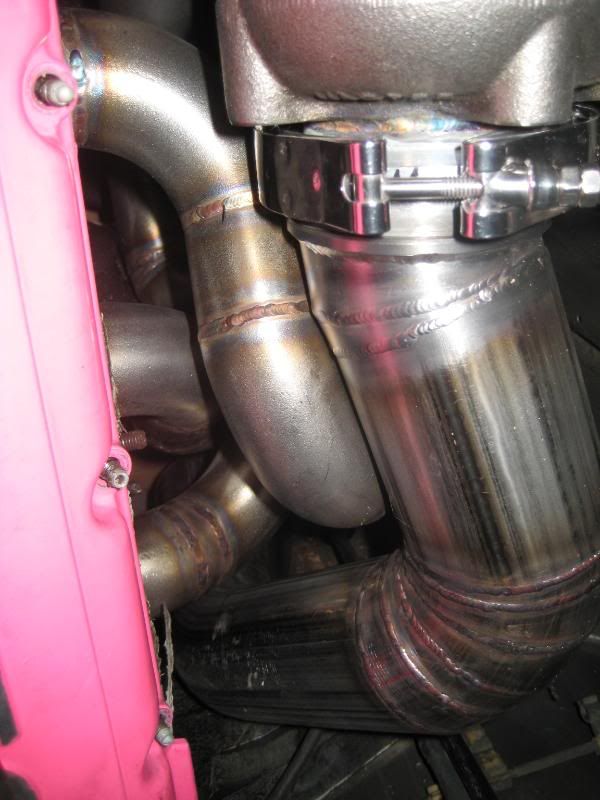

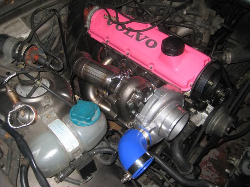

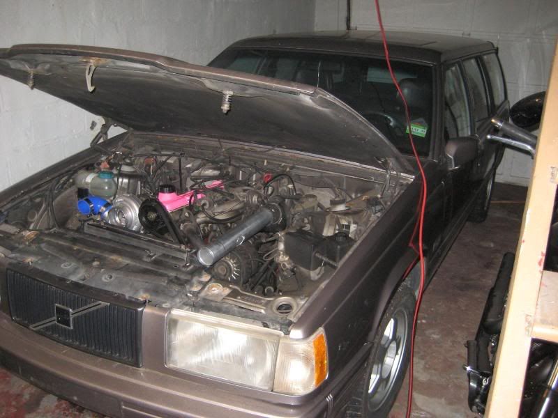

so here i was ripping through craigslist.  stumbled across a 91 740 turbo wagon with a/t for 400.  it didnt run.  i go get it, get it home and he fuel pump is dead.  i drop in a TRE 255lph hp unit bypass the stocker and she fired.  no boost i inspect the stock 13c ate itself.  so here we are again.   another hooktastic mediocre volvo build.
the spec list
stock b230ft
MEATY tubular sidewinder manifold w/ 38mm gate
MEATY pie cut stainless vband 3 inch dp
MEATY 2.5 inch alum chargepipes with type s knockoff
ebay cosworth bar and plate cooler with the in/out modded by me.,
FAST 65LB/HR injectors
dodge 4 bar
master power 60-1
TLAO chipped 967 and 146 ecus
aem wideband
enem v15 cam and geAR
heres where i am so far.  please keep the hatred and heckling to a minimum.:oogle:
tomorrow im going to hopefully finish the charge pipes i started and finish modding the cooler.
