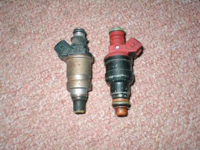

ok i pulled them their white tops maybe aftermarket idk but they say denso on them and 195500-2150 is the number im about to go look them up now....:) but yea the bottom looks a lil smaller then honda injector and the plug is differnt too.. but ill figure it out.....-maybe----- lol  Jew
jhonda
  • Posts: 384
  • BOATS-n-HOES
13.7ohms    and 326cc @ 3 bar ..... now just gotta figure out how to make them work/fit...
careful use of a dremel then finding proper O-rings, you'll need 8-12.
