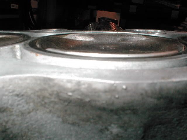

Re: d15b7 on vitaras
« Reply #1 on: March 10, 2010, 08:44:00 PM »
thats whats going to happen when the piston sits that far down in the cyl at TDC.

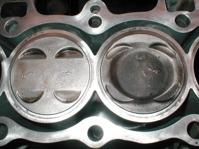

« Reply #3 on: March 10, 2010, 10:01:48 PM »
how about all b7 head/block/rods and y8 gasket and p2p pistons(y8) = 7.99 i think we have a winner or pm6=8.51

« Reply #10 on: March 10, 2010, 11:11:40 PM »
run VX rods, pistons will be .018" above deck.
