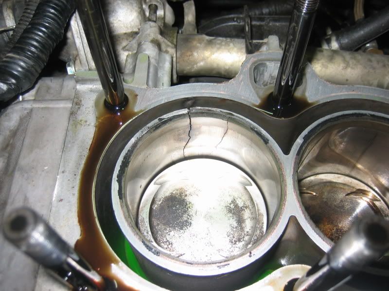

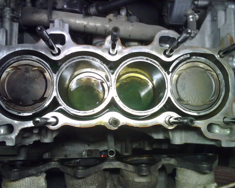

Yah, the coolant/oil passages were "linked" in the head.  It looked like the pressure opened the thin wall up as there was a thin shard of metal bent into the oil passage, probably why I didn't see it earlier.
Hey, I DID say that if anything goes wrong, I'd expect it to be there, and look who was right :noel:  Unfortunately, I wish I was wrong.  I cleaned it up with some contaminant remover meant for body work, but I assume it's just as well ass acetone.
If this doesn't work I'll just throw on an LS head, fuck it.
Will have a new block in a couple weeks.  Then will remove a piston from the old block on a Wednesday, take block/piston to shop Thursday, get it back Friday, and swap it over the weekend.  It should hold for now...
And as JD said, this is my wretched vehicle.
Other than possibly burning coolant/oil, will I have any risk of fucking up pistons if the sleeve really decides to crack open or does it not flex THAT bad?  I'm assuming since the piston will be moving away from the crack after combustion and the peak PSI that the cylinder wall flex won't really fuck with it.
My pistons are in motor #3....first 2 split a sleeve and the slugs looked perfect  :noel:
1st was due to my shitty tuning and not changing the injectors to 550cc instead of 240cc
2nd was boost fluctuation and taking it too close to the map sensor limit and spiking to 26psi with a Moto 2.5bar. Again my fault for not fixing the problem and raping it anyways.
Oh well, sohc blocks are cheap haha

I figured they'd be fine but always like to check instead of taking expensive risks...
Will run this block til it dies or I have a new one ready.

Fuck man, sorry to hear about your luck, but I'm glad you found it.  Don't you know any niggers with tig welders?  how big is the gap you have to cover with epoxy?  Is it easily accessible? sorry for the lack of B-knowledge.  I have seen epoxy cover pin holes, but not much more in a coolant passage blowout.  Can you post a pic?
I'd have no problem running that block as is.  Just keep it in the back of your mind every time you go for the boost pedal :P

Trevor - I don't have any boost yet so this block will hopefully hold until I can get a fresh one in :P
The coolant/oil passage just had a small but noticeable hole.  The cold-weld crap should hold judging from how thin the original aluminum wall was.  It's fullllllll of epoxy now so *shouldn't* leak, but I guess we'll find out either tomorrow or Friday.  I don't remember "hitting vtak" when I drove it those few minutes and power seemed to fall off before I got to 7000ish RPM, possibly because it didn't have the oil pressure it needed.

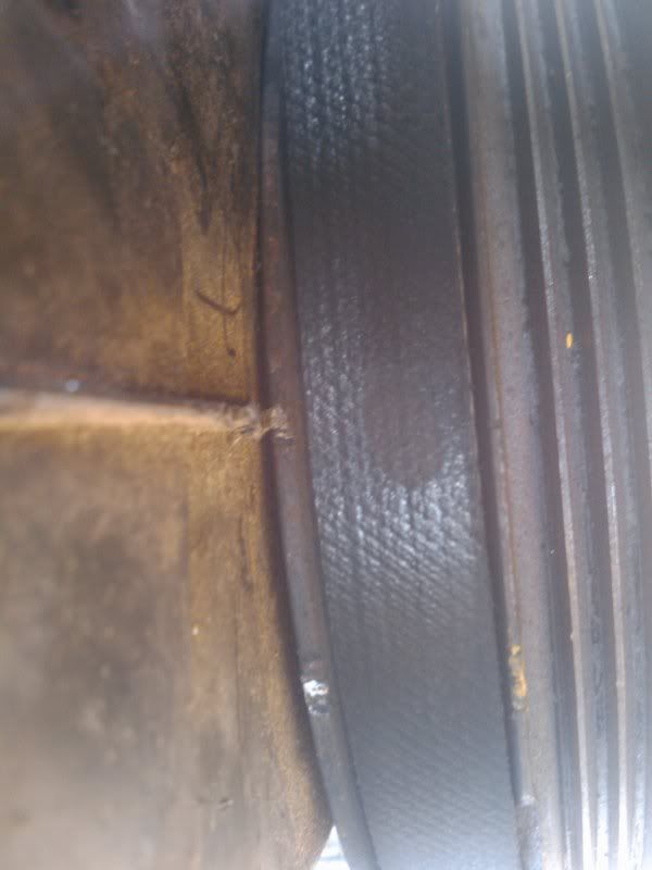

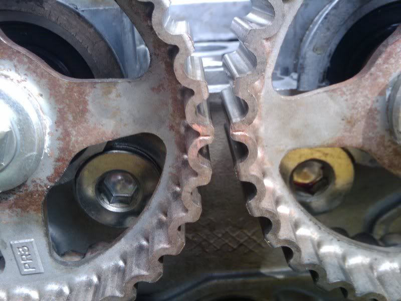

Mechanical timing is correct, however when I try to set the distributor I can turn it all the way forward and it's still not enough.
Going to double check I have the wires in the correct location...
Re: Need help, car broke already (updated 5/4 with more BS)
« Reply #56 on: March 20, 2010, 05:55:31 AM »
Off by a tooth, who's got $5 to throw down?
« Reply #57 on: March 20, 2010, 03:40:59 PM »
Just to put the "mechanical timing is off" thing to rest, here are pictures:
Unless I'm completely wrong, that's how it should be, which is why I don't understand retarding the distributor all the way and it still not being enough...
Yes I'm jumping the service connector.  It's more stable than without it jumped but still about an inch forward of the notch on the timing belt cover.  I know that it's properly jumped because the CEL is solid when I start the car.
When using the timing light, the BTDC notch is showing up about half the distance between TDC and the BTDC notch.

Even verified the key is in the crank pulley...
Any ideas?

Pulled out spark plugs, dripping, a different one is now fouled, looked down the hole and in the cylinders I could see liquid on top of the pistons.
