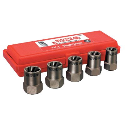

google stripped lug nut removal tool. Any autoparts store sells them, comes with a couple sizes for 15-20 bucks. It's a socket looking thing with reverse tapered threads so it screws onto the ouside of the stripped lugnut while tightening down on it. I've used them several times, always worked for me.

Pat, that's what I was thinking of getting.  From what I understand, the lock still works after using them.  The locks just get beat to crap as a result.

the ones I used it didn't mess the locks up much. Depends how tight they are I guess, but it just barely scratched the chrome on my trooper's locks. I guess if you want to not damage them, find/buy the right tool and just wait. I doubt there is a miracle tool out there that fits every lock without putting a scratch on it.

Get a stripped bolt removal set, remove the locks, and order a new set.
