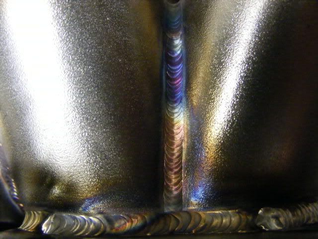

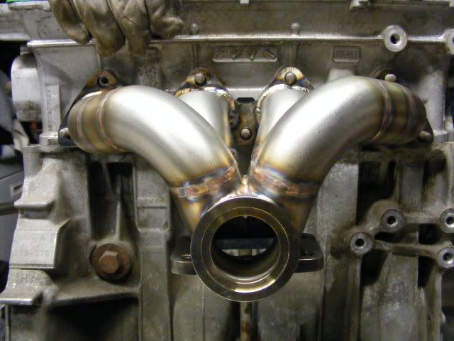

This is the Mini Ram I was working on for Hatchbox90. 44mm Tial V-band FTW.

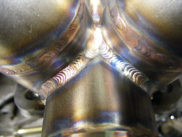

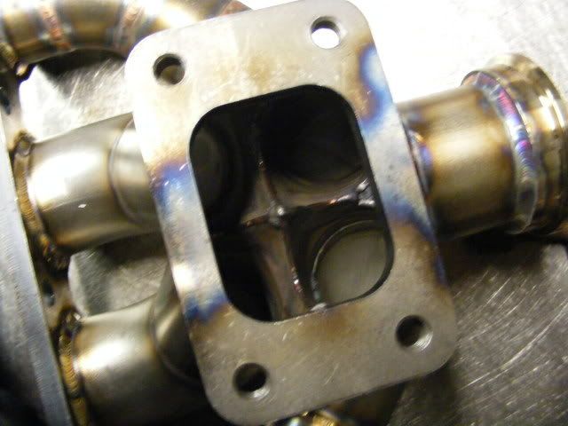

Wow - that looks really nice.  looks like to welded the inside of the collector as well - TITS!!!
Re: Another mini ram....blah blah blah
« Reply #3 on: April 01, 2009, 05:15:33 PM »
Yeah, the mini is easy to get at on the inside so why not, right?

How tall are those collector pieces and what angle did you cut those at?
« Reply #17 on: April 02, 2009, 06:35:31 AM »
They start off 3.5 inches. Im not sure on the angle. I will measure it for you. I cut down the collector after welding it all together then weld the inlet flange on. That way I can keep the turbo as high as possible.

Do you clean or polish the welds afterward at all? Almost all my stainless welds come out dark and crusty no matter how much I try to keep the heat down to avoid burning it out...
unofficial brokenog
« Reply #21 on: April 02, 2009, 05:30:24 PM »
are you using Pulse on the Thermal Arc??
No pulse. Why, does there anywhere on there that looks pulsed?
Looks amazing
Nope, that is the end result.

Damn, very nice. Is it touch-start of high-frequency? We had to do some touch start in class since we were getting ready to do stainless tubing and our instructor said that's how a lot of the industrial places do it. Either way, I could never weld stainless for shit.
I guess I'll stick to mild steel manifolds  :somb:
Looks amazing
HF start. You can weld stainless if you can TIG other shit. Just keep everything super clean, good gas coverage, don't pull the filler out of the gas inbetween dabs, and from there its just seat time and getting to know your own speed and comfort level.
