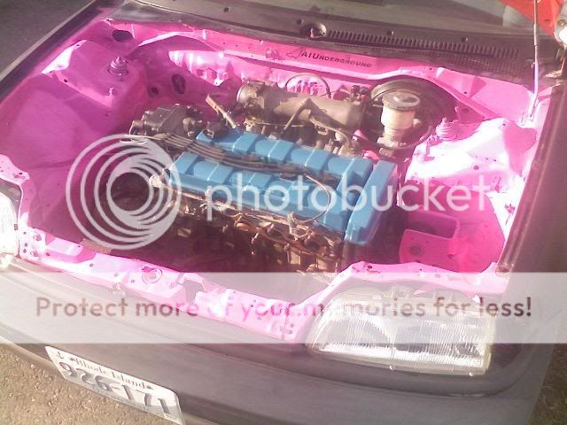

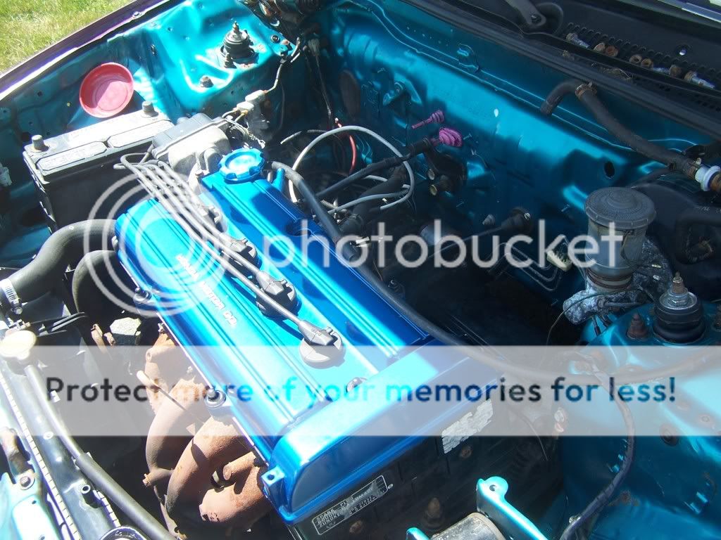

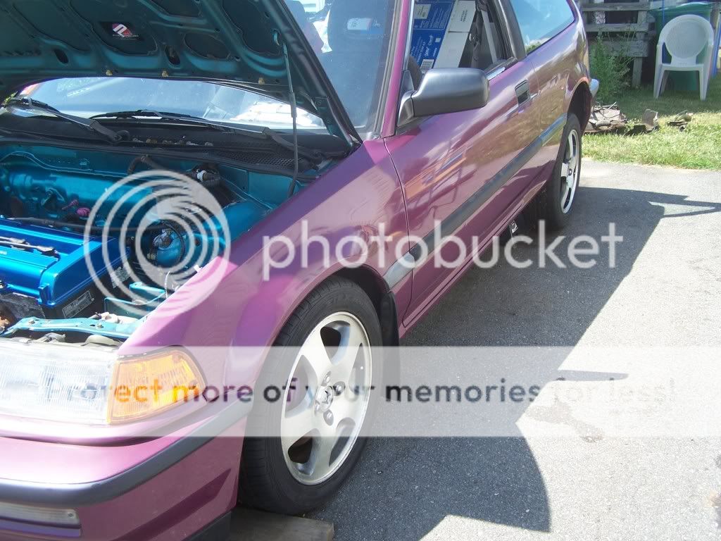

Upadate is..... I got another 88-91 civic hatchbackback..
This is how far I have gotten..
Re: Project Bang For The Buck!
« Reply #41 on: July 12, 2010, 08:12:07 AM »
Sir, you need to install the intake manifold to be able to drive the car.
« Reply #42 on: July 12, 2010, 12:39:29 PM »
I need to do alot of things to beable to drive this thing....
Parts need:
B-series axles
B-series shifter linkage
B-series shifter bushings
Fuel filter
Ground controls
Parts installed:
Walpro fuel pump
Full 89 crx si body harness
98 integra front seats
Koni yellows
Obd0-Obd1 Jumper
Chipped p28
95 LS motor/90 LS tranny

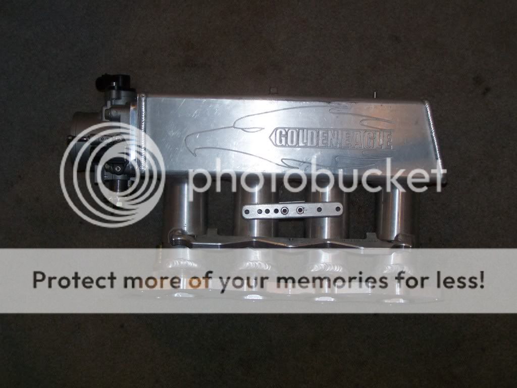

Btw I did not pay any moneys for that GOLDEN EAGLE intake mani....  It was given to me for FREE!
The kid that gave it to me said he was never gonna bulid an LS again and I could have it.... 8)

Whats the opinion on the Golden Eagle Intake Mani?  Im gonna use it cause it was free and its WAY bigger than the stock one...  I also have the Chris M. TB and spacer mounted on it..

« Reply #48 on: July 12, 2010, 11:22:47 PM »
Big plenum makes for big power on a boosted car.  I've only tuned one, turbo B16.  .60 trim T3/T04E, AFI ramhorn, 68mm BBK throttlebody, stock sleeve piston/rod motor.  Car ran impressively well for a B16, it's still rolling around after 2 years with a super nice guy who doesn't know the most about cars flogging on it daily.

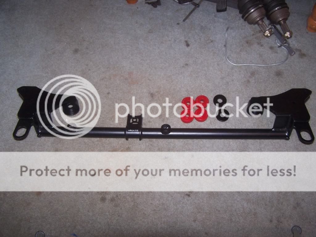

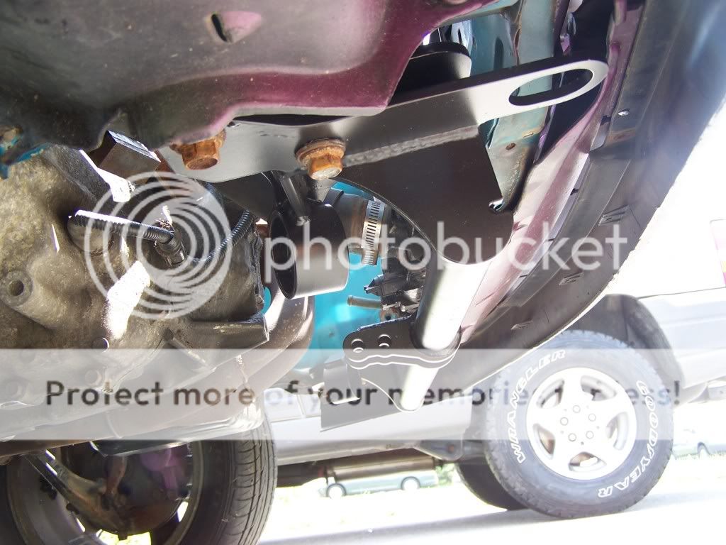

« Reply #53 on: July 24, 2010, 12:45:08 PM »
Baller crossmember!!!  Half rad!
« Reply #54 on: July 24, 2010, 02:06:17 PM »
What brand is that?

What brand is that?
Inovative mounts.....  Paid around $280 shipped...

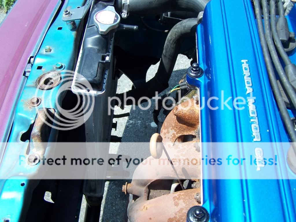

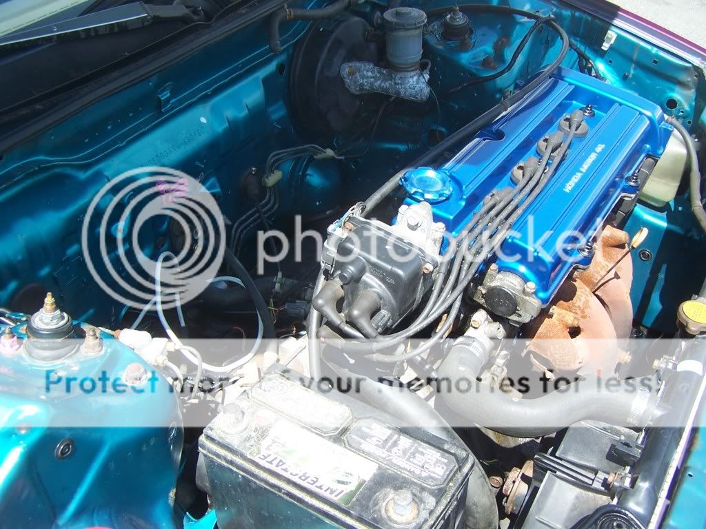

« Reply #58 on: July 24, 2010, 10:35:01 PM »
May I ask why there is tin foil on the master cylinder?
