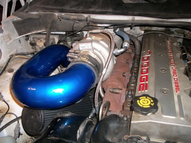

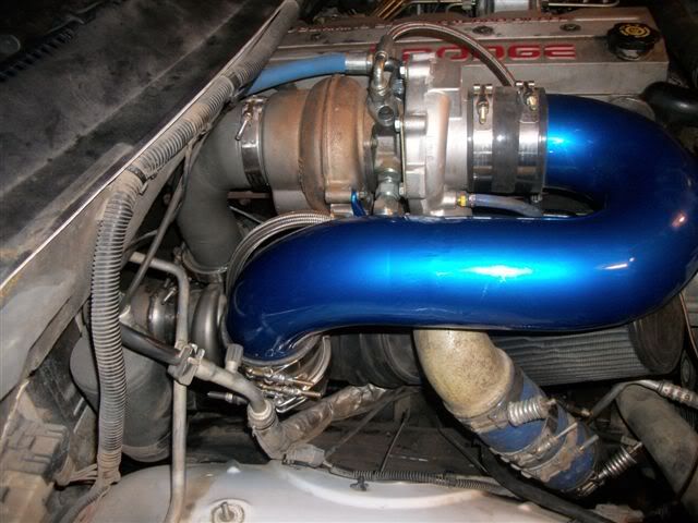

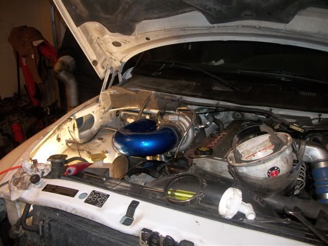

Well I don't have any of the fab pics, just a couple of the finished pics. I will get some of the fab ones from the camera man.
Cold Pipe, hot pipe and brackets were done ahead of time (obvious by the powder coat), just the down pipe and mid pipe, and charger to intercooler pipe were fabbed last night. Total install time with fab last night was about 7hrs, total beer consumed 15, and two sprites (the trucks owner doesn't drink beer just whiskey, the garage owner only has beer  :-\).
Previous setup was a single silver bullet. Aka S300 66mm compressor 71mm or 74mm turbine. Previous setup 10psi @ 2000rpm new setup 55psi @ 2000 rpm. Test drive last night was kinda useless as it was raining and even in 5th gear it was just wheel spin and peddling. It is sunny today, so hopefully the owner of the truck will have some time to do some tuning on the secondary gate, and do some proper pulls.
Current setup of this truck is:
1998 24V Dually 2wd extended cab.
12mm 913 P-pump with a quick rate cam, benched to 500cc. 5K gsk that do not go to 5k and have idling and fueling issues still. 13mm P-pump from reputable shop on order. Min setting ~650cc
O-rings and studs.
Fass lift pump.
220hp sticks
GT3782R over GT4202R with Tial V band exhaust housing.
Once this setup gets sorted it should make 750sh on #2.
