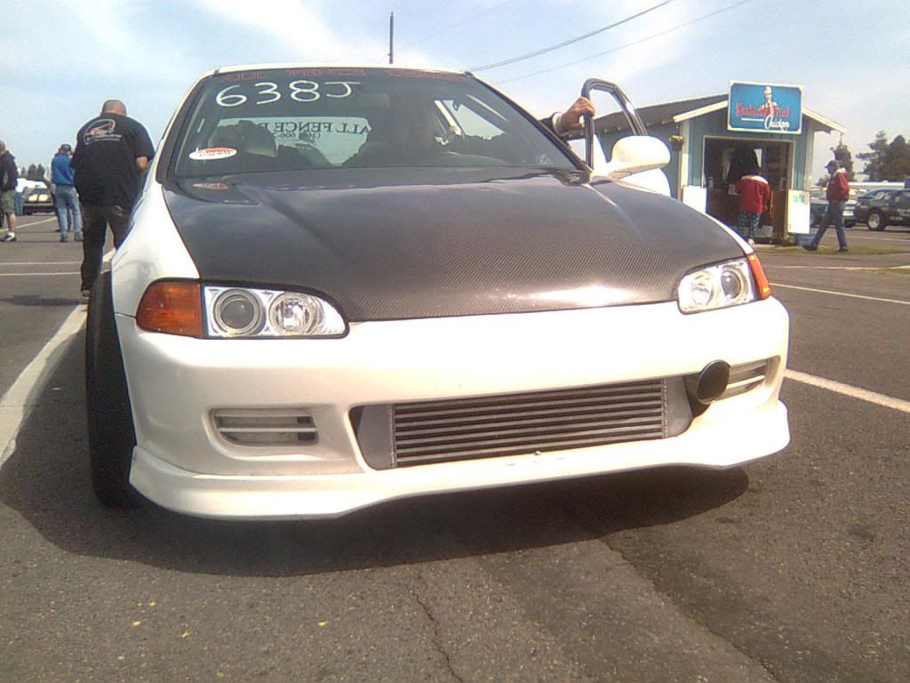

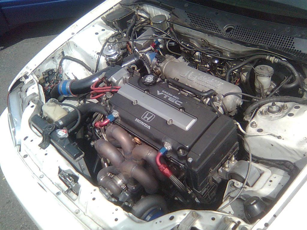

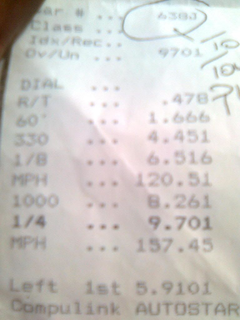

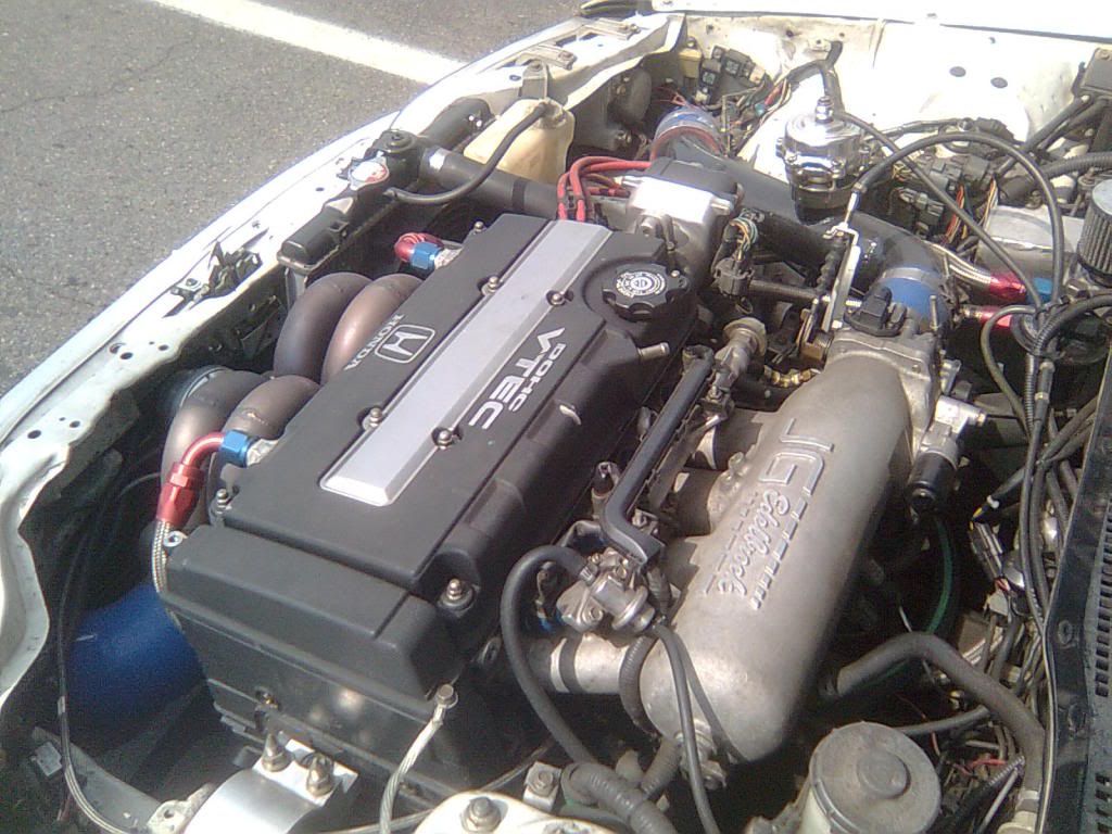

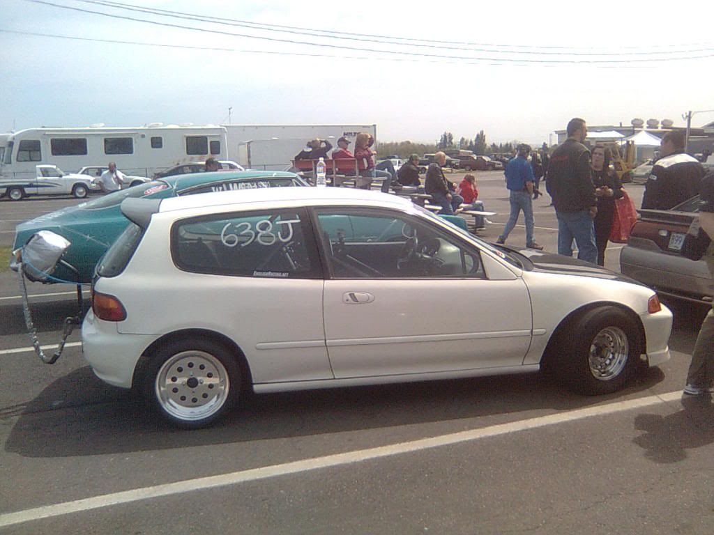

Its been a long time coming! Best previous pass was 10.1@149..
Pretty simple setup..
Sleeved 81mm GSR
Mahle pistons
Eagle rods
OE bearings
GSR head
JG intake mani
Crower valve springs
ITR cams
1mm oversize valves
ETS intercooler
FIC 1450'cc injectors
2 255 fuel pumps, one inline/one intake (Stock lines/Fuel regulator/Fuel rail)
Gsr tranny with Racerstev heat treated gears
Gsr Quaife
Tilton Twin
25X8.7X13 M&H Slicks about 20-25 passes on them
Tuned on Crome gold..
Boost control Via AVCR
car made 757whp/460-470tq on Q16
Here are the vids of the day... his first pass was the 10.11@153, 2nd pass was the 9.70@157..they are just ordered different...
Justin Nassey runs 9.7@157mph 92 Civic HB T4/67

700+ on stock lines and a stock fpr? :o
Re: Northwest has another 9 sec honda!
« Reply #18 on: April 26, 2010, 09:17:37 PM »
ya i was gonna say something abouhjt the sztock line thing
gringotegra
  • Smoking Bisimoto's Builds, 1 Car At A Time
  • Posts: 1565
  • BISIMOTO KILLER!!!!!!!
« Reply #19 on: April 26, 2010, 10:11:52 PM »
Yes if i recall correctly it is a Tial Knock off..
This car has been running in the same form for about 3-4 years... he went 10.4@145 with an ACT 2600 and a non sprung 6-puc on crome with no 2step in 2007.... Brian you probably saw this car @ BOTI Seattle 2008...
Yeah Stock fuel lines all the way around :P, crazy... it makes 757whp@32psi at one point when he would drive it on the street it was making high 500's on pump...
