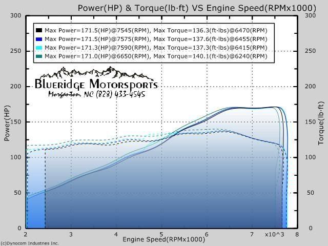

Anyway, on top of the thread that's already been linked to ( http://www.realhomemadeturbo.com/forum/index.php?topic=13016.0 ) I would like to add that 33mm intake valves are cheaply sourced from 88-91 Preludes.  Wes and his brother Tim have been through a couple of setups like that, works well BUT you must run a VTEC piston to get the correct valve releif.  Blah blah blah LS heads don't flow, but goddamn if the ports don't look just like a B16.
Lastly.  here's an 11.5:1 LS with 404s and destroyed header.  The owner liked the slammed look, so the bottom two tubes of the 4-1 were smashed half shut.  This dyno graph is across a couple of different cam adjustments, you can see the powerband move around right up until the motor chokes off due to the fucked header.  Sure looks like it'd make 200 whp by 8K, which Sewell's gotten out of either one or two of these setups.  Not bad for a stock head with some cams and springs dumped on it.
Looks like it was close to being done making power to me.
Impressive numbers nonetheless, for an LS.  LS heads don't flow better then stock vtec heads unless you put retardedly big cams in them, i've done my research.  If you have evidence proving me wrong then i'd love to see it.
A bolt on ITR would make 170whp, probably more depending on the bolt ons and tuning, MAYBE not as much torque, but the HP would be very similar, and it would carry power up to 8k unlike a poor flowing LS head.
I could post lots of dyno graphs of vtec headed motors making close to 200whp with very mild mods, but I dont feel it's neccesary to beat into the ground what head is superior.  From the hundreds of graphs i've seen the winner is very clear.
Yes, half crushed header primaries and 2.25" exhaust with 2" glasspack as a resonator aren't a restriction at all. It's all the head's fault.
No, when it's done making power the power drops off instead of going perfectly flat.  Also, when the cam gears are walked through eight different settings, 4 degrees in each direction, the powerband will move up and down, and the peak power will alter drastocally when moved away from its sweet spot - this car hit 170-172 whp at 6400 rpms and went flat, every time, with perfect repeatability.
You read some forums?  Cool, I tune cars.
