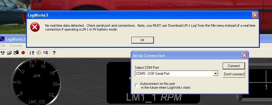

well now my plx doesnt like any of the software. i didnt have much time to mess with the SSI-4. so the iMFD SM to USB adapter doesnt seem to be working on either RX or TX on either PLX Digital dash 2.2 or Logworks 3. im getting ready to email PLX but i seem to get best results from RHMT.
I have it on Port 5 latency is to 1 and i have tried different Baud rates and still nothing. also i have tried with and without the termination jumper.
Screenshot of Logworks
also tried the lm1 log nothing again.  ???

It's pretty obvious that Logworks won't support the PLX unit.  I've never used PLX serial gear to be able to comment on that.
Use Logworks3 with the SSI-4.  Use the SSI-4 to log MAF, RPM, and the PLX's analog output.
