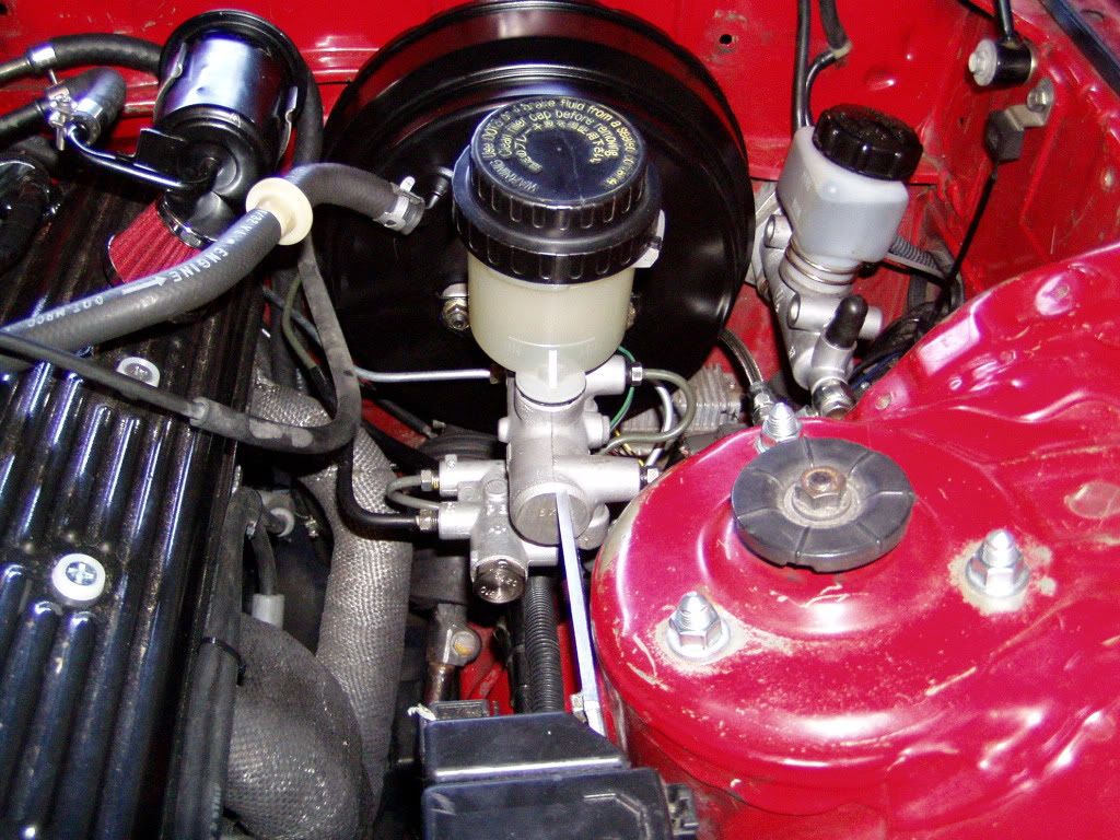

It was one of Slater's 1001 writeups in 1997.  Might have been ceas, IDK, he just posted a lot and drove a stock CX IIRC.  He (whichever one) took two 90 degree shelf hangers and butted them against each other on the shock tower, then passed threaded rod/bolt through them and tightened it into the nose of the master cylinder.  Secured it with locknuts.  Sweet perfection.
