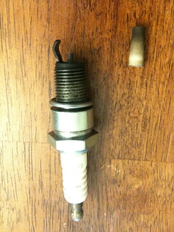

Anybody have any clues to help this problem?  I keep having the insulator tip on plugs break,  they break off clean way up under the threads and then drop down and cover the electrode.
I can't hear any detonation, a/f is super safe as well is timing.
The only thing that I think could be causing it is the two-step, but I need my 2-step :)

Plugs are NGK/r  BPR5EY  11
Don't think :mexi: material is causing the problem as there isn't any nicks or material in the ceramic tip.  It looks pretty good other than the fact it is no longer attached to the plug.  This is about the 4th or 5th time it's happened.
I bent the strap up to get the piece off for the picture.
Is this in a boosted car??? Thats a really hot plug...
Re: Keep breaking insulator tips on spark plugs!!
« Reply #9 on: May 24, 2010, 12:28:47 AM »
I was wondering the same thing. Sounds like you should be running a heat range colder or more.
Maybe a BPR6EY  11 or BPR7EY  11
W/o the 11 at the end it just means it was pre-gaped at 1.1mm = 0.042"
If you are running the wrong heat range you could be heating that plug so hot that you are un-fusing the porcelain from the metal part of the plug. Which would explain the evenness of the porcelain tip bottom.
Now looking at that more I'd almost bet that is your whole problem.

Yes, in my starlet.  running e85 and around 30# of boost (soon to be 40)
I picked up the "6" equivalent in Champion,  going to order some colder NGK's online since parts stores don't seem to carry them.

The plug ceramic is getting too hot and breaking is my gut feeling.
This, pretty sure I'm not detonating. Fuel is on the rich side, timing is conservative and the rest of the plug look like new. No specks, spots, or burn tips. The E85 pretty much keeps
them looking like new.
