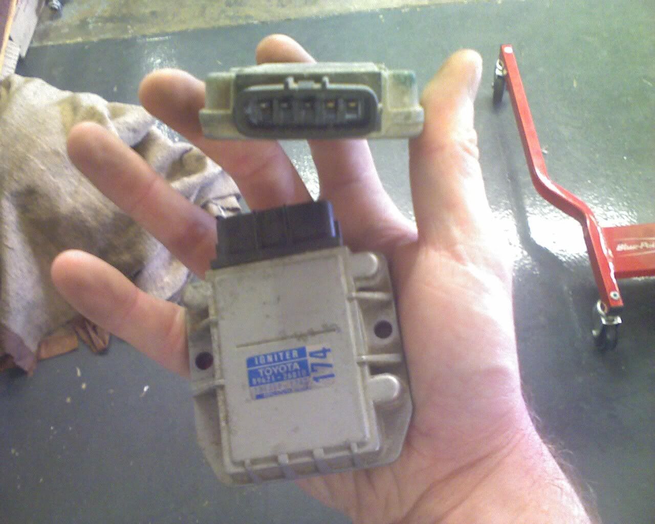

NAPA/Carquest typically carry a higher grade of electrical part than the china parts stores.
Also, an external Denso ignitor from an 80-90s Toyota (truck/MR2/other) is electrically the same part, and are much easier to find at junkyards.  Just get the pigtail.  Wiring is simple - power, ground (through body of Toyota/Denso ignitor), signal from ECU, signal to (-) side of coil, tach feed.

Knowing you, you'll have five by this time next week and two wired in parallel with the stock ignitor so you can flip a sqitch between them as they fail in some hybrid of Mad Max and military-spec triple redundancy.
Just so we all know what unit I'm talking about:

« Reply #27 on: May 24, 2010, 01:18:07 PM »
Toyota igniter is falling edge trigger.
It also controls coil dwell internally. It'll work, but you need an RTL inverter in the trigger input, since the honda is rising edge trigger.
