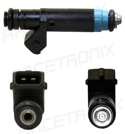

I'd rather drill out the fuel rail to a 14mm inlet.  You really need a lathe to modify the injector itself, correctly.
And, not that great a deal for that core.  Try this on for size:
http://www.racetronix.biz/itemdesc.asp?ic=FI114992&eq=&Tp=
High-Z, bitches.  Still has the 14mm inlet, though.

« Reply #13 on: June 01, 2010, 05:13:21 PM »
95% of injectors I've dealt with are plastic at the top and modifying them is entirely possible.  SecksyScott's right, it doesn't take long.
The 80# GT500 injectors I linked to (available in the newer EV6/OBD2 clip as well as the LH-Jetronic, same price) are the same construction/core/model as the SRT-4 units I had.  You can file those down if you need to, plenty of plastic up top.
Do these have good flow characteristics?
How do they compare to Delphi's for idle quality?

Corey has a set in his car.
I've dealt with the 500cc '04-05 SRT-4 flavors of that core, same exact picture (only with EV6 clip) down to the blue tip, except there's a Chrysler pentagram on the side of the injector.  They were a good quality core that atomized fuel well enough to support lean burn.  The 80# units may or may not do so - at some point a big injector sacrifices atomization for flow.  This is a common turbo car theme, as atomization doesn't matter so much when you have a large amount of air mass raising hell in the chamber.
