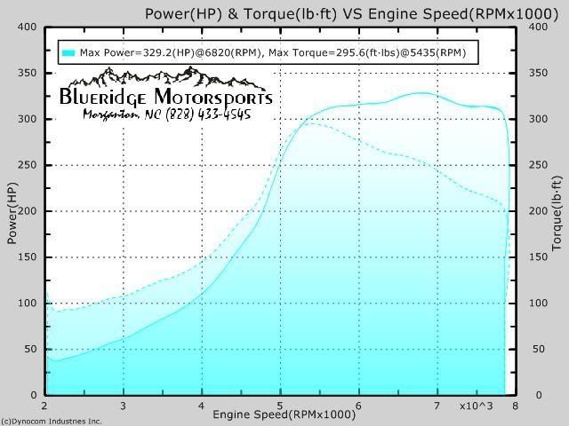

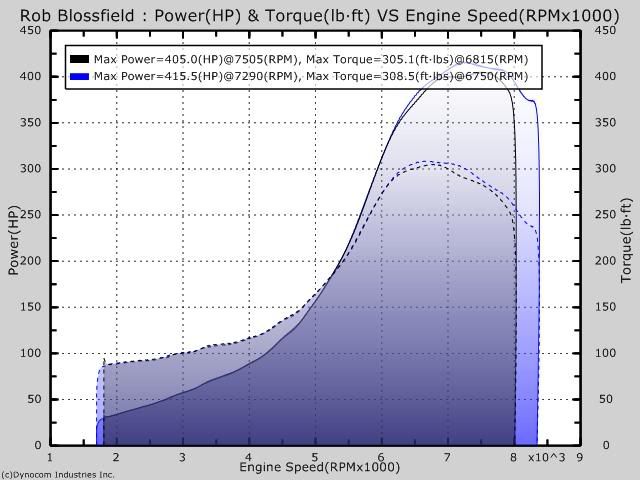

D16Z6 with GT28RS on kill:
Exact same car/setup with the T25 flanged GT3071R on kill:
Net change in track times: went from consistent 7.5-7.6's to consistent 7.4-7.5's.  One tenth.
