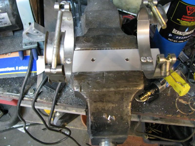

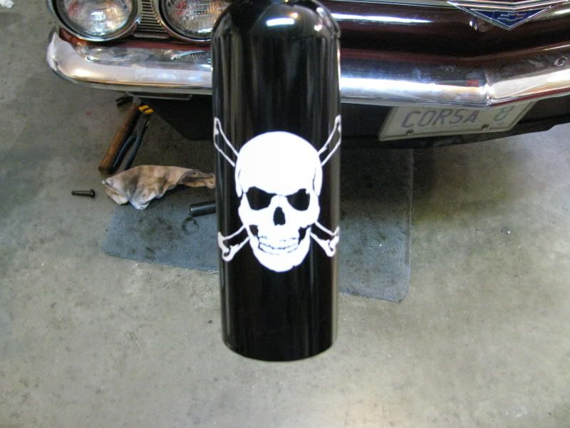

Old Navy stainless water bottle with gangster skull and cross bones  $3.65
2  2.5" T-Bolts from Princess auto $4.30
Scrap aluminum
some coolant line and a 90 degree fitting (plastic)

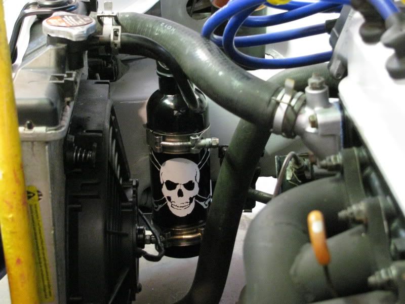

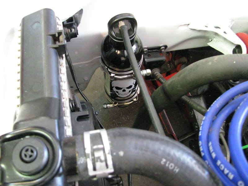

Pretty self explanatory, I couldn't find an overflow in the wreckers that was good enough , and I shaved the engine bay , so no place to bolt one on.  The can has a vent on the side , the line into the top also has a line going down about 3/4 the way of the can
party on for under $10.

How hot can the lid get? Is it vented?
Re: Gangster coolant overflow for under $10
« Reply #2 on: June 13, 2010, 07:49:15 PM »
not sure on the temp , ya it's vented , just can't see it. Bottle is metal so I think it will be fine , as for the cap , the factory honda one is just shitty plastic as well
