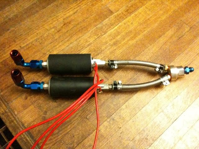

Well F me with rusty log manifold.
I think I found the problem. Started pulling crap out to get ready for the two pump install and under the backseat it looks like over the winter some mice took up residence.  Well for some reason it looks like the little bastrards chewed on the power wire. It is down to about 4 strands in a spot.
I must have had something greasy and tasty on m hands when I put it in I guess.
But second pump is here,  aeroquip fittings are here so might as well stck them both in.
The one walbro I'm running now is probably as old as some ofthis boards members anyways. I'm
sure it won't mind the help.

Got both pump installed, new wire everywhere. Fuel pressure is perfect now.
Have lots of work todo on the fuel map though. Was rich off the scale past 15# of boost.  But have gotten it much closer on just a few runs.  Amazing how much easier tuning is when the car runs te same tme after time.
Even ran it on each pump indvidually and all seemed fine.
Atleast I don't have a bunch of money in my worthless upgade. Kept. Rhmt as much as possible

ON a side note, would it be safe to say that if i use 10 or 8 guage wire for my amplifie ( from battery)r in my trunk I can use that wire to power my fuel pump as well? THen ground at the body or block?
Thing is, the wiring on my fuel pump isnt anywhere near that size on the walbro if memory serves correct, im just not sure when the old shitty 20 year old wiring is still good or up to the task of 300.  Especially to ensure its got reliable amperage.
The wire in the picture is 10 gauge and what is recommended to be used.
My battery is in the back about 12" from the pump so I went to the battery for ground,  I have a fat wire coming from my alt. to the exterior kill switch so I got the power from right there.
Also went ahead and added another big ground strap from the motor to the frame.
