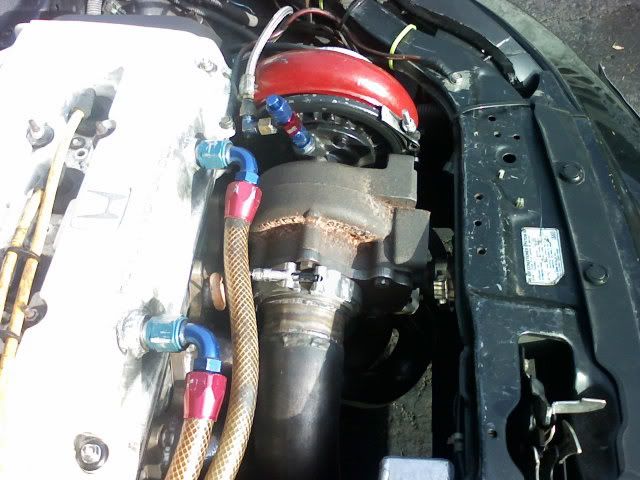

« Reply #24 on: June 25, 2010, 06:09:27 PM »
I run -6 straight from engine to h1c and got no fuckin problems at all
