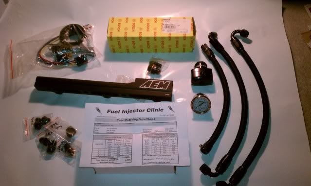

Got all my fuel system together so all my fuel concerns are now over.

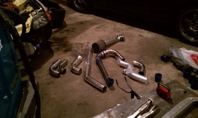

2-5-2011

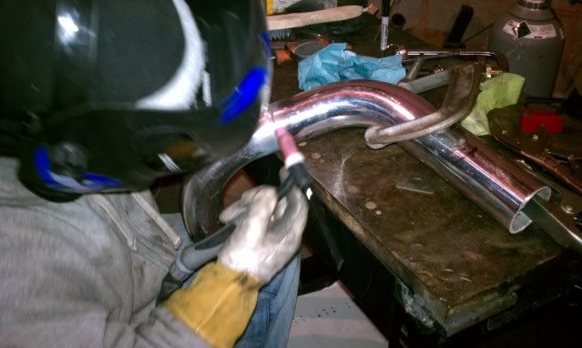

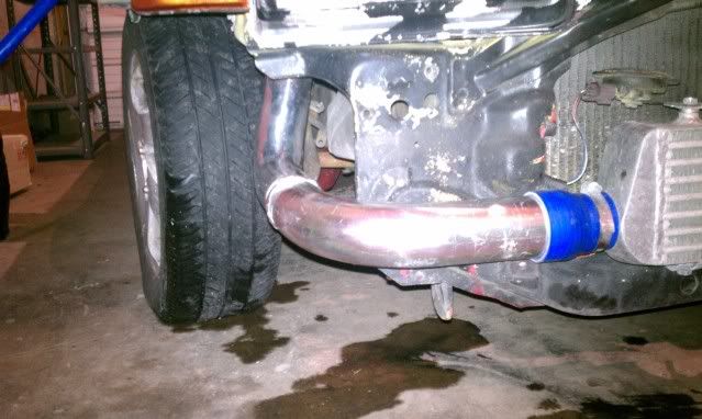

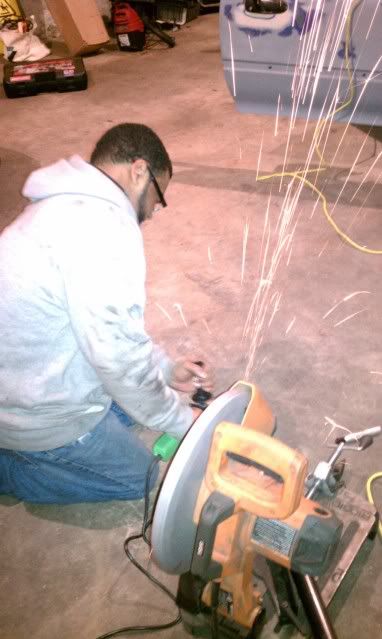

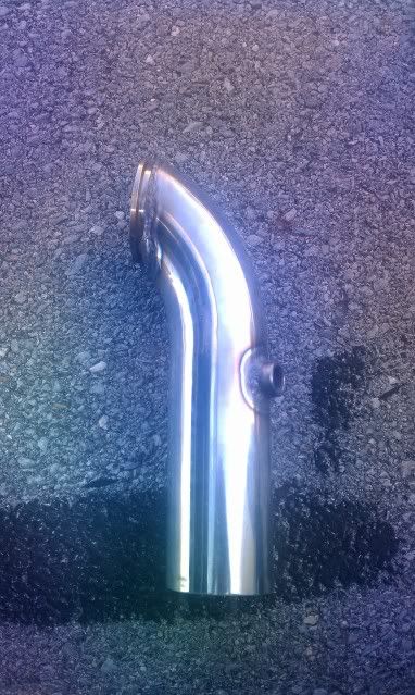

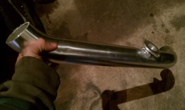

Got most of the intercooler piping fabbed up with help from my friend/tuner/welder.

Oh.. the priority mail box is all my fuel components... except for the fuel rail. Thats in the other little white box next to it.

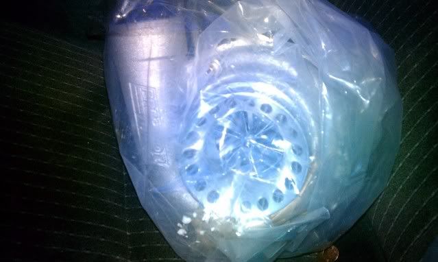

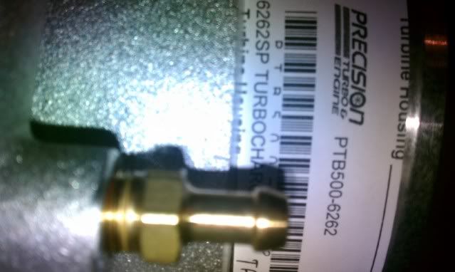

Turbo still isn't on but hope to change that this weekend. I bought a ebay turbo, sold it and bought a used SC61, found out the SC61 was garbage, now have a new SC6262SP with .82 AR vband. Ordered a atp flange that allows for a 3" pipe to be slip on(should be here thursday).
Other things installed: dual core aluminum rad, slim fan, bosch 044. All intercooler piping is 2.5" also wastegate is at around 11-12psi so should be fun once everything goes on. Still debating raising the boost since its my DD, stock jdm b18c... so 10.6:1 compression w/ arphead studs. E85 all day and I know I won't be running out of fuel.
6-8-2011
Here's some pics

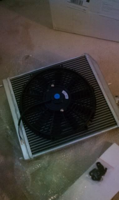

EBAY Rad and slim fan

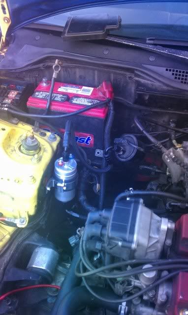

044 installed I had the hoses backwards but they are fixed.

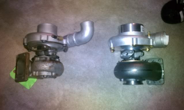

Precision SC6262SP .82ar with vband out

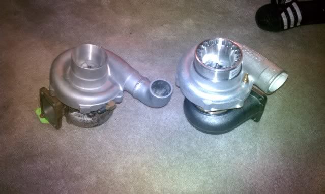

Comparison between SC6152E .63ar vs. SC6262SP .82ar

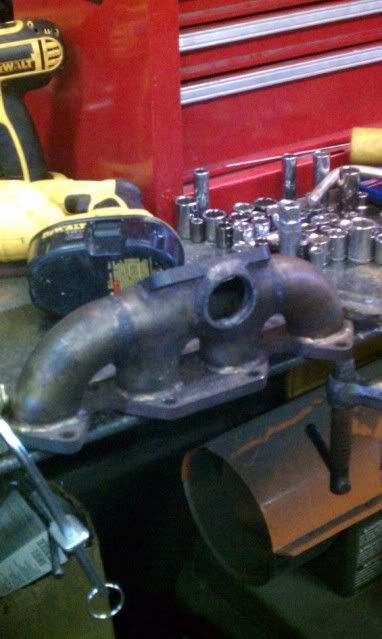

6-13-2011
Some wack ass updates
 Some pics/updates

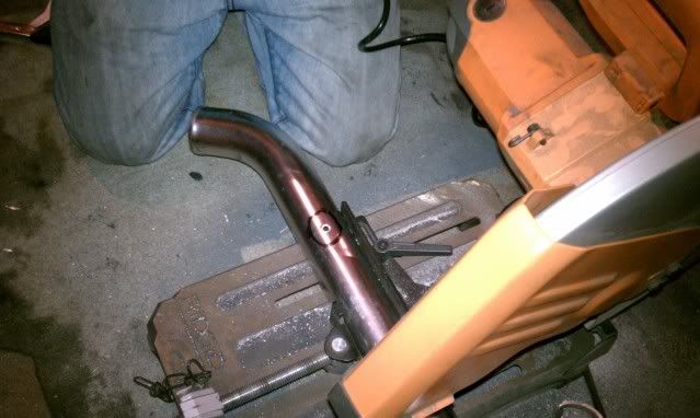

Wastegate needed moved.
Some clearance issues...
Fits now

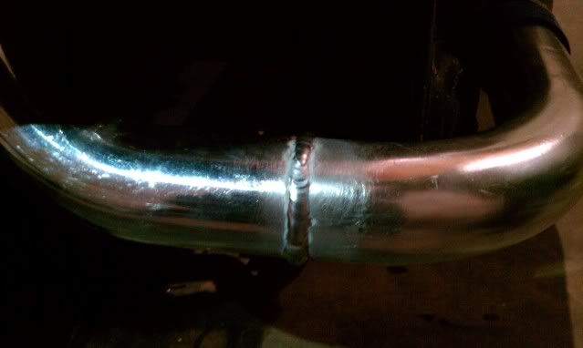

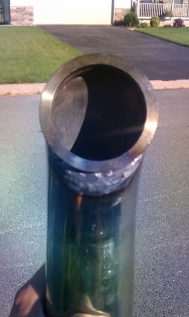

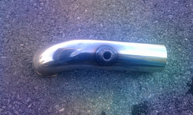

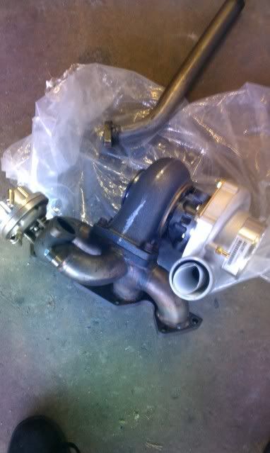

Shorty Straight Downpipe(angle made for a gap which needed filled) couple pics

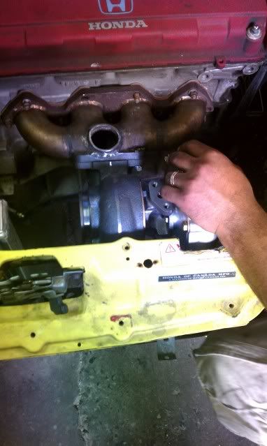

Shorty downpipe on and its a tight fit
What my friend thinks..he has a AFI top mounted sohc. The joke of the day was the placement of the turbo.

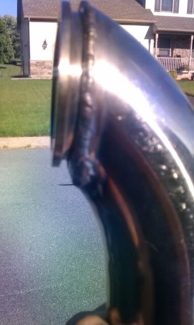

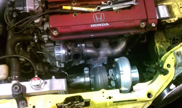

6-17-2011
Turbo kit is on and downpipe was made. Left short after without a tune and drove to NC for the RHMT East Coast meet. Still was running my JRSC E85 map and 550s.
Finished

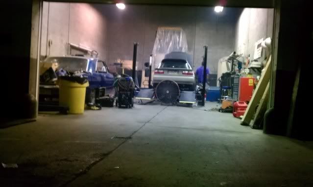

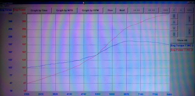

Got the car tuned by my friend on his dyno.
Final numbers from wastegate pressure.  314whp 212wtq @ 8.5psi  The intercooler with its 2.25" inlets are killing me.

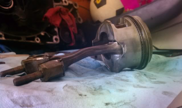

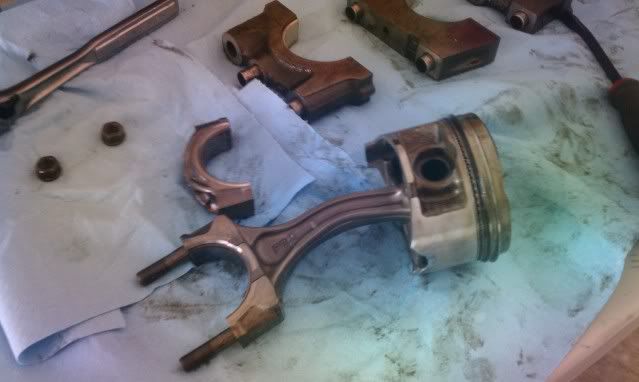

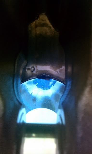

Installed new intercooler and went to get retuned. Drove the car to the dyno and on the lift. When I started the car to pull it on the dyno heard a tapping/knocking noise. Turned off car and we pulled the head to see if I bent a valve... Car bent a rod.

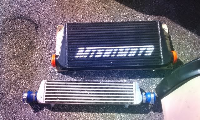

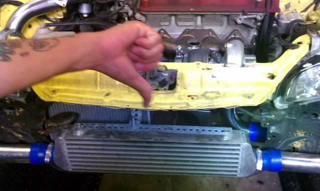

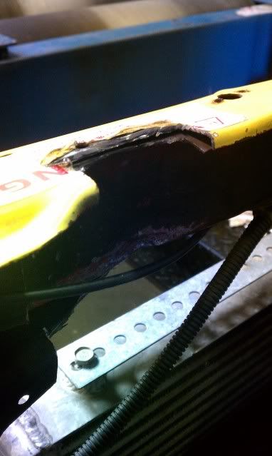

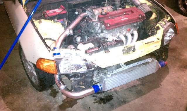

Here is the difference between intercoolers.

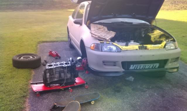

Pic of me pulling the block out. Can see the new intercooler installed

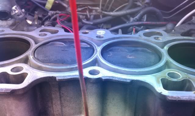

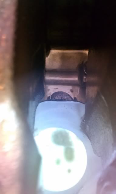

drained the oil and pulled the oil pan off to find some little pieces of metal. Go the block up on a engine stand by myself with flywheel and alternator still on it.

Car has been sitting like this now for 3 months. July wasnt a good month for me. Car bent the rod and then a week later got laid off.
I have picked up another GSR block that was recently bored to 81.5mm and never used, gsr crank, and also some used eagle rods. So slowly the car is being rebuilt while im unemployed. Also got some ACL gsr bearings.
In the next week or two hoping to have the headgasket, new water pump, and misc. seals.
