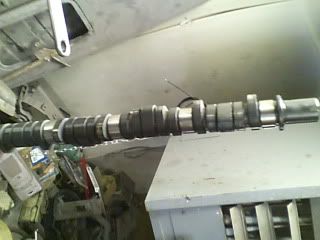

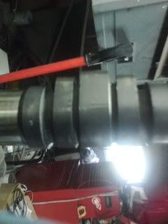

was given a 95% complete Y8 head for doing work on a kids car
he told me it had an aftermarket cam/valve springs in it of unknown brands
best way to spec/check these and try to find out what they are
shitty cell phone pics for basic info

Better pictures, please.
Measure base circle and lobe heights of cam pls.
Re: Y8 cam/spring ?
« Reply #2 on: July 26, 2010, 04:14:13 PM »

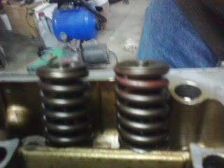

Measure the valve spring free height, coil thickness, and cam lobe profile specs. :?:
For the cam profile specs.
Compare to my thread: http://www.realhomemadeturbo.com/forum/index.php?topic=14562.0
Originally got this info from: http://causeforalarm.thecarthing.com/version6/version6.EG/3-stage_VTEC/index.html
For the stock valve spring info post up and I'll look at my spare parts and compare. ;D

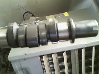

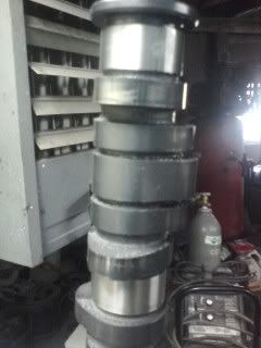

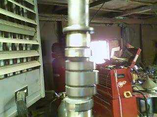

slightly better pics  :?:
measurements that i got
going from top down according to pics
base #s
lobe
#1/5= 1.365
#2/4= 1.223
#3= 1.236
lobe measurements at max height
1=1.585
2=1.410
3=1.517
4=1.402
5=1.585
unable to get spring dia/height till i get my hands on a compressor

max height numbers are all wrong

« Reply #5 on: July 26, 2010, 06:52:37 PM »
thanks for catching my fuck up bone  :-*
corrected spec posting

You dont need a compressor to get the springs out. 1/2 inch long extension+heavy hammer. Couple good hits spring will come loose.
Re: Y8 cam/spring ?
« Reply #7 on: July 26, 2010, 07:24:31 PM »
Chris is right. I only needed a compressor to install new ones.

                                                                              your cam measurements
D16Y8 (stock)      Cam Lobe Heights   mm        in              in
                           Primary              36.778   1.4479        1.410
                                Mid              38.274   1.5068        1.517
                         Secondary           37.065   1.4592        1.402
                          Exhaust             38.008   1.4964        1.585
Looks like stock or worn stock depending on your measurements. :-\

that cam looks like a new billet I thought stock sohc vtec cams were lobes pressed onto a solid rod.

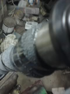

another thing that made me think it was an aftermarket is the fact of the sides of the cam lobes are rough not smooth and its the first one ive seen like that  ???
Re: Y8 cam/spring ?
« Reply #14 on: July 27, 2010, 05:34:24 PM »
All of my z6 and y8 cams have little rough edges.
My z7 cam looks a little bit bigger and smoother. ;D
