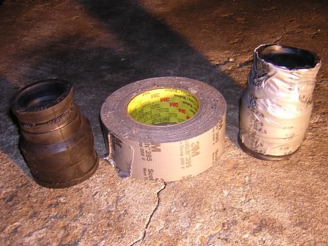

So I needed a reducing coupler to connect my turbo to the charge piping and I didn't have one in silicone.  I went out and grabbed one of those bad ass rubber reducers for PVC from the local hardware store.  It fit ok, but had a lot of problems staying on and after a few weeks developed some rips and tears.
Long story short: three busted couplers later I finally went ahead and ordered a reinforced silicone one, but in the mean time I still need boost.
So from left to right you have steps one to three in reinforcing your awesome PVC coupler.
1.  Buy a rubber PVC coupler and use it until it rips.  Do this three times.
2.  Duct tape.
3.  Wrap the shit out of the busted coupler and cover up all the holes.  Install on vehicle and apply boost.

1 day, so far so good, hopefully the silicone will be here in a week.  Can't be any worse than it was without the duct tape.

What you do is, if it's a straight coupler, you just wrap some thing sheet metal around it and then clamp that bitch. Then when the rubber gets hot and expands like a balloon, the metal supports it and it doesn't pop.  :somb:

update:  it lasted about three days before the duct tape ripped through and started leaking a small amount of boost.  Got the silicone reducer installed today anyhow.

Why not just use a section of sheet metal? Make it a bit wider than the coupler, wrap, then make sure you bend/crimp the ends so the clamp doesn't slide off. It would be best to use aluminum so the clamp bends it right. You may have seen the "no hub" couplers with the metal sheeth around them at homeboy depot.
