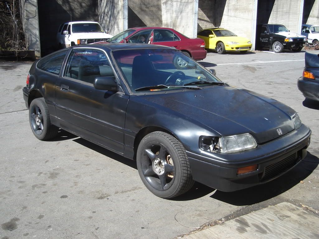

This forum needs content so heres' some good ol' HMT action with the one true chassis, the CRX.

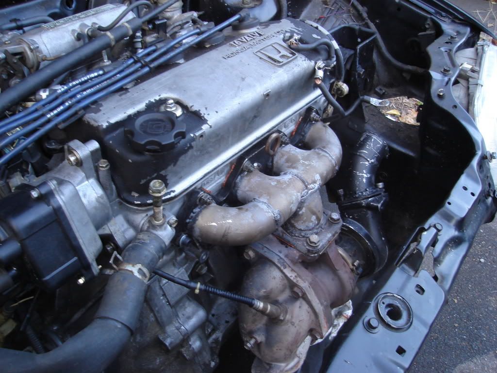

89 honda CRX, d16a6, arp head studs, otherwise stock.

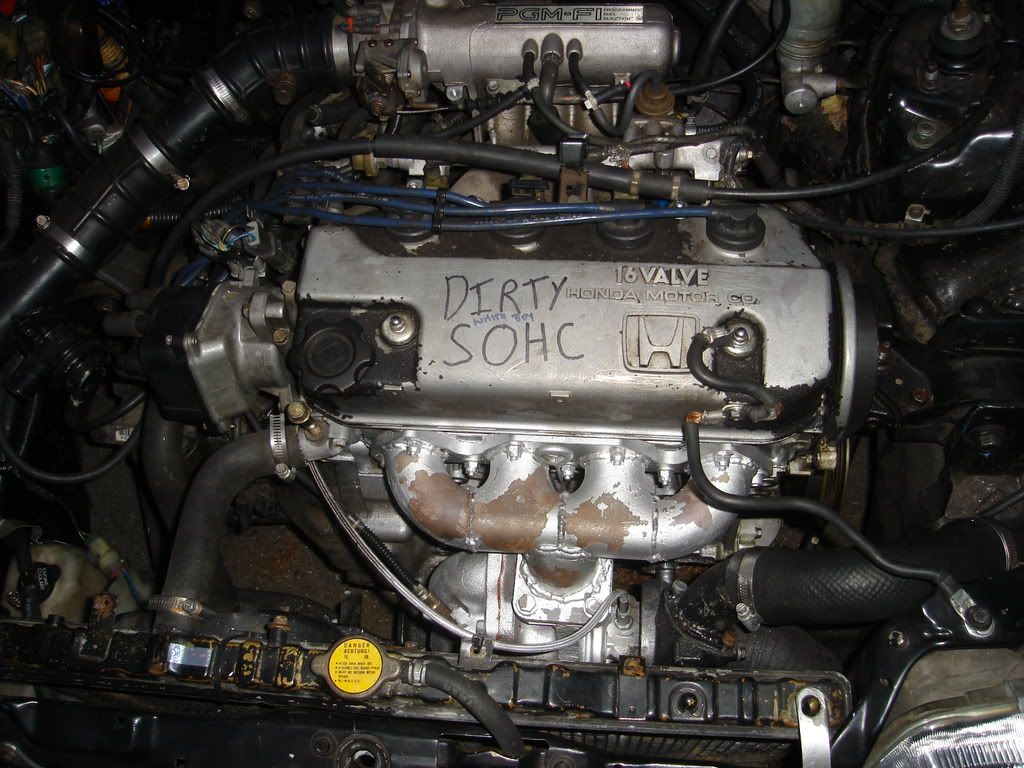

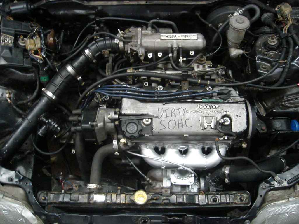

Custom log manifold, dsm flanged, slotted the holes to fit a B or D series.
14b turbo
p75 obd1 conversion
dsm 450's
dsm bov

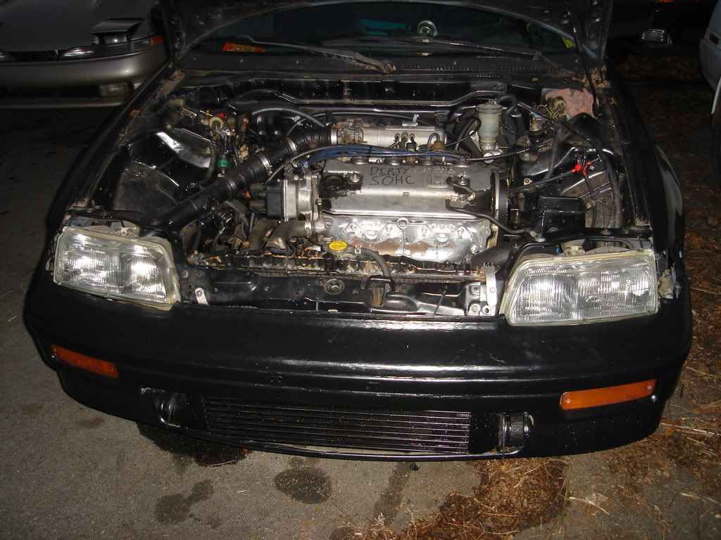

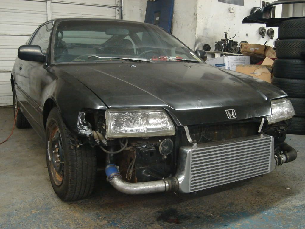

ebay front mount

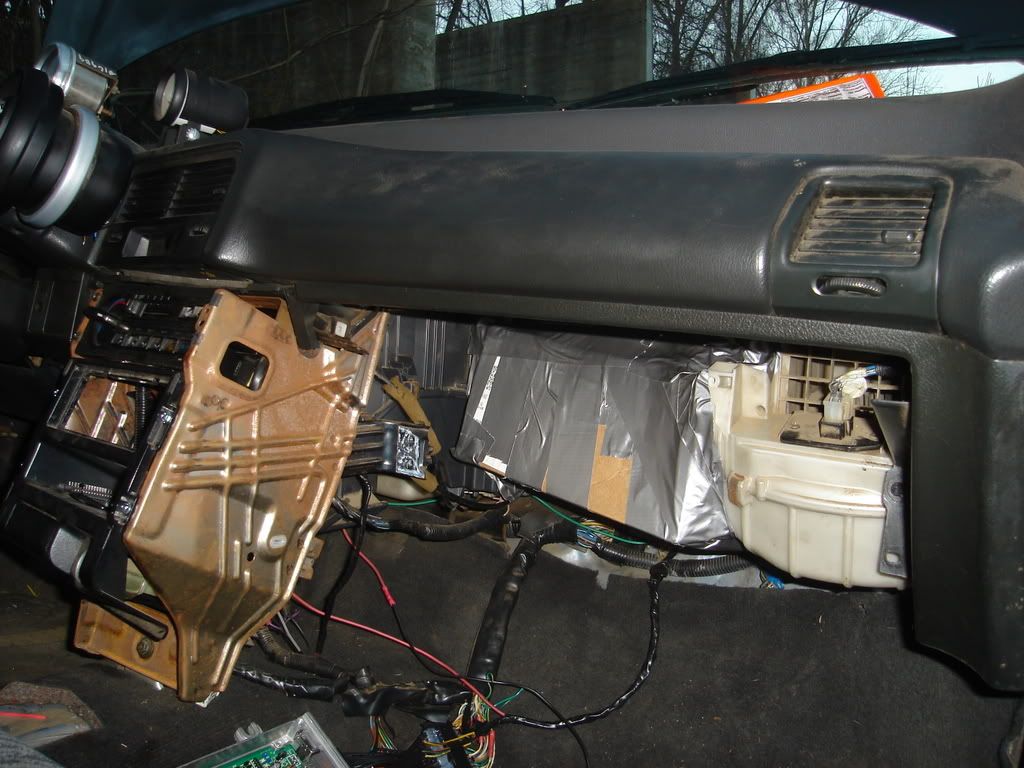

Ghettofab hardcore cardboard/ductape airbox.

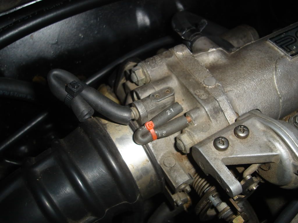

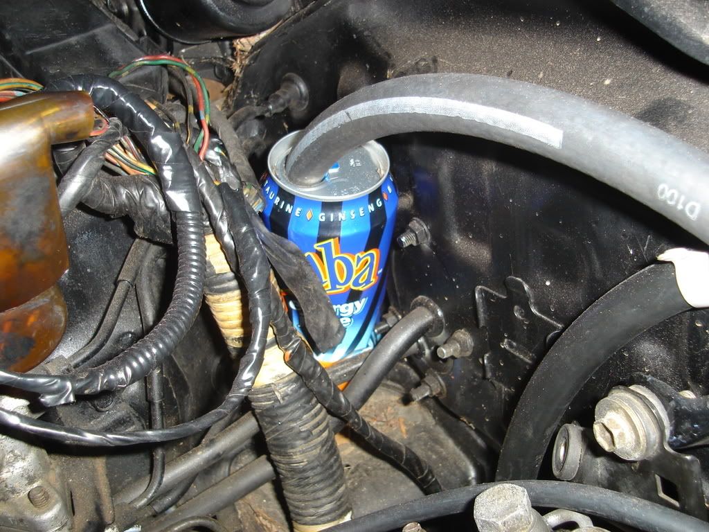

Fuck paying $$$ for vacuum caps

Vacuum caps = small bolts w/ jb weld to hold em in for me  ;) super strong zip ties probably work too though lol

I actually built the manifold for my old integra, vids here:
Stage 2 Srt 4 vs. Acura Integra Ls Turbo pt1
Stage 2 Srt 4 vs. Acura Integra Ls Turbo pt2
I sold the teg, and didnt feel like making a new manifold, so I slotted the holes and slapped it on the Dirty Sohc lol.

how much work was it to get that manifold to fit and how well does everything line up?
Re: My old crx-ness and other stuff.
« Reply #8 on: March 08, 2009, 09:37:53 PM »
About an hour's worth of work with a small carbide bit and die grinder.  VERY close actually.  The 2nd and 3rd cylinders need a bit of grinding but slotting the holes is the big part. Get a gasket for whatever engine you want to put it on and you'll see.
