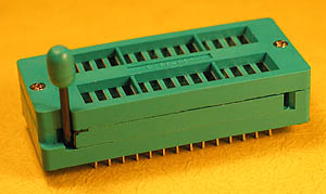

great! and Futurlec send stuff to europe. just they havent 27SF512 and Aries S4,i was wondering if this zif should works too ..
28 pin of course. and if 27SF512 chips will fits on it.

Fuck a ZIF, get machine pin sockets and reap their eternal reliability.  Best of all, you can buy them from a company called ASSMANN.   :)

i assume not use ZIF if you runs with ostrich or something like that, but if you runs without one and need remove chip all the time, using zif is easiest..
Re: digikey part number list for obd1 vtec chipping kits
« Reply #34 on: May 06, 2009, 10:49:28 AM »
Not when the ZIF falls apart.  They are pretty fragile.
