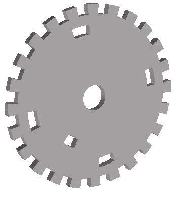

The easy/dirty way to run the P28 on the 4AGE would be to waterjet a 24x/4x/1x cam trigger wheel, read it with hall sensors wired directly to IC10. I've got a wheel drawn up with the intent of going that direction with the 3SGTE installs. 3x allegro micro hall geertooth sensors would do the job for under $30.

here's the cam wheel i drew up:
www.apexology.com/files/schematics/camwheel2.DXF
get it cut in 1/8" thick 1018 steel.
big blue saw waterjetting service quoted them at $10.50ea for 10 of them. it would just bolt to the face of the cam gear (pretty sure it'll clear adjustment screws for adjustable gears). single beam with 3 sensors inline would be necessary to read it. allegro micro ATS675 were the sensors i was looking at.

you wouldn't be able to use the honda sensors because the wheel is designed to be read from the face, not the edge. my plan is 3 hall effect ICs implanted into a beam that goes across the face of the wheel. set the beam to pivot at the center with a second fixation point and you could even be able to adjust timing without having to stop the engine, loosen the cam bolt and turn the wheel slightly.

So the beam would just be aluminum with some holes for the sensors to sit in.  Would the honda ecu read these 3 hall sensors normally without any weird pots to tweak?
I can't see your wheel but it must go like this.  Its a wheel with 3 rings of "teeth" cut into it for the sensors to read, right?  The sensors sitting on the beam would just sit over the rings they are searching for.  Each ring will have the correct number of holes and spacing to give the oem ecu the proper readings.

link just had an extra period in it. it's not an image, it's a DXF file for CAD software. you'd need to download the file and open it with something like autocad or solidworks.
here's what the wheel looks like:

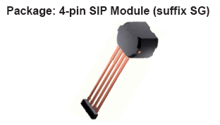

the sensors look like this:
the sensors would be wired to the output side of IC10, bypassing the HIC1 signal conditioning board entirely.  they're about a 10mm circle with the top and bottom flattened. i believe the spacing on the "teeth" on the wheel is 16mm center to center, so the beam would just be 3 sensors in a row (orientation matters) with the centers 16mm apart.

On the Ic10, is that a portion of the honda board that receives the ignition signals from the halls sensors? Excuse my ignorance, im not familiar with honda ecus.  Why do you have to bypass the conditioning units?  Are there 3 inputs on the ic10, 1 for each hall sensor?
Also What size is the center bore on your Cad file.
Those look very flimsy and breakable, how do you plan to house them? The leads on them are just that, leads.
« Last Edit: August 23, 2010, 06:53:25 PM by TTC »

IC10 buffers/inverts the outputs of the HIC1 board. HIC1 converts the analog VR sensor (in the distributor) signals to digital. the HIC1 board cannot read digital signals because the input voltage must pass below ground to trigger the board. IC10 is on the output side of that board and merely inverts the signal. since the signal we'd be generating is already "inverted" so to speak, there's no need for IC10 to invert it, so we connect to the outputs of IC10. there are 3 signals CKP, CYP and TDC.
the power and ground rails of the sensors can be tied together provided the proper bypass capacitors (1.0 and 0.1uF should be sufficient) are used. i would recommend running a separate 5v regulator dedicated specifically to the hall sensors, rather than trying to pull from the ECU's sensor 5v rail, since these will be switching and generating transient voltages and jitter that you wouldn't want present on the analog sensor rail. probably just me being anal though.
the sensors would be affixed to the aforementioned beam with some form of adhesive. the leads would be wired together and then potted to the beam with silicone or urethane to stress relieve the component leads and waterproof the assembly.

So basically, you would have power, ground and 3 signal wires going to your aluminum beam.  The caps are just to limit noise iirc?, and you just put those inline within the power and ground wires? Or do you put them, between its been a while and I forget simple electronics.  Where would u get a 5v power supply, and how do you decrease the voltage? Again, these are probably basic questions lol.

caps go parallel to the circuit. essentially, they absorb voltage spikes and provide power on voltage dips to keep voltage level. install between power and ground.
power source would be an external LM7805 voltage regulator connected between 12v and ground. you can get them at radioshack, along with the capacitors. wouldn't be a bad idea to heat sink the Vreg.
