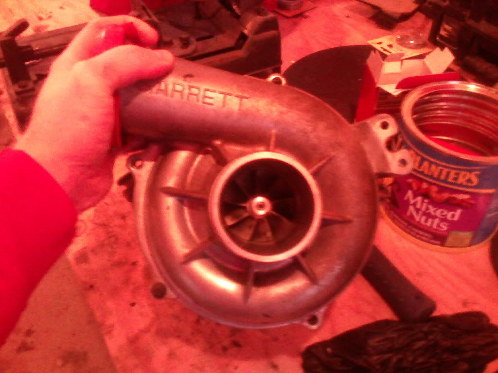

Those odd turbo's that 4cyl guys get like old powerstroke turbos with a WAY to big hot side, are perfect for apps like this, and can normally be found on the cheap. You will be limited by hotside before cold side on an app like this.
Like this?:
Re: SBC 350 turbo selection
« Reply #6 on: August 30, 2010, 01:19:26 PM »
Nope the older one, with the normal T4 exhaust flange.

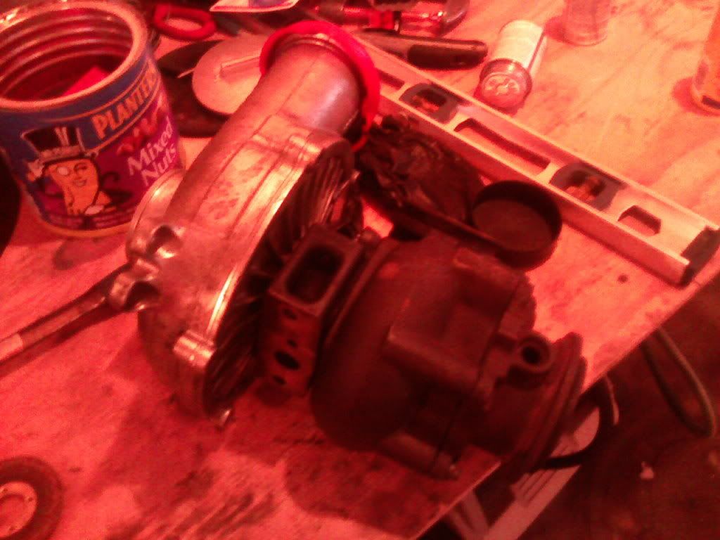

« Reply #7 on: August 30, 2010, 05:41:49 PM »
Like these:
They end up being too small for my D project.
I almost used two of them to do a twin turbo 5.0l mustang but I got hungry and sold all three.  ;D
