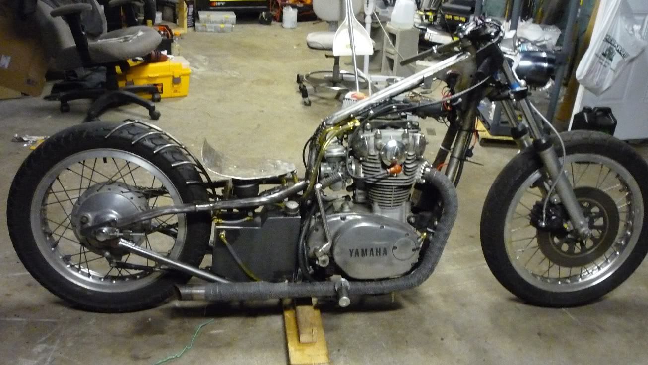

had the bike sitting for probly almost 2yrs started it over a year ago, then i had to remodel a house i bought all winter, finally got it ride-able the last couple months and rode it probly 1st couple days of august for the 1st time and it was awesome. i made alot of one-off parts so it took me a while. also i was half drunk usually on malt liqour for alot of this build,  it was the only way id get anything done

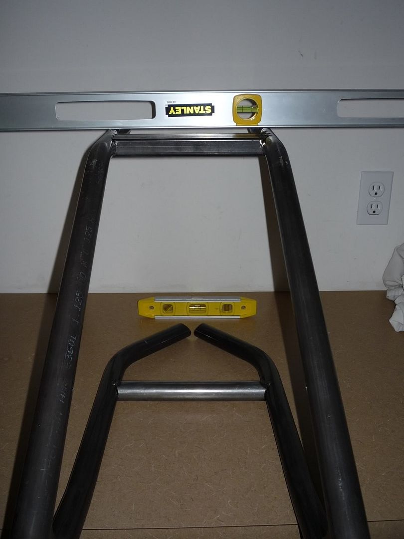

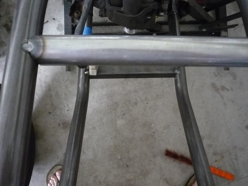

started with a piece of shit (tackd together) drop seat hard tail i got off ebay, only one ive seen at least anyone was stupid enough to use,  came crooked as shit had to bust it up and put it back together best i could with levels and squares, also extended it a few more inches. no idea how much strech it has now, looks like alot
hand made under-seat fuel tank with custom open loop fuel system electric pump and brass manifold
good year air bags for seat springs
35mm clip ons for handlebars i made from spare tube

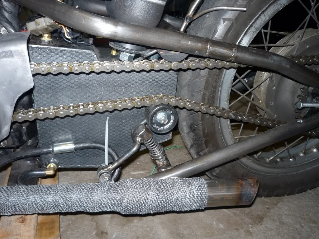

roller skate wheel tensioner (took forever to make) on bottom with a threaded coilover type adjustment and bumper on top
lots of space contraints because of the drop seat and below seat gas tank and airbags .. no tank on the backbone to hide stuff under either. had to mount the battery in front of the engine between the down tubes
its still dont done alot of wires and tubes to clean up
good job K00LKRAFT (id hate to see there race car frames) here u can see how fucked up it was

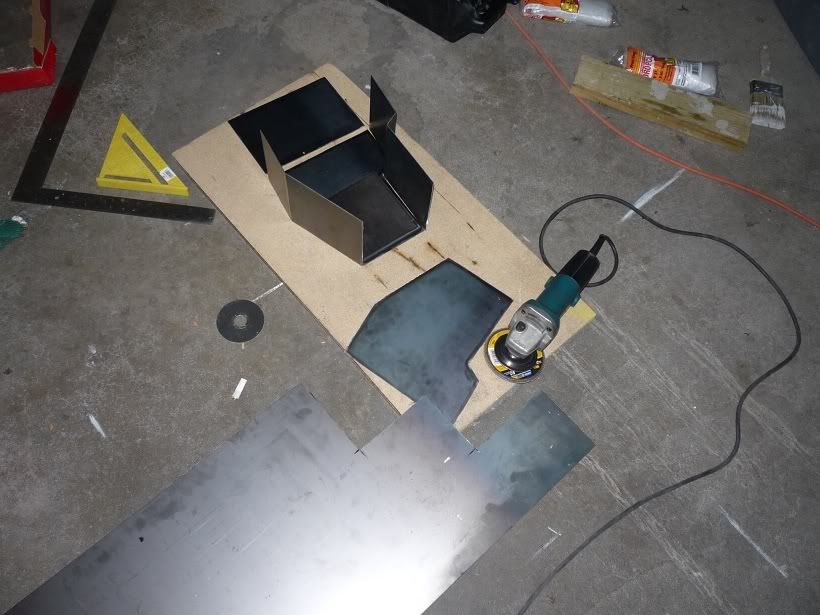

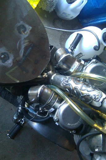

i also decided all bikes seem to have the same lookin tanks and i decided i would mke a tank that used up all the space under the seat, so i made a cardboard template and cut all the pieces out of 16ga sheet using only angle grinder again full of malt liquor
i used a low pressure fuel pump made for carbs and hid it where the electric starterd used to be under the bike.  dont ever buy a mr gasket finline fuel pump, i burned 2 out within a month no idea why, one went out while my friend was on it couple mile from my house
considering i dont remember how i made half the shit or remember much of the welding, and the piece of shit hartail i started with i think it turned out well
the chain tensioner was pretty much nessisary beause of how long the bthe chain was and didnt have alot of rooom to adjust the back wheel, i also made ssome back wheel adjusters that i was obviously not sober and i dont have pictures but they work
basicly bent a rod and welded "cups" that hold the spring

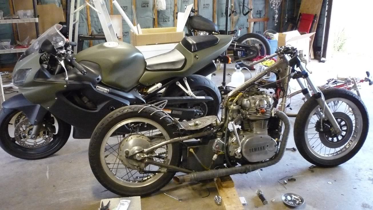

here you can se how low and long it sits compared to the jihad honda

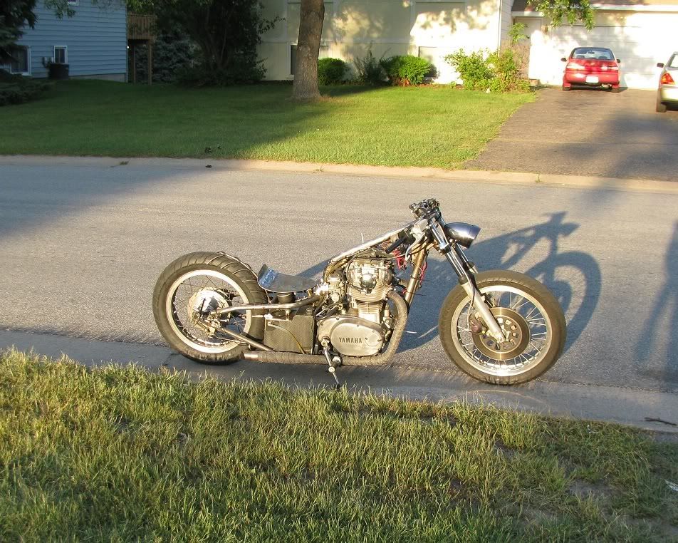

got a new chinko rear tire friend took a pic when i was trying to wreck it
bikes doesnt look like such a mess now i tucked the wires and fuel lines and got a differnt pump that hasnt failed yet

Lol, carb setup looks like it's poised to suck your balls off.

Scroll down for Mikuni crankcase pumps.  The single outlets are PLENTY for 60hp Briggs race motors with fat fuckin carbs.  They push fuel on both the vacuum and positive pressure pulses... they're really cool.  I can watch the fuel pulses pump up the line.  Shipping from them is kind of high, but you get your shit in 2 or 3 days.  I ordered a rebuild kit with mine just so I had one handy.
If you get one of those get a dual outlet... it won't hurt and will give you wiggle room.

i got some electric inline pump i think its a diesel lift pump or some shit but it looks more oem and it sounds like a diaphram type and it was like $35 at my local parts store, i think it will last longer then the piece of shit mr gasket pumps.
and the carbs did actually suck your balls in, or at least your pants, and it caused problems.  so i whipped up some elbows that have been on there for a while

I really like that chain tensioner you made. I'm going to make something similar for my bike.
