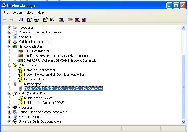

Do me a favor. Go to Start > Right click my computer > Properties > Hardware tab > Click Device Manager > Look for Other Devices (will have yellow ?) and right click on the card > Properties > Details Tab > Look for VEN_XXXX and DEV_XXXX
Tell me what those are.
Re: earn $5, need driver for pcmcia to rs232
« Reply #7 on: September 17, 2010, 02:18:33 AM »
ven_4348
dev_5053
at least i think thats what it is, its listed under the ports (com and lpt) as multifunction device
