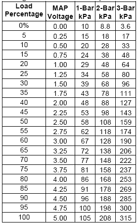

My Idea:
The load scalar is based of map voltage.  Switch out a 2 or 3 bar map sensor and retune the maps accordingly.  Just ignore the pressure shown in the editor, and figure out what each column actually corresponds to.
taken from:http://www.robietherobot.com/storm/mapsensor.htm
Thoughts?  Comments?

« Reply #12 on: October 05, 2010, 10:55:51 AM »
There can be a lot of pressure related corrections in the stock ECU that need to be changed, or aren't accessible to be changed.  It might work great, it might not.  Keep your eyes open.
