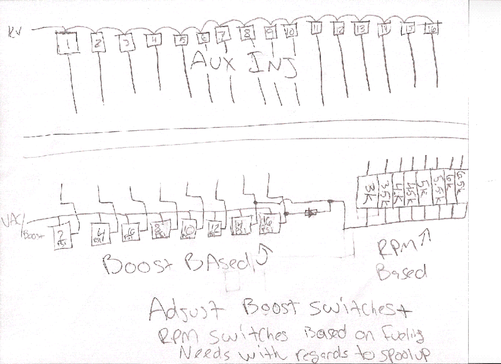

Ok I built a setup similar to this a while back on my civic and i was wondering if you guys could see a way to simplify it a tad but. Basically it was a run down like this
4-5 hobbs switches that are tuned to different boost pressures
2 z6 fuel rails plumbed into the system in the upper IC pipe that run the injectors at 100% duty cycle when the hobbs switches are tripped off thus supplying fuel for both cooling the intake charge and providing enrichment
My question is I had this idea to use a 555 or similar timer IC and a dedicated map sensor to pulse the injectors in reference to boost pressure now I also had the thought to run this setup with cheap rpm dependent switches to effectively give me both pressure and rpm dependent enrichment without effecting timing like an afc would.
I have a question is there a way to make a circuit to pulse injectors once it crosses a certain threshold using a maf that would do away with both rpm and boost pressure and rely solely on what kind of airflow the engine is taking in.

Ok so this is a SUPER ghetto run down of the system. Works like this
You have boost switches(I found that low side 80's gm A/C cut out switches are adjustable from 30psi down to 1psi and there basically free from the JY so I am going to grab a bunch.
Set them to predetermined psi so as the turbo spools it will start turning on injectors how many injectors will depend on your fueling needs as the turbo spools. Reason I am not Rpm dependent at this stage is if your cruising at 3000rpm out of boost the system is not on and flooding your motor. Once you stuff the throttle as boost rolls on it is load dependent.
Once you reach your max psi. the system will continue to work and now it switches on the rpm side of thing where your now tuning off of rpm due to the fact your turbo is no longer making more than X psi but your motor needs additional fueling.
Starting at the rpm where your turbo spools to max psi it automatically kicks on the rpm side of things and here again you tune your fueling needs off rpm rather than boost.
This system allows it to be both load and rpm dependent for cars that were never designed to be boosted.
I am just going to be using JY parts and so far I am thinking you can have a 100% tunable aux fuel system for around say 120$ I also found a diy rpm activated switch diagram that can be made for about 5$ a piece and was planning on running 4 honda fuel rails all shooting at the center of the upper charge pipe with bungs and either brackets or just big hose clamps to hold them in.
Going to be running a whole lot of boost and a whole lot of e85 so yes i presume i will need 16 240cc injectors as the idea i am basing this off of used 2100ccs of meth and still ran out of fuel enrichment up top. this at full capacity will be around 3500ccs of fuel.
Oh and the motor will be a 3.0L 12v 6g72 much the same in the video but i would like to keep it somewhat reliable and not blow a headgasket everytime you go to the track.
Yes I have thought of MS but I see this as easier to tune and get running as its more of a mechanical/electronic fuel enrichment.
What do ya think JD will it work(?) and yes i know its super complicated and might be a bit of a bitch to tune but hey I like being different in a mad scientist way.

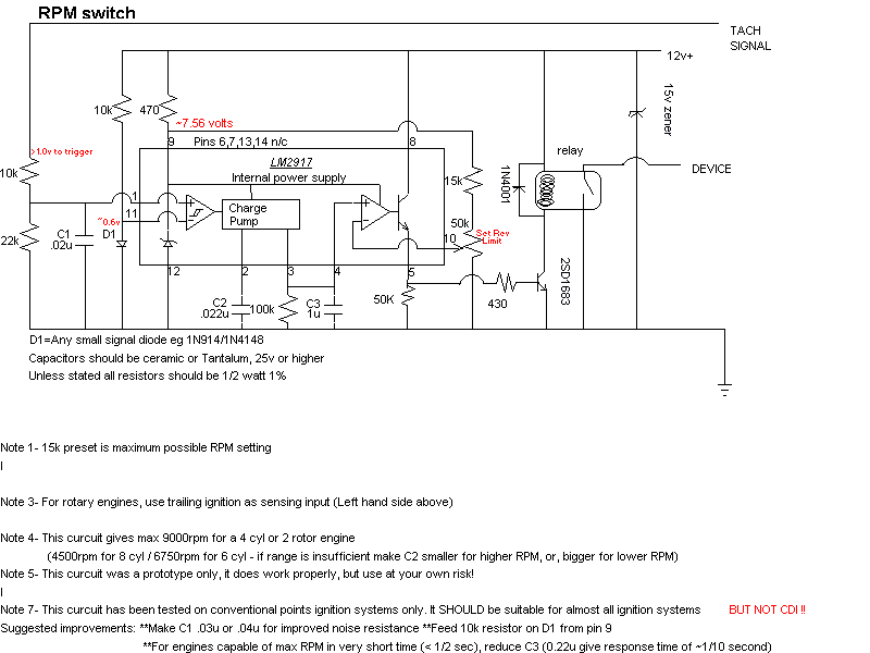

Rpm dependent switch diagram can anyone explain this a little better to me so i can start turning these out gonna need a bunch
