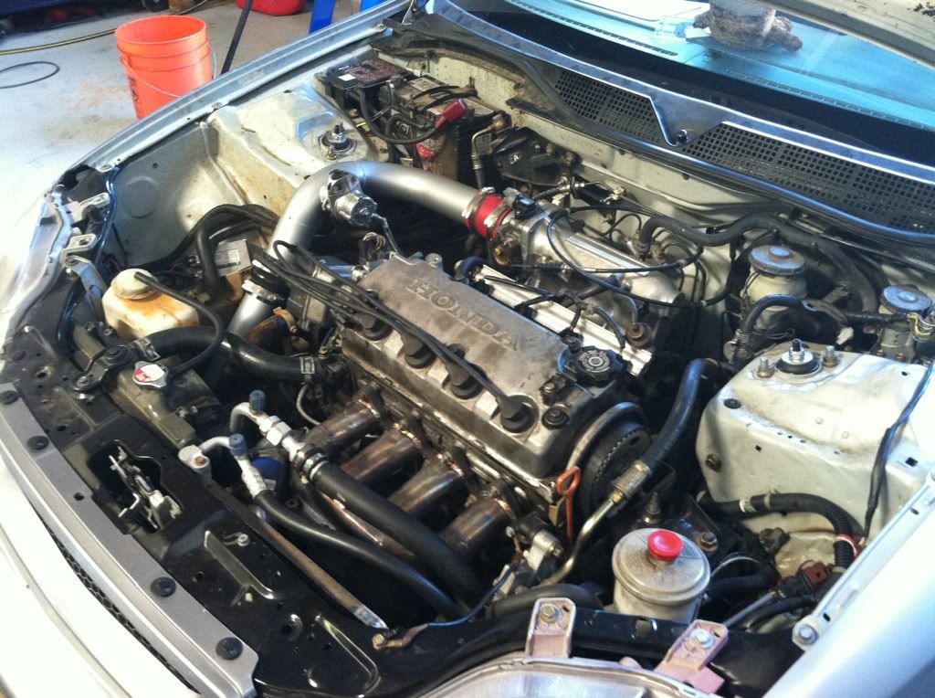

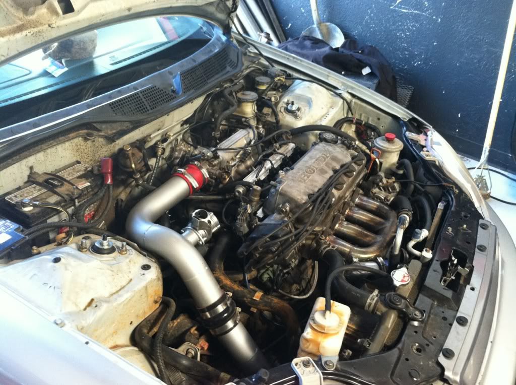

Had 300 bucks so I boosted the bucket
« on: October 19, 2011, 01:38:25 AM »
Basic shit
Threw a z6 head on my y7
Small 16g
eBay intercooler
Some 310cc injectors I had laying around
Raided tuner toys for some back stock he had left over for the charge piping and oil lines
Car has stock exhaust on it and will be putting a dump on it hopefully tomorrow
7psi with the stock y7 tranny, gears retarded long
Somewhat of a ripper

Only way the 16g would clear the slave cylinder and ac compressors in log format

I like the charge pipe routing very nice.

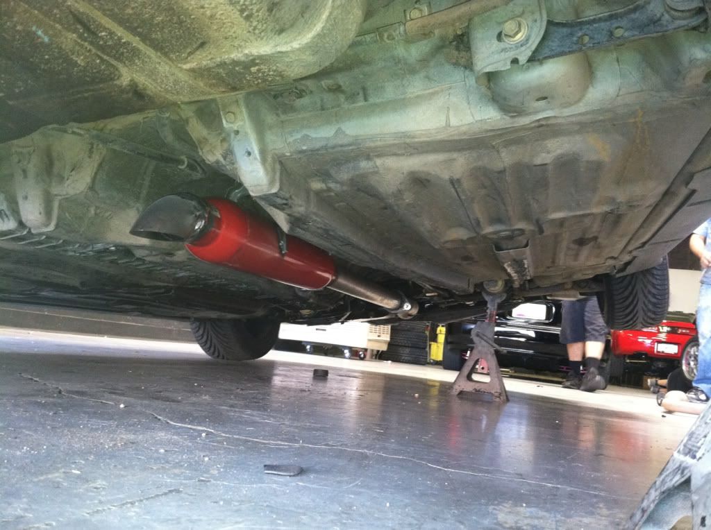

tired of choking on fumes from the open downpipe so friend made a dump for me

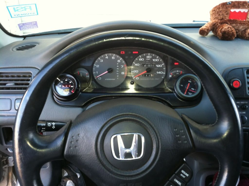

Finally got a boost gauge, put a pod in and a s2k wheel

With the dump holds 8psi now
