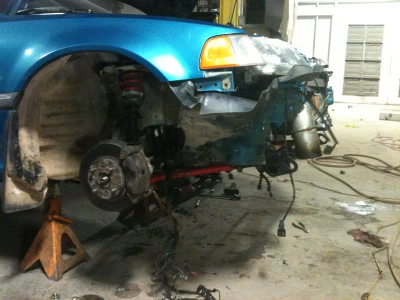

 had a slick blow out in a race at 140....wiped out the nose of the ef
 and found a fucked up frame damage that the previous owner had hid by using a da integra upper control arm and pulling the fender in to match the shoved in door post.
rip hatchie

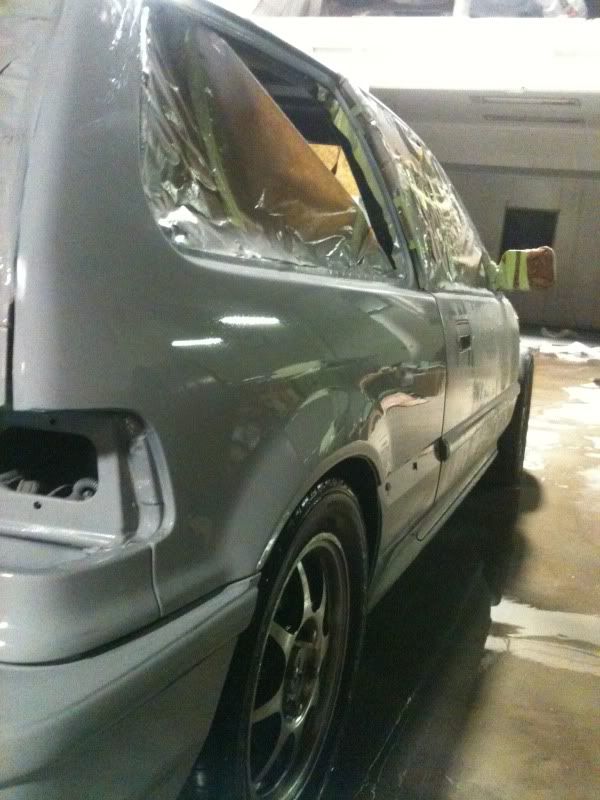

i stripped my grey hatch after a slick blow out  and put it all in a rust free shell that i repainted and restored from ground up.

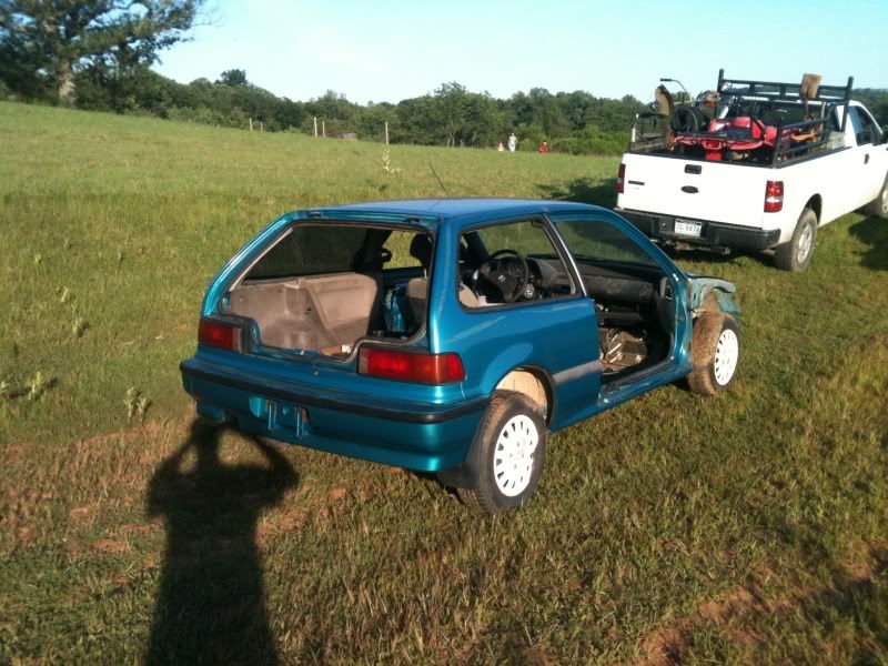

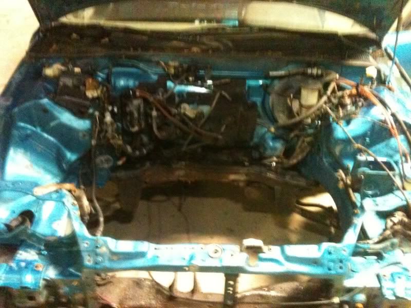

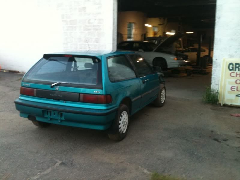

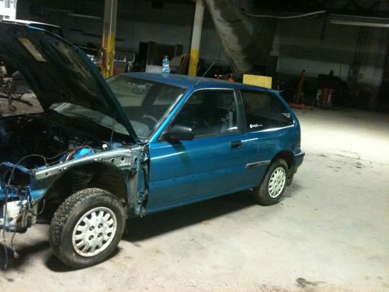

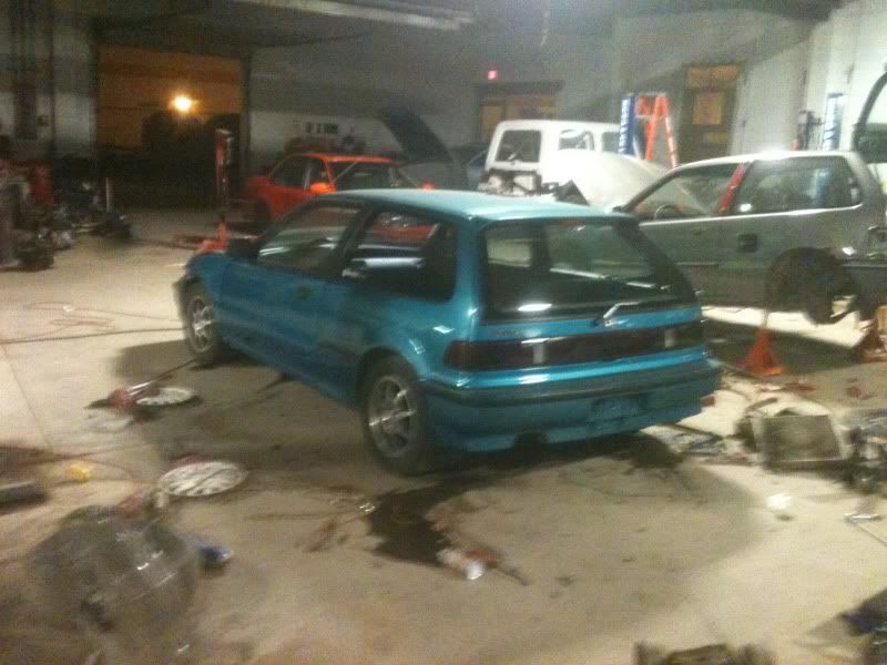

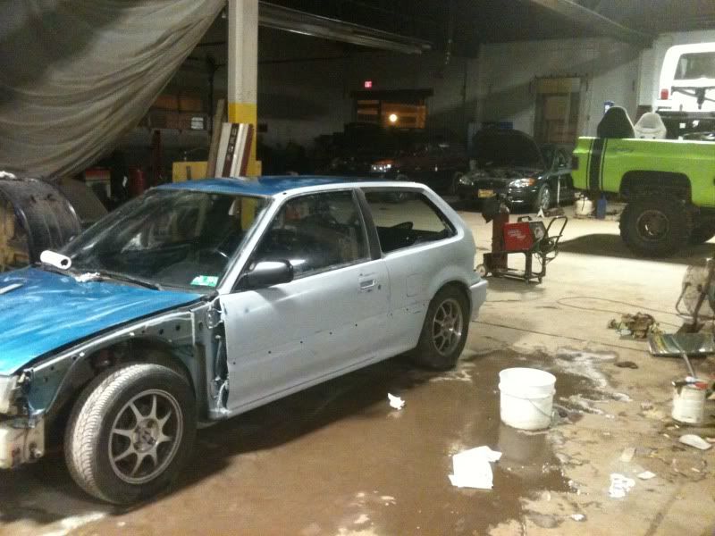

i bought two teal civics from florida, on was totaled in the front. yanked the good parts, stripped the good one and got started. i basically combined the three cars into on nice one.
loading shell bringing it to shop

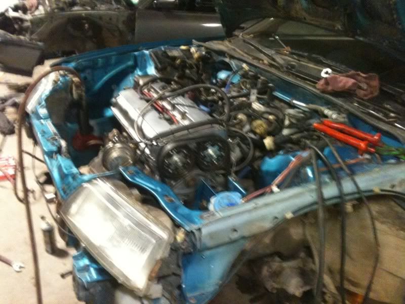

 after i got it to the shop i yanked the dpfi engine and auto tranny out and stripped the interior.
i also pulled the whole body harness out to transfer my old mpfi obd1 converted one in.

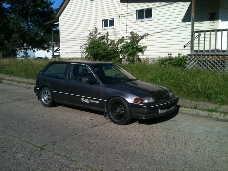

« Reply #4 on: November 28, 2011, 11:07:47 PM »

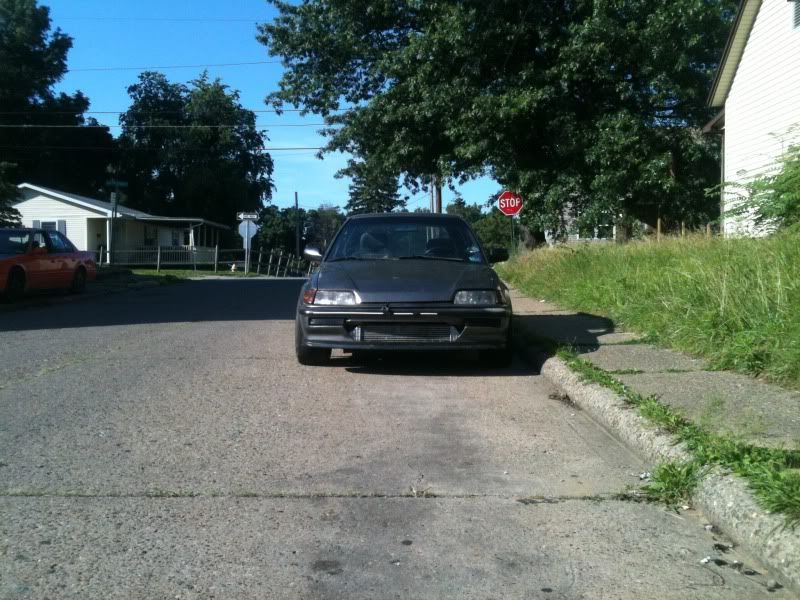

You live in a dump.  Manifest some pride and pick up the fucking trash.

« Reply #6 on: November 28, 2011, 11:09:34 PM »
wtf are you talking about thats not where i live lol

« Reply #7 on: November 28, 2011, 11:11:28 PM »
the shitty yard is my moms house on thanksgiving when i visited, my brother lives there and hes a lazy fuck

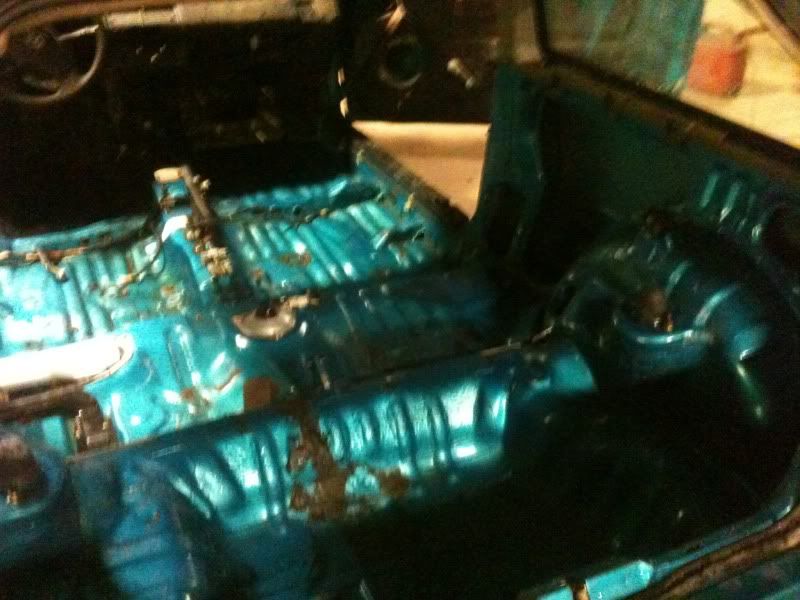

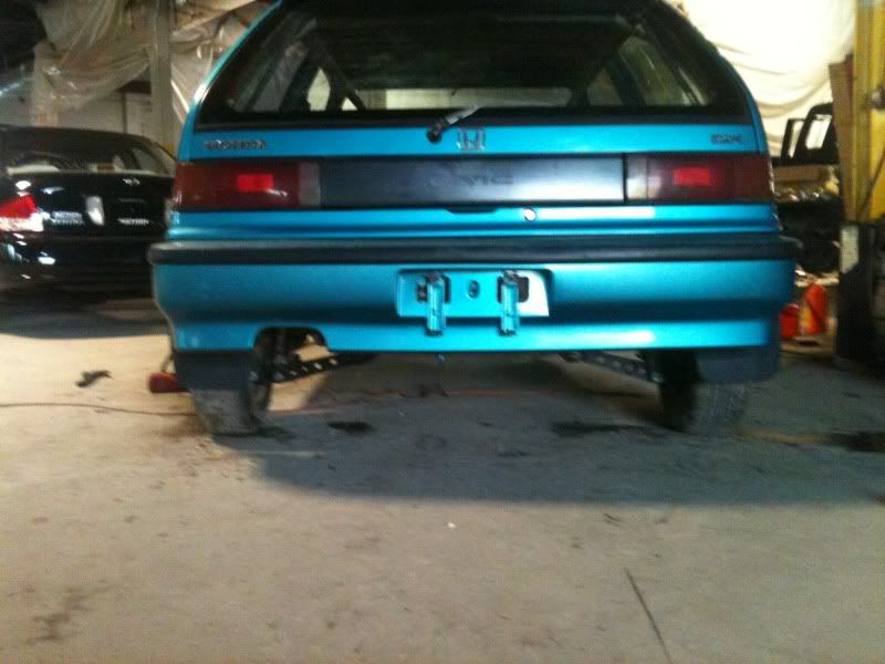

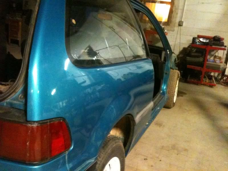

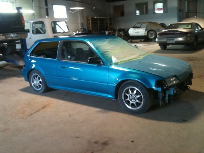

anywho back to the build
nothing like starting with straight rust free quarter panels
i then started test fitting body parts,
grabbed a torch and installed blox rear control arms.
this is how it looked as i rolled it in and out of the shop to work on it in the evenings

Okay, you live at the other place where the lawn hasn't been mowed in five years.  Post some fucking porn, n00b.

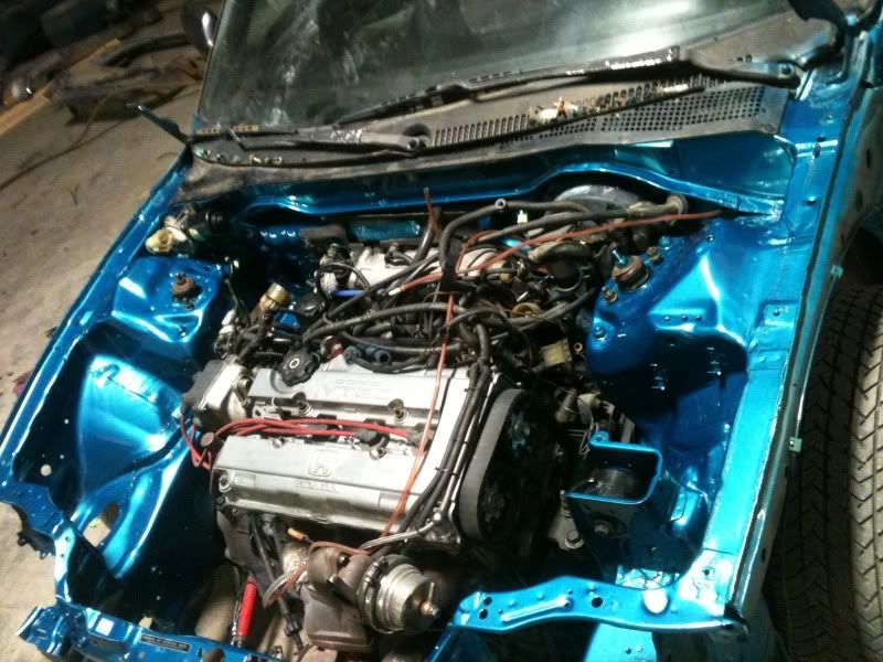

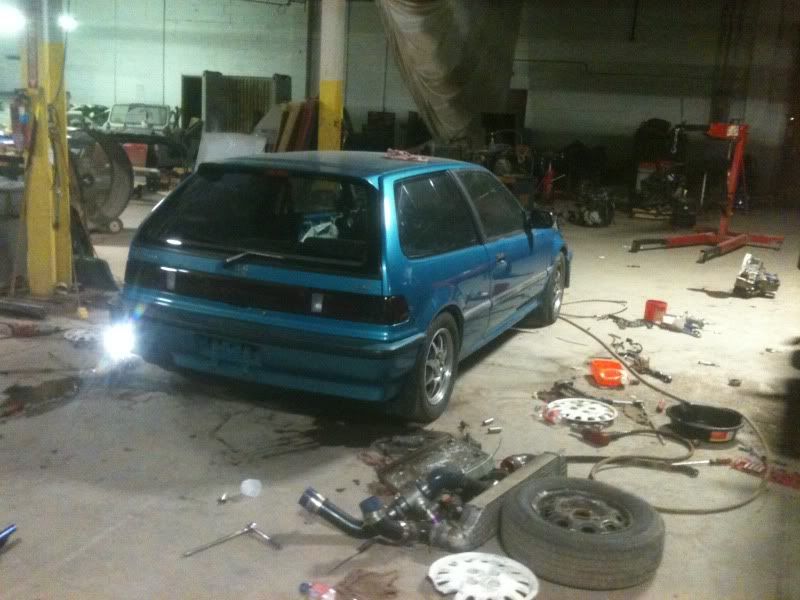

i then started the engine and suspension swap

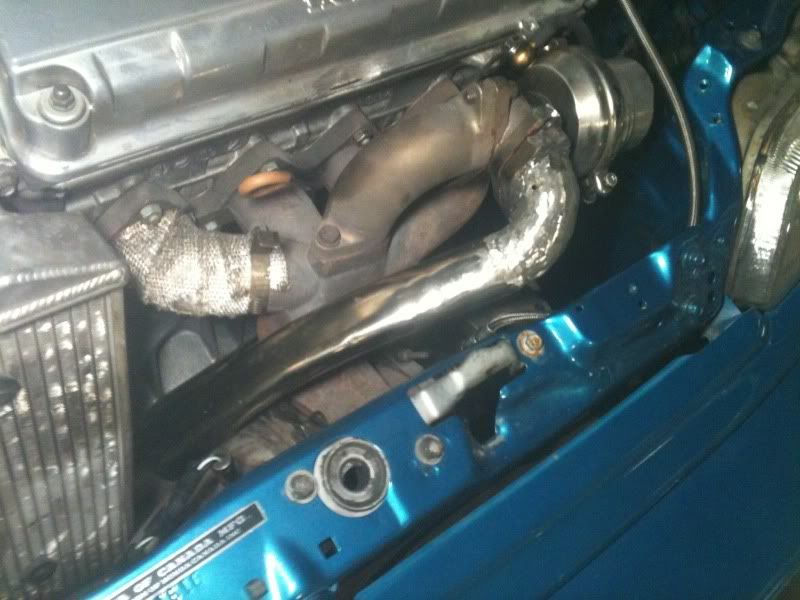

built poor mans type r, precision 780s, holset turbo on 15 psi, 4 inch open downpipe
skunk2 coil over sleeves, rear drag springs, innovative competition traction bars

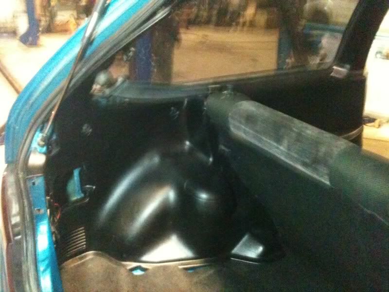

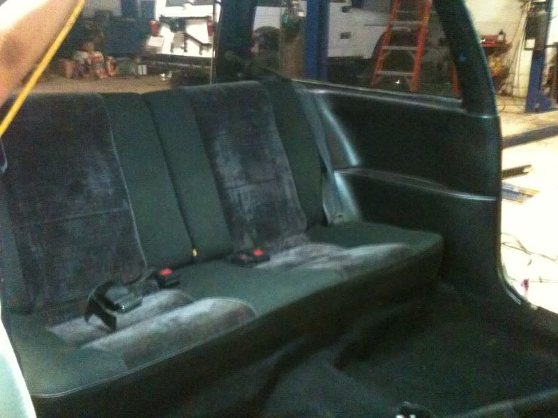

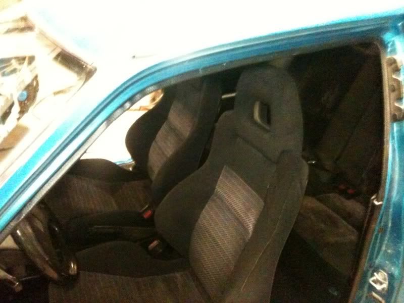

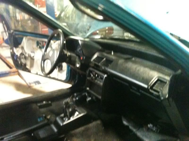

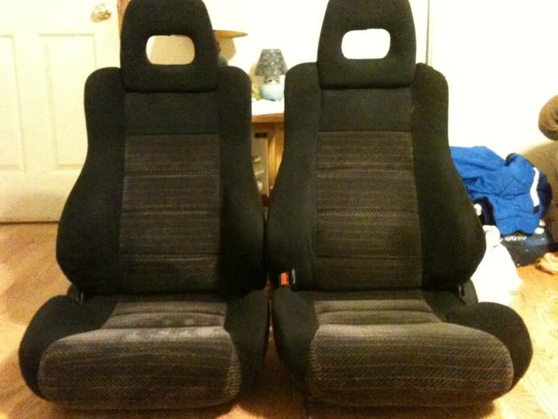

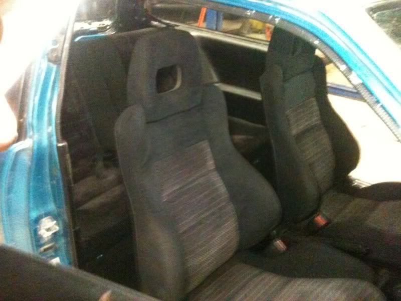

i then started on the interior, redyed doorpanels, carpet, and all interior trim black. wrapped headliner in teal plaid, si rear seat, my front si seats were haggard so i picked up some mint clean crx si seats on craigs list, welded up some brackets and mounted em

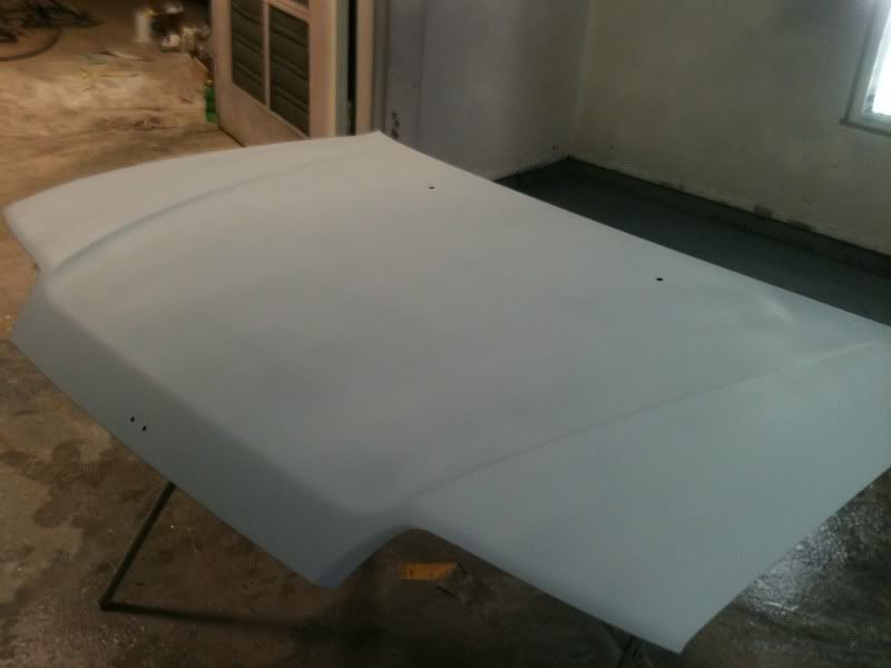

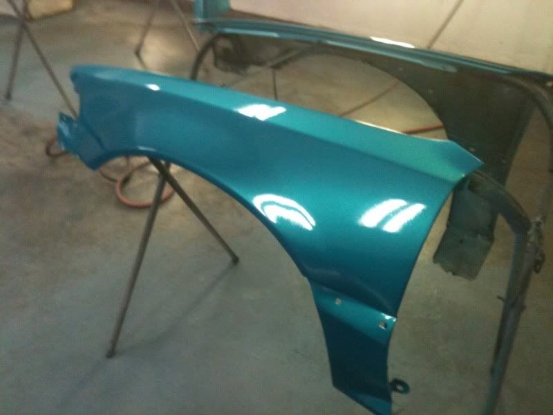

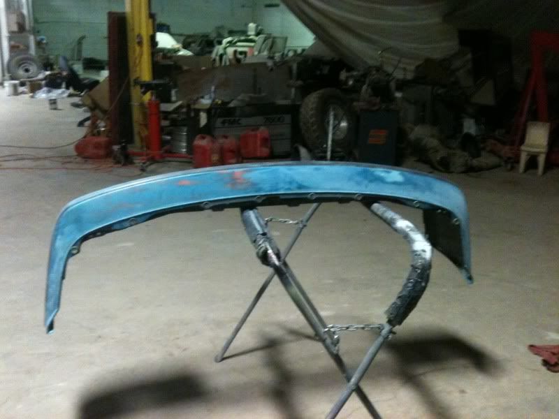

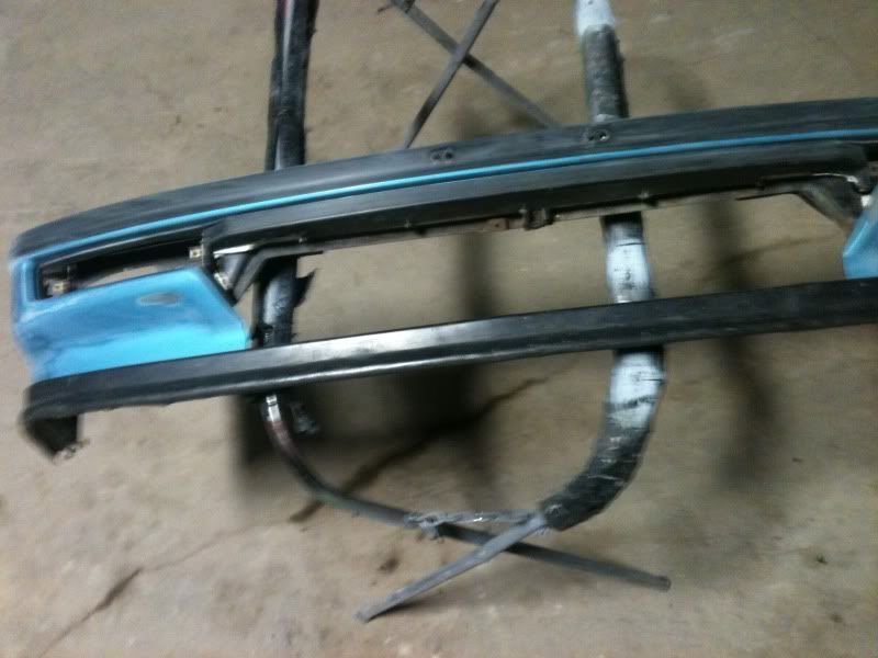

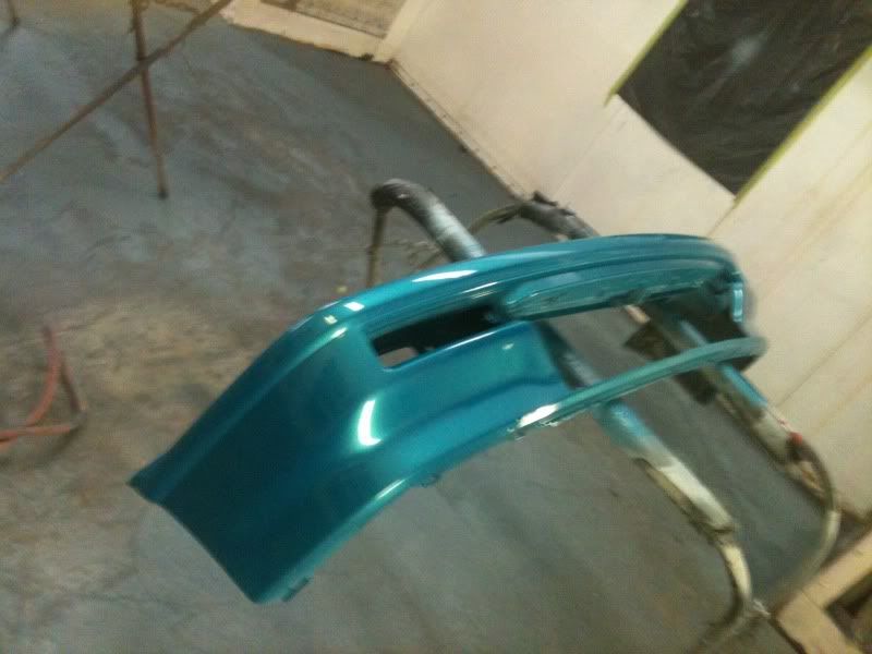

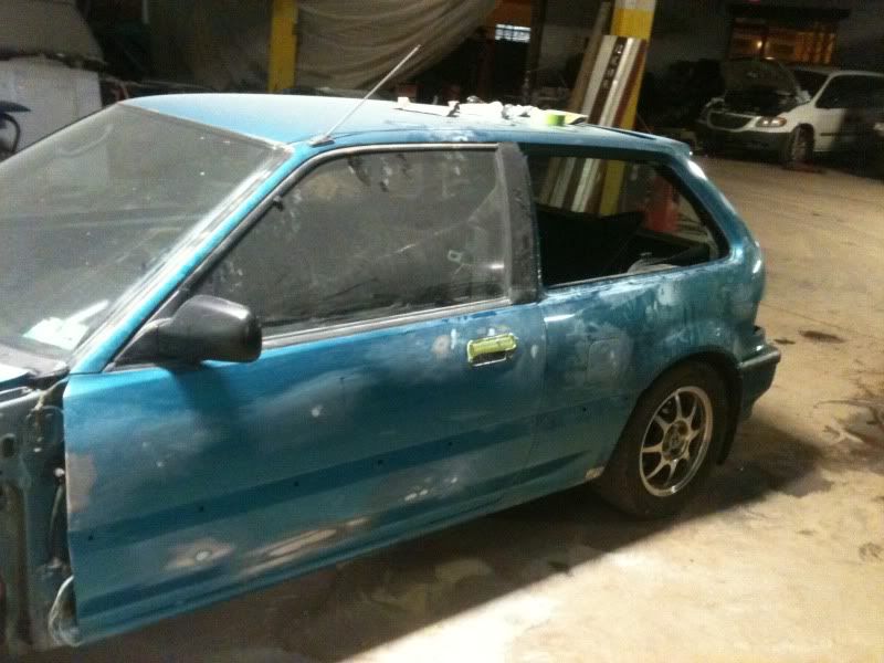

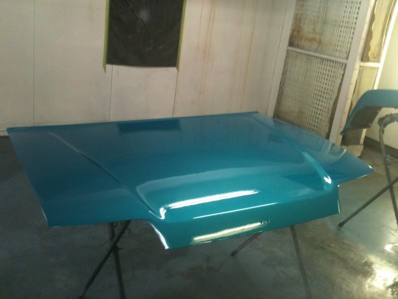

my friends dad had bought a brand new hood for his sedan on craigslist. needless to say he got hosed and it was a hatch hood. since he had no use for it, he sold it to me for 40 bucks.

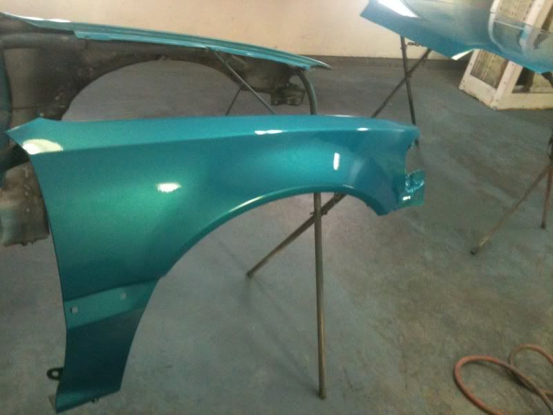

i laid some high build primer on it ,the fenders, and front filler panel after working some dents.
i cut the front bumper for the intercooler and fixed alot of gouges and chips.
crazyassbill
  • Posts: 23
Re: rip ef hatch, time for a new one
« Reply #12 on: November 28, 2011, 11:16:43 PM »

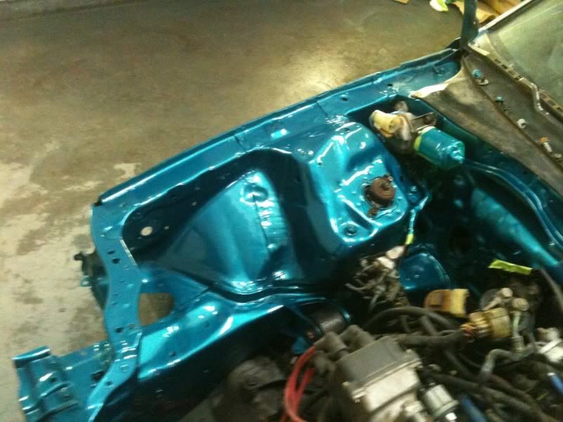

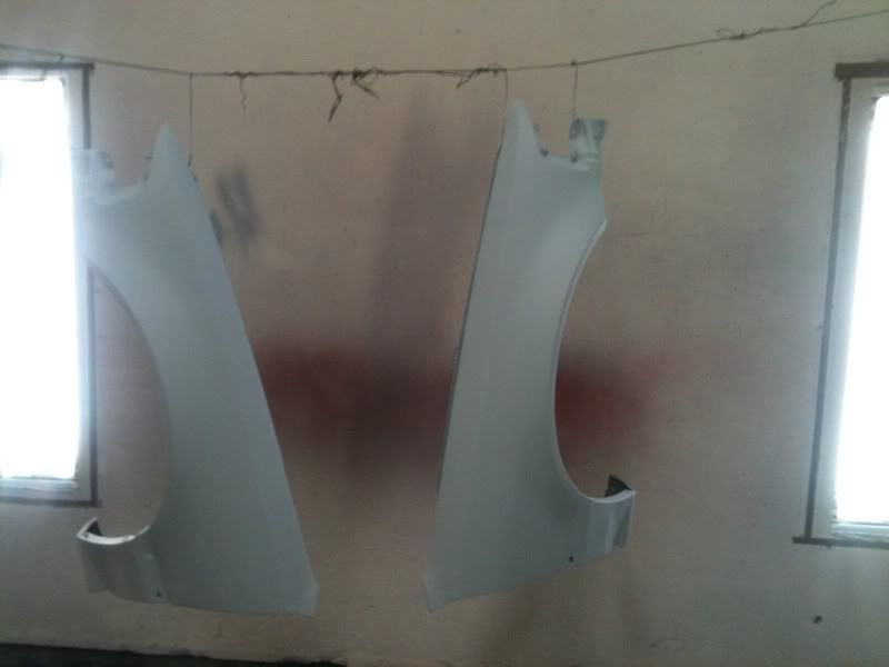

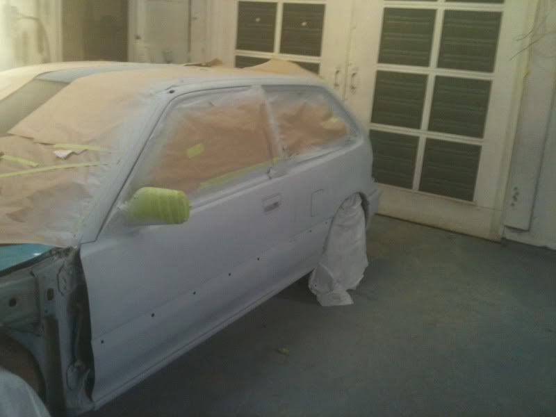

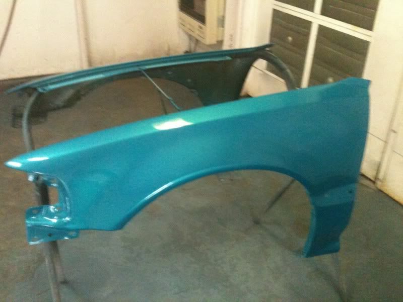

i then block sanded,reprimed,  wetsanded, sealed and finally painted the front end.

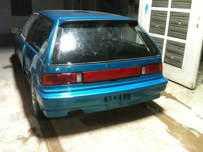

crazyassbill
  • Posts: 23
« Reply #14 on: November 28, 2011, 11:17:27 PM »

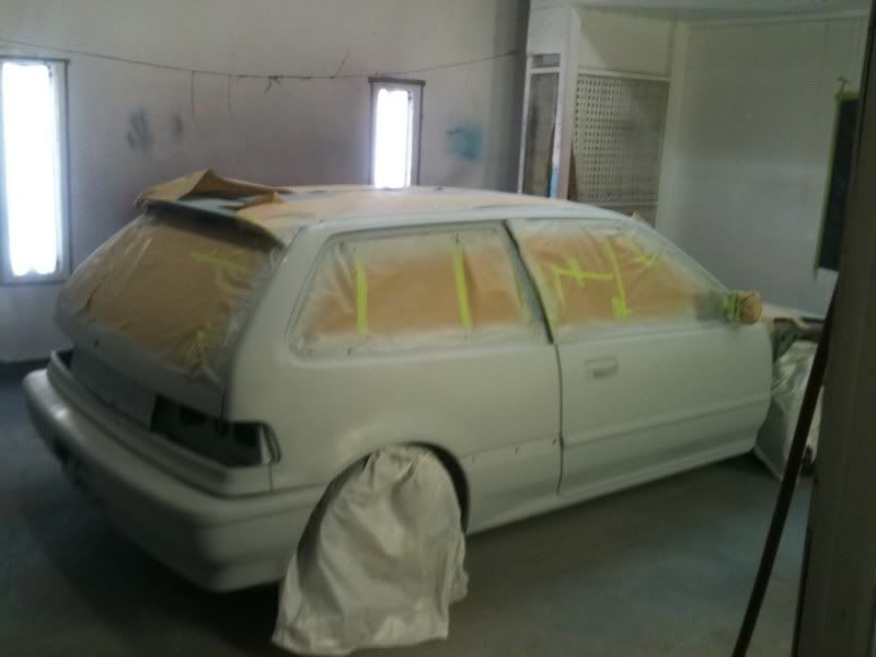

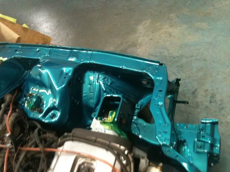

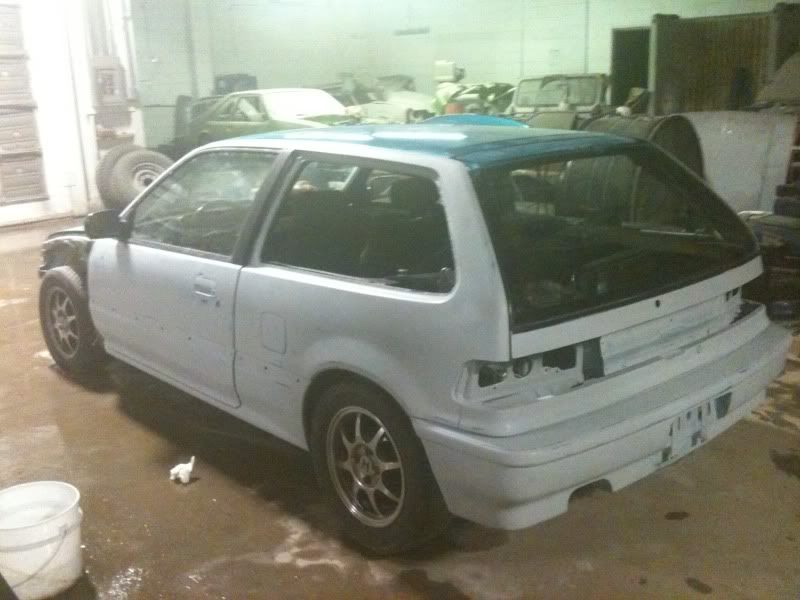

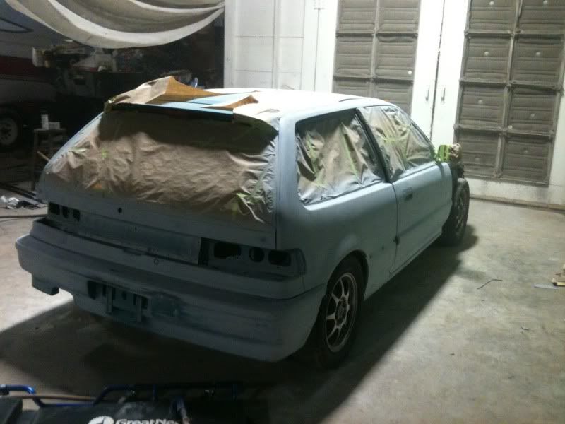

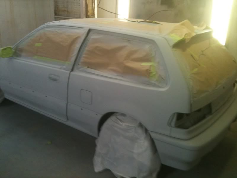

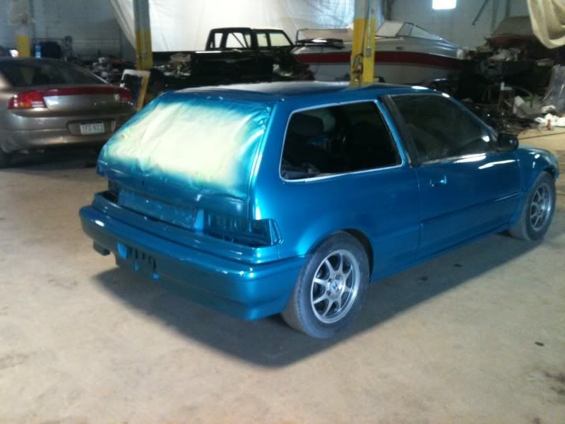

i moved onto the body next, same process just repeated
here it is reprimed and wetsanded
crazyassbill
  • Posts: 23
« Reply #15 on: November 28, 2011, 11:18:15 PM »

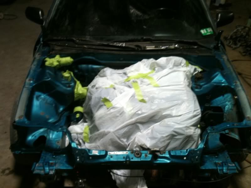

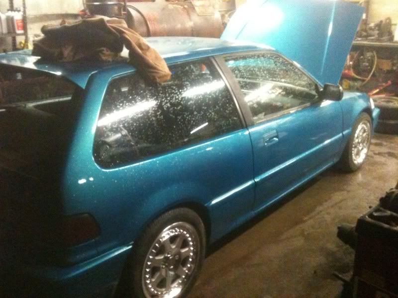

then i laid the paint on

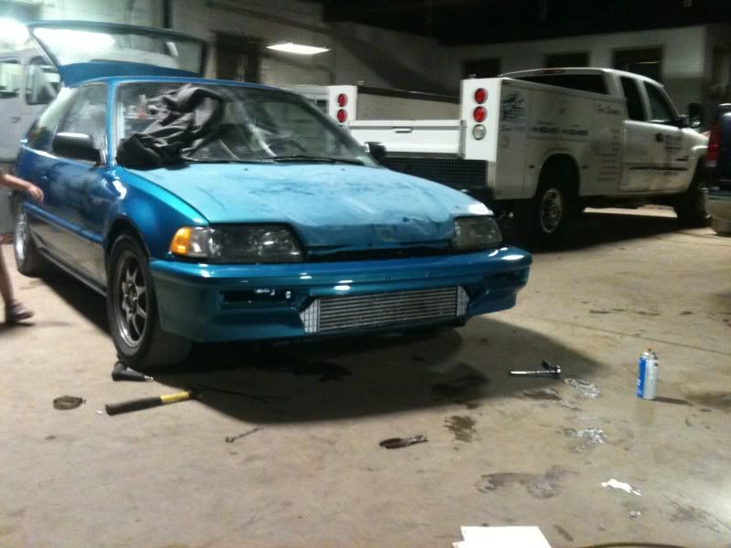

intercooler and front end mock up

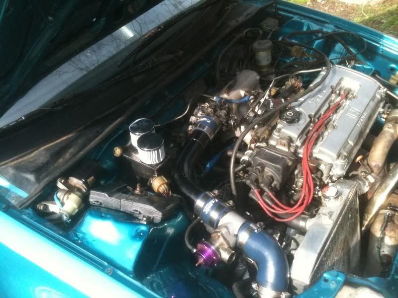

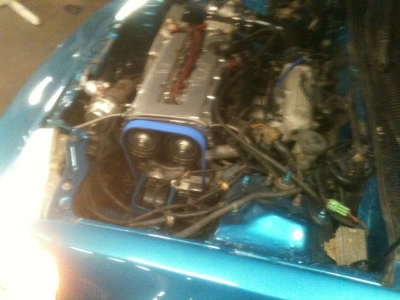

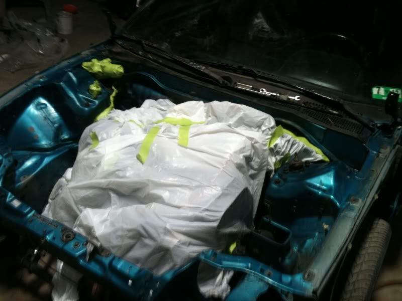

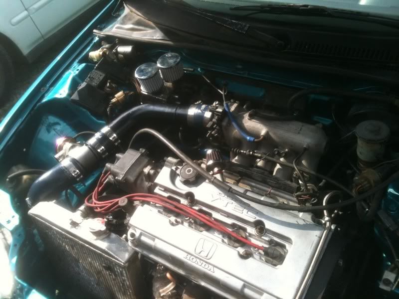

then i was thinking to my self man this paint makes it look like sh*t under the hood so i painted it.
scuffed and prepped
based and cleared
re installed front end

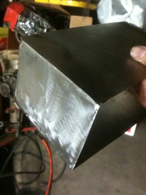

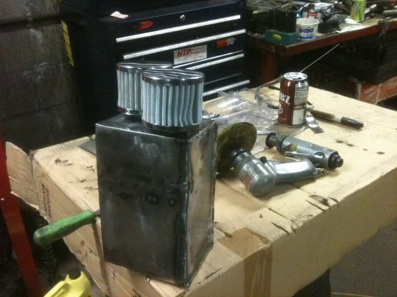

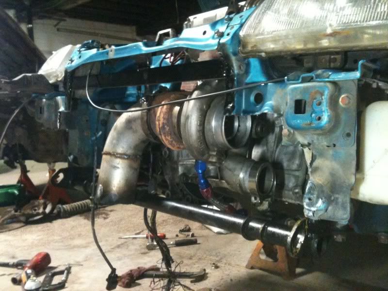

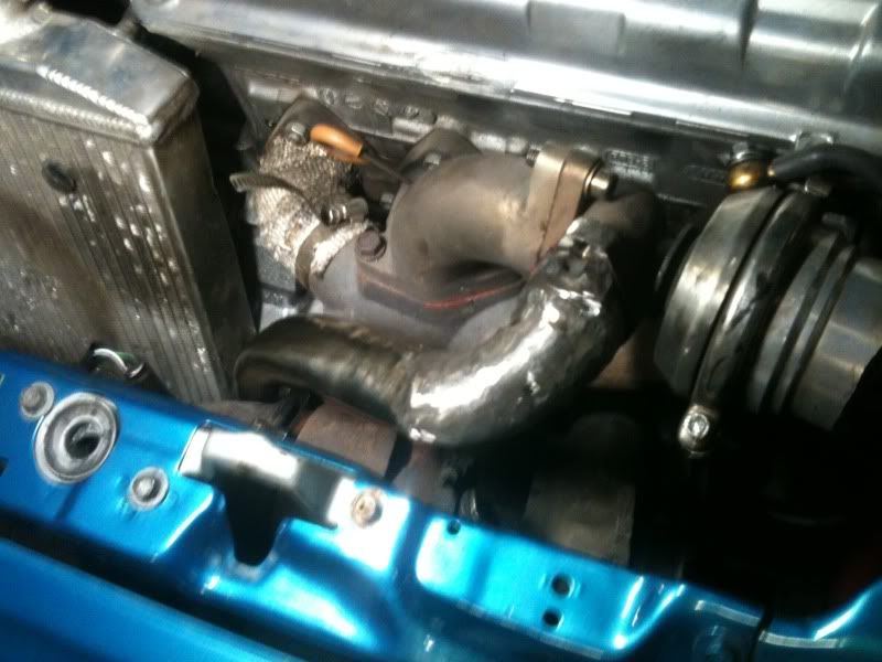

started fabbing a custom dump tube.
then fabbed my own catch can because i have more time than money lol
here it is mocked up

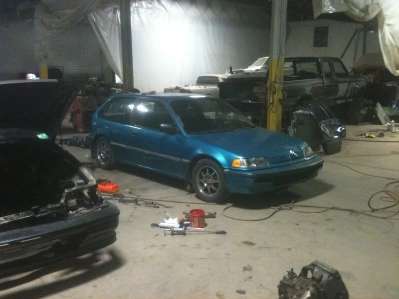

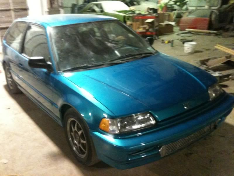

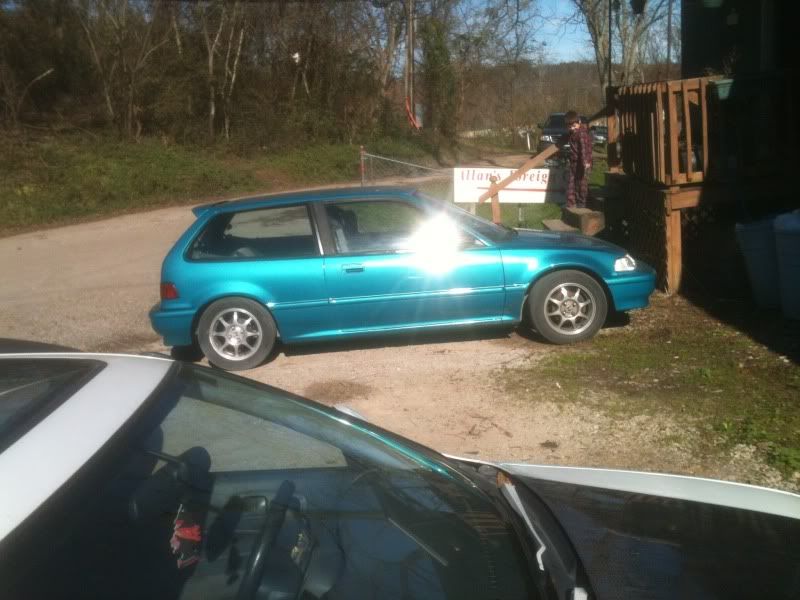

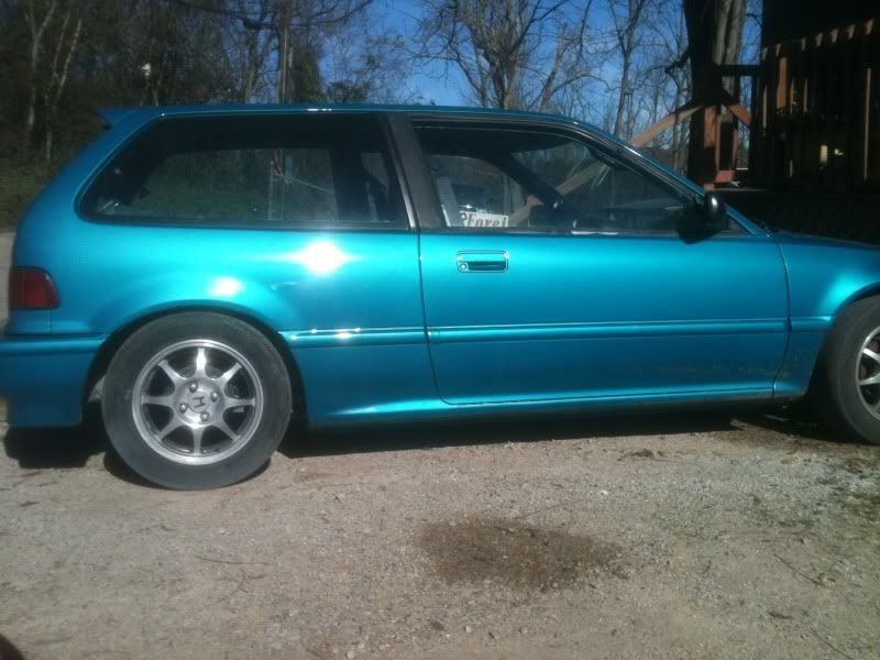

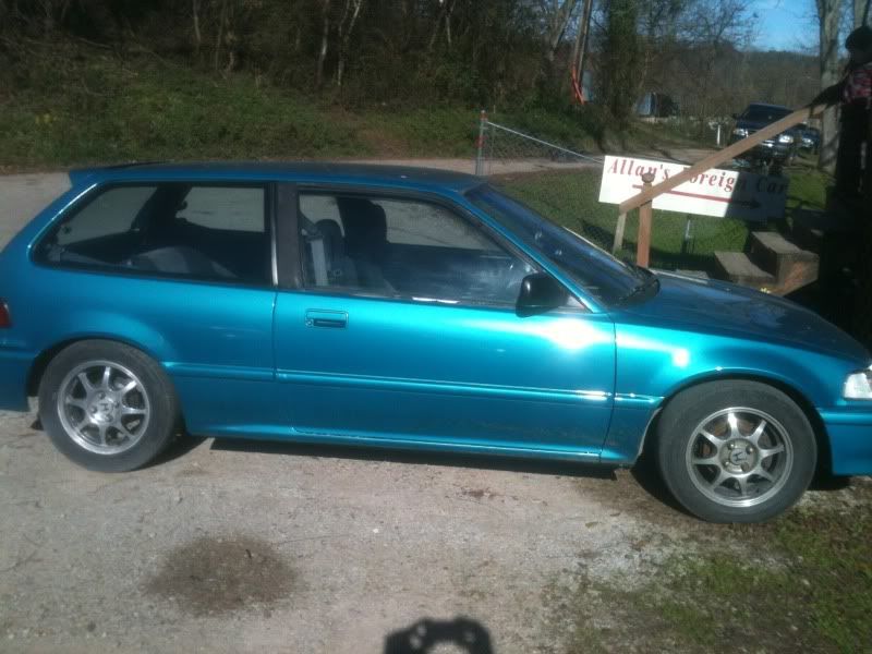

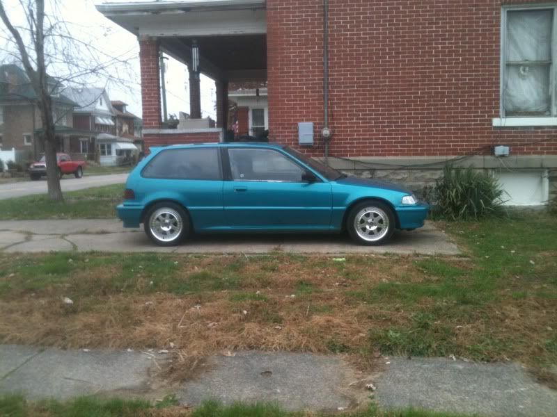

i found a rock stuck in the timing belt from the slick blow out. so i installed a gates racing timing belt
i drove it home and snapped some pics of it in the sun

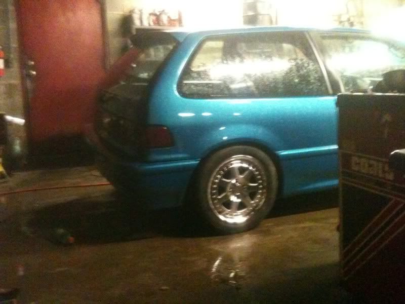

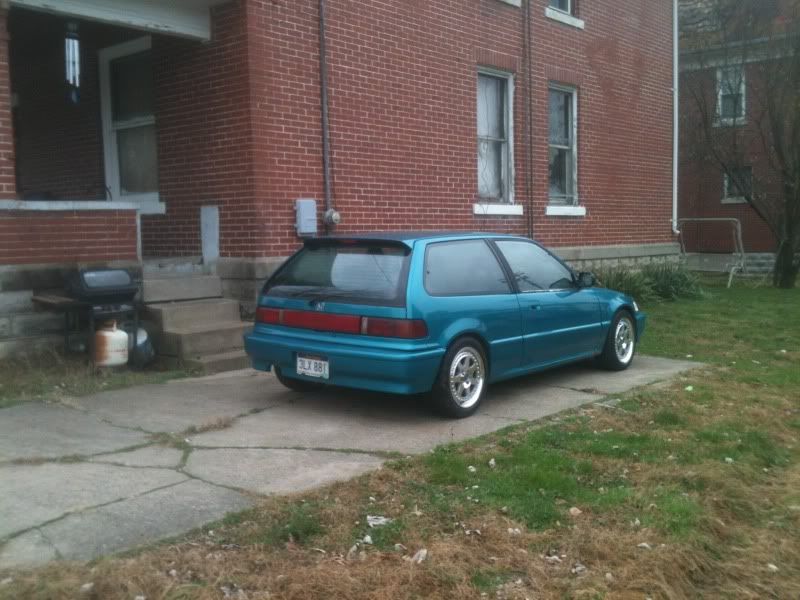

3 weeks ago my wife ordered me full machined drag dr27 for me as an early christmas present. on monday this week they finally came in and on tuesday i had tires mounted on em. wednesday i put em on
couple cell phone pics from that night
last night i just installed a victor x and a s2000 throttlebody
