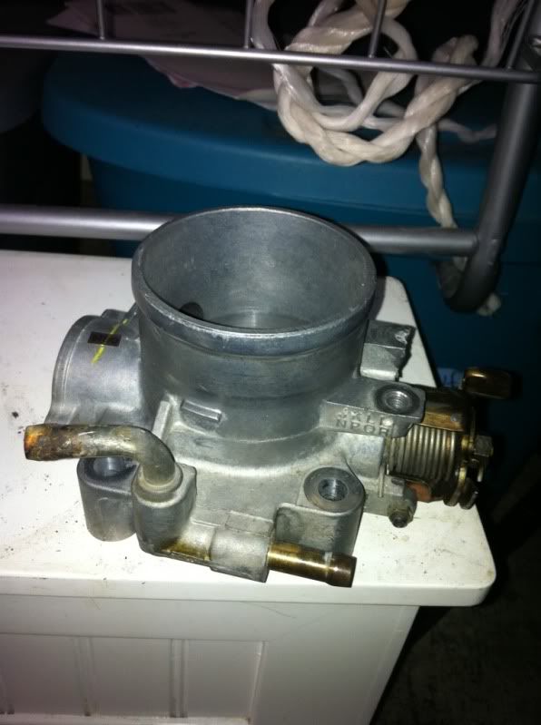

this is the TB I am using
Re: 3-4k Idle Tried two map sensors..
« Reply #10 on: November 30, 2011, 09:23:43 PM »
I would screw the idle screw all the way in, unplug the iacv, and see if it will still idle, if its does back out the throttle stop and see if it changes, if nothing then start checking for leaks.

Here is the new one with the plate I ran the fluid lines to
that throttle body uses a fitv do you have one on their LOL
« Last Edit: December 01, 2011, 05:09:39 AM by imburne »
« Reply #22 on: December 01, 2011, 07:46:54 AM »
I didn't realize it had provisions for a fitv. I figured being CDM that it just had water lines. That could be the problem. You said you ran the water lines to it, so if water isnt leaking out then there is a good chance that plate isn't leaking.

As you were saying Chris and now I see, there is a small hole in the PB Tuning Tb Spacer that allows coolant to flow to the IAVC, so I don't think that's creating the issue here. I also checked the idle stop screw and its not way off at all like anticipated. Unless I have a vacuum leak somewhere I don't know about then the gasket will more than likely solve it. I hope.. Check out some quick vids to make sure my vacuume line routing isnt screwing it up. Thanks Chris and everyone for posting up. I have reread everything a few times
Before removing throttle body on civic
Tb on civic
Thinking about car problems and making a video at the same time makes me sound like a moron I am seeing now
« Last Edit: December 01, 2011, 05:24:12 PM by imburne »
