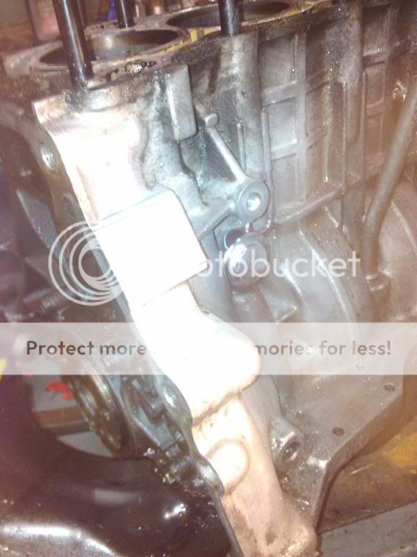

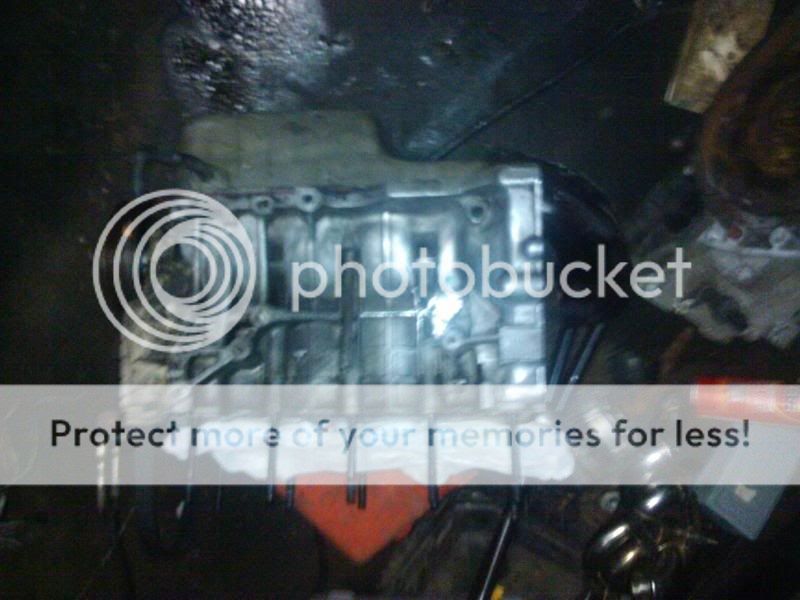

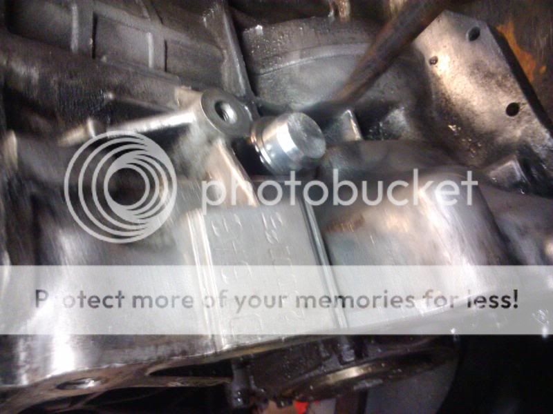

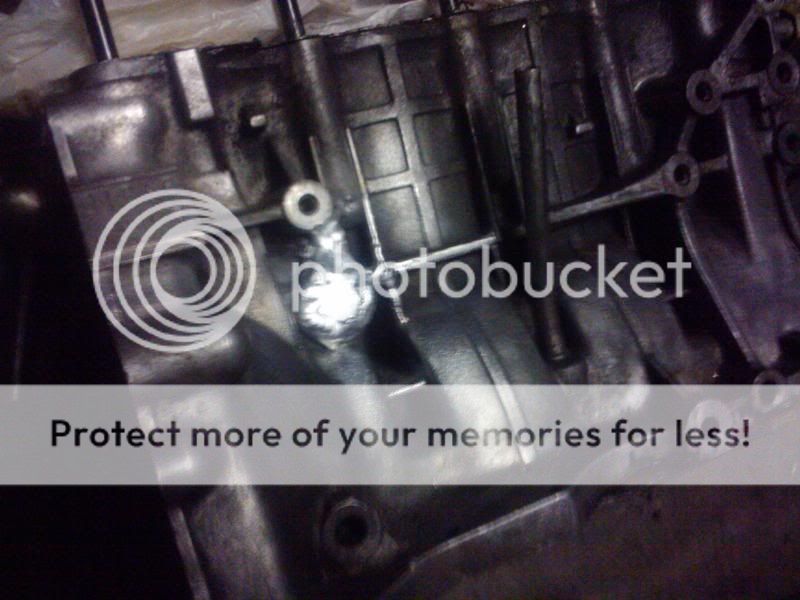

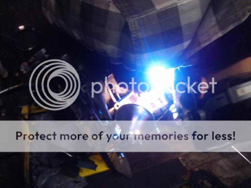

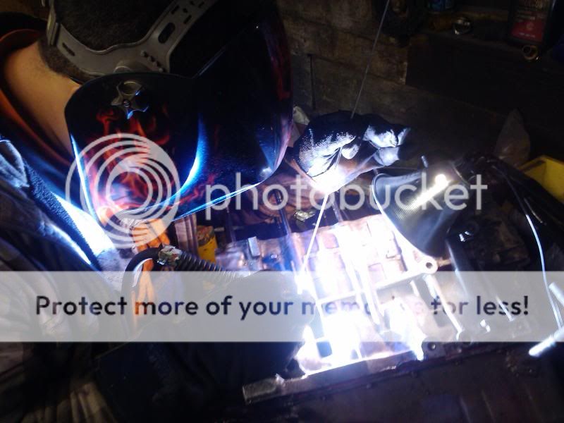

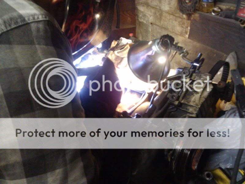

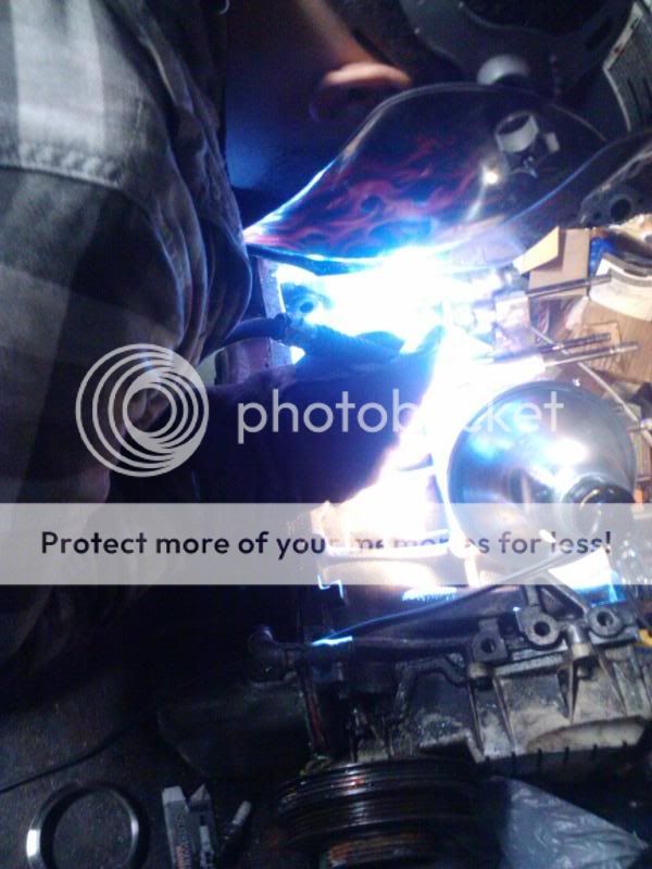

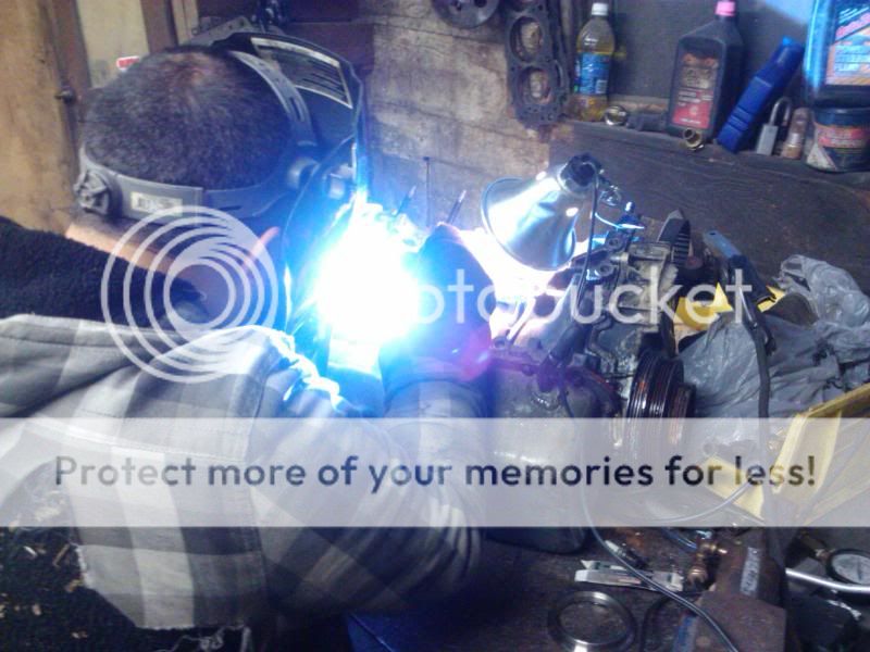

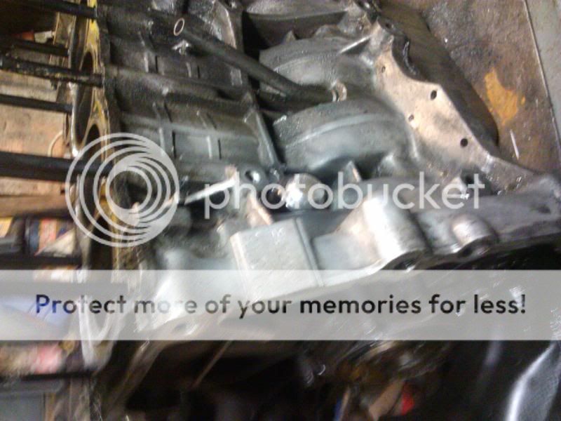

So this past weekend a buddy of mine welded up the front drain plug to reinforce it.
Baller welder
The man at work,

Plug looks sweet though! That thing is thick as fuck!

If you guys are planning on welding in that plug you need to do this before you sleeve the block. The pressure that sleeves put on the block in that section will crack the block when you weld it.
