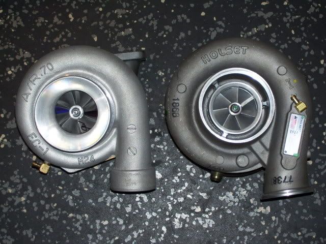

This is a GT35R
This is a SC6152S like the one I have (on left). I cant see a difference in the housings, and they use the same wheel, so what differences are you referring to?  This is not an SC6152E which uses a different housing

Re: The LXI-FLYBY back in action. Now with a vengeance
« Reply #23 on: December 17, 2011, 01:33:00 PM »
Just going off of memory, the fact that precision says it is good for 630 and the map for the 35R does not.

That is true but but the 6176 is is rated to 680hp same as the 35R, the difference is in the turbine.  The main difference between the SC6152S/SC6176S and GT35R is it that the 35R is ball bearing and they all have different turbines.  the 6152 has the smallest by far and I believe thats whats limiting the motor... The SC6176 has a p trim turbine (76mm) which I think would free up some hp vs the 69mm turbine in my 6152S...
Edit: Also im using an (8" JRC intercooler its either 2.75 or 3" thick) but im not sure if it has become a restriction yet...
