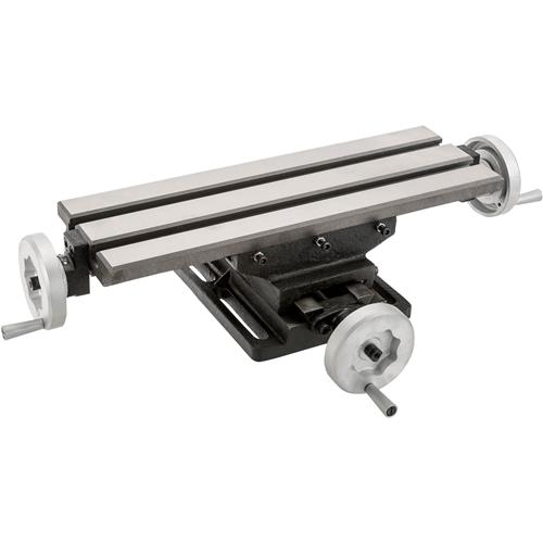

People get decent tolerances out of the gingery lathe, its all about who sets the machine up. What we are working on will be much more rigid and larger than the gingery is. We have a couple of grizzly machines in the shop I work at and those are what I am shooting for as far as tolerances go. I think to keep it simple for now im going to use a grizly X/Y table.
These are $132
