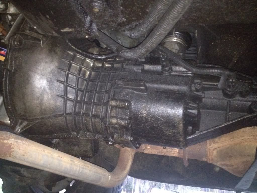

Is there anything on the tranny to ID it? I'll just crawl under there and figure out what it is.
Not sure if I said it but the truck had a 305 with a rod knock when I bought it and now has a 4 bolt 350. Everything I have seen says all 2wd manual trucks had 4.3's. The guy I bought it from said it started life as a v6 also. Maybe someone put a different tranny in it?

I highly doubt it was a diesel or a 454.  Of course I am ASSuming you have a 1500 2WD.  The NV2500 was never put behind eithr of these engines as far as I know.  The NV4500 would have been behind either of those two engines, and it is pretty damn distinct.  Cast iron case 5 speed with a removable bellhousing.

Bottom line, if it is a 1500, and it does NOT have a removable bellhousing it is almost certainly a NV3500.

It's an aluminum case with non-removable bell housing.
 :P
you are correct sir. after getting under the truck and looking at google images, it is a NV3500
