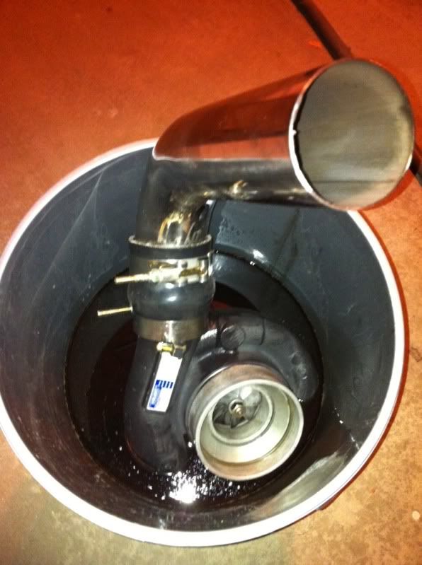

Alright now this baby has been soaked with pb blaster before and I just heated it up some and tried to wack it off with a rubber mallet. I'm sure I could have gotten it much hotter if I would have done it in the daytime when it wasn't 56f and windy. Will try to reheat it in a day or two.
Idea was posted by Chris M on one of the other threads but Im not sure if the dunkin donuts style would be good with milk
Any of your ideas of getting it off would be great too
