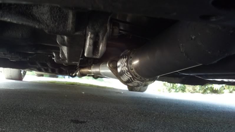

woop finished up, one 10psi pull and the clutch said fuck you :noel:, ordering one from lsd motorsports soon..  thing rips and i get full spool before 4 grand.  I ran two resonators on the exhaust and it is quiet as shit, almost too quiet.  power delivery is like 300000 times smoother then my subaru was, all around really fun car to drive in traffic and has the ass up top to be fun on the back roads too.  Anyone in the nw who wants to experience an hy35 on a b series i would be more then glad to take ya out.
heres some money shots

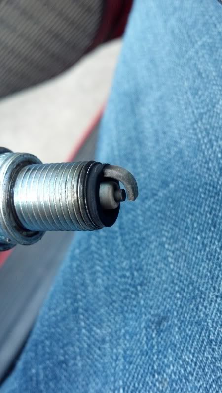

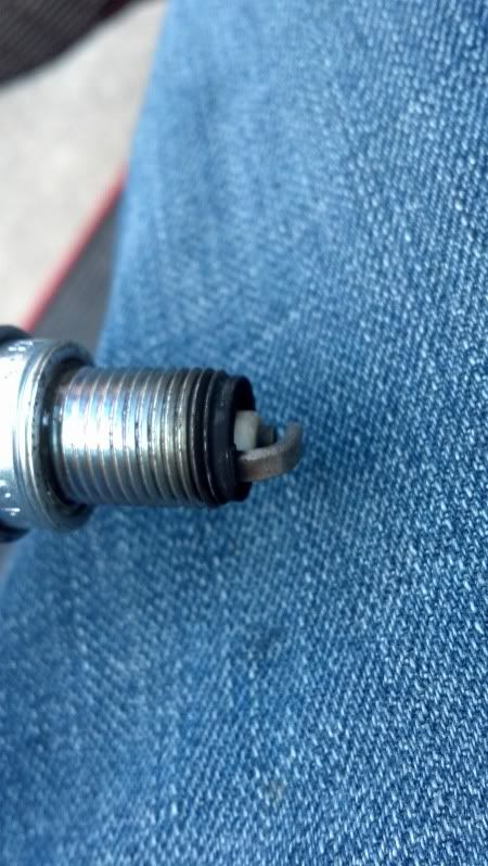

did some tuning, 9-10 lbs with a .75 timing retard per psi.  Registers 12:1 through boost, cruise has been kinda lean, been attempting to lean it out.  Im still getting a little bit of speckling on the strap but it doesnt seem terribly lean, whats everyones thoughts?

what plugs are you running? Throw a fresh set in, do a pull in 3rd gear and at the top of 3rd right b4 you hit the limiter, key the car off. Pull over and pull the #3 plug and check it out.

ngk r's p/n bcpr5es11, gapped to .040, seems like the gab could be tightened up a bit now that i think about it  :-\

yeah, those plugs are a little warm for a boosted app. I would go with some 7s or 8s. ngk 4644 or 4554 I wasn't blowing out spark at 18psi with the 7s gaped at .035

NGK R5671-7
I prefer those to pretty much any other sort of plugs for boost, nitrous or high compression. They are dirt cheap and easy to find in nearly any speed shop.
