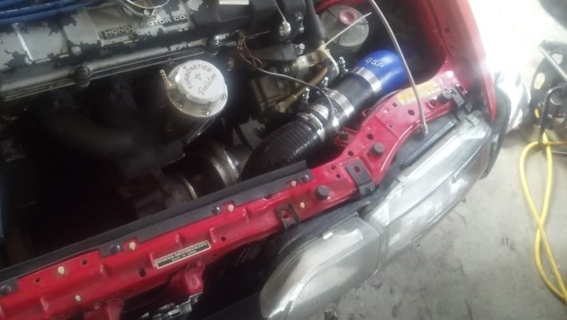

Just now posting up on here been lurking the site for at least the last 7 years, used it for an information base and never joined.  I ended up with a 90 integra sedan that i figured would be pretty fun with a holset on it.  If anyone is down to lend a hand in the next couple weeks with the head removal or fab im pretty new to hondas but im pretty well read in them, Im located in oak harbor.  So here is what ive assembled so far.
parts:
chipped and socketed the stock pr4
hulog and moates burn2 (thanks craig for the fast shipping and service)
lc-1 wideband and db1 guage
evo 560cc injectors (free)
turboedit with extratables and ecucontrol running ng63
revhard manifold
turbonetics evolution wastegate
holset hy35 (thanks 88dx)
greddy type rs bov (free)
evo 9 fmic (free)
stealthmode performance oil line kit (with adapter to holset)
civic half rad
a set of je 10:1 81.5mm pistons that i stole from a guy in cali for 75 bucks, used but had a machine shop look at them said they were good to go, saving them for when this pile of garbage explodes.
im sure there is more ill update after ive made the chargepipes and downpipe, i have a lincoln wirefeed full of fluxcore... I would like to backdoor one endtank of the intercooler if anyone has the ability to weld aluminum i would be willing to provide beer/coke/strippers.  I still need a few things, mainly an oil drain flange for a holset if anyone has one.

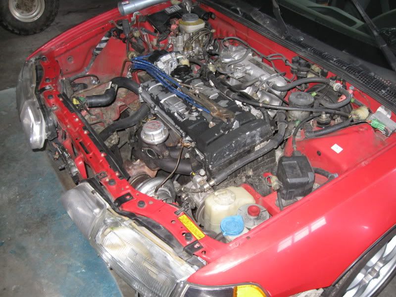

was curious to see how it fit in there, This week im pulling the head and its getting the arp's and a fresh honda gasket.
2000 shee and my mtn bike, 98 xr400... not stock.
The big toy and the mobile electrical fire... at least its a diesel
Sorry for the weak ass porn, wife is right next to me.  no pics of said wife sorry  :)

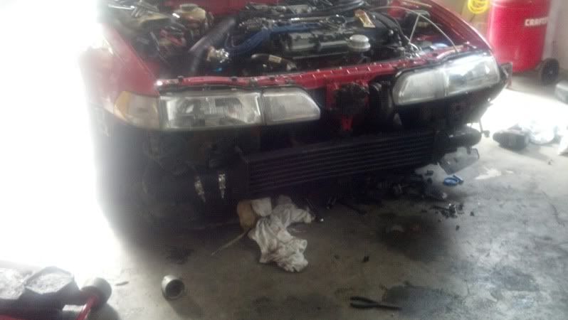

Yes more to come i just pulled the bumper/ac/and hood off of it yesterday so this is just the beginning.
Im kinda debating not doing the arp's until winter, i have a 9 psi spring in the gate right now and thats all i intend to run until i build a block for it.

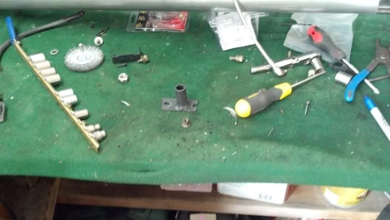

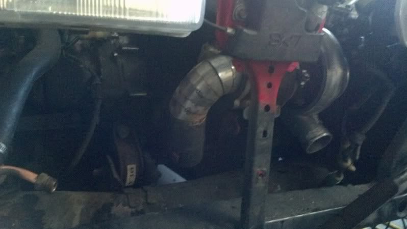

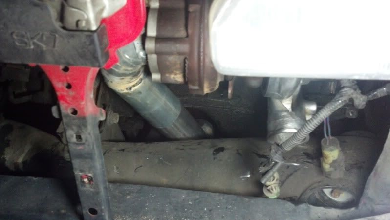

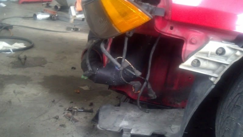

tacking the downpipe, 2.5 tubing due to the fact columbia manderal bending doesnt sell a 3" holset flange.
here is where i stuck a fork in it for the night.  retapped the oil inlet of the holset to accept 12x1.0 so my oil feed is dealth with leaving return to be done another day.

I wish my turd still looked decent like that. All the salt and being hurried in snow every winter is beginning to take its toll.
Nice build.

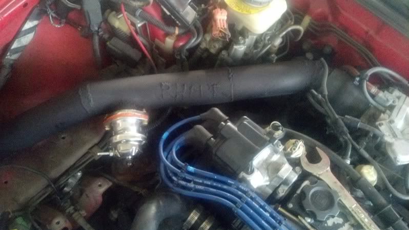

update again, did some good old sunday afternoon fabricating.  made an oil drain flange and dude it intake the intercooler pipe today, didnt have anything to cut a hole for the bov so i used my wirefeed as a plasma cutter  :?:.  Everything seems to come out good with no holes to be seen.  Parts are on order and next weekend it should start.  baller ass oil drain

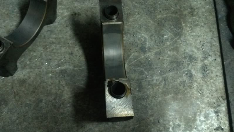

so when i pulled my oil pan to weld in a drain line, i found a bolt on the #1 main bearing cap backed all the way out.  So i took it out and found the head of the bolt was broken causing it to back out obviously.  pulled the cap and looked at the bearing, it looked fine and there was no abnormal wear patterns or anything.  Then i pulled the next main bearing cap (next down the row).  and found this.  Pretty much am wondering whether i should just replace main bolts and slap it back together, or is this bearing even worth fucking with?

i cant really tell from the pic but bearings are cheap. i would stick some new ones in it.

Meh i ordered new bolts yesterday just gonna slap it back together, rev limiter is gonna be set at 7500 so hopefully itll last.  If not i have an excuse to build a 10:1 ls block  :noel:

ARP bolts are like flack jacket in cod black ops.  That's pretty crazy to see them snap like that and not have catastrophic failure go down.

they were actually factory honda bolts, whole motor is untouched as of now.  Well see how well my tuning skills are soon enough haha
Nah, i meant arp's ARE the shit.   I assumed factory bolts.  They have a much lower sheer tolerance.   Good luck.  Wanna see this bitch  spin 3rd from a roll!
