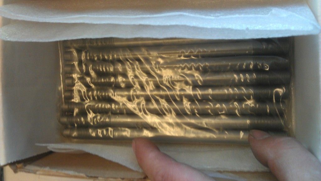

L19 studs to  ;DDD

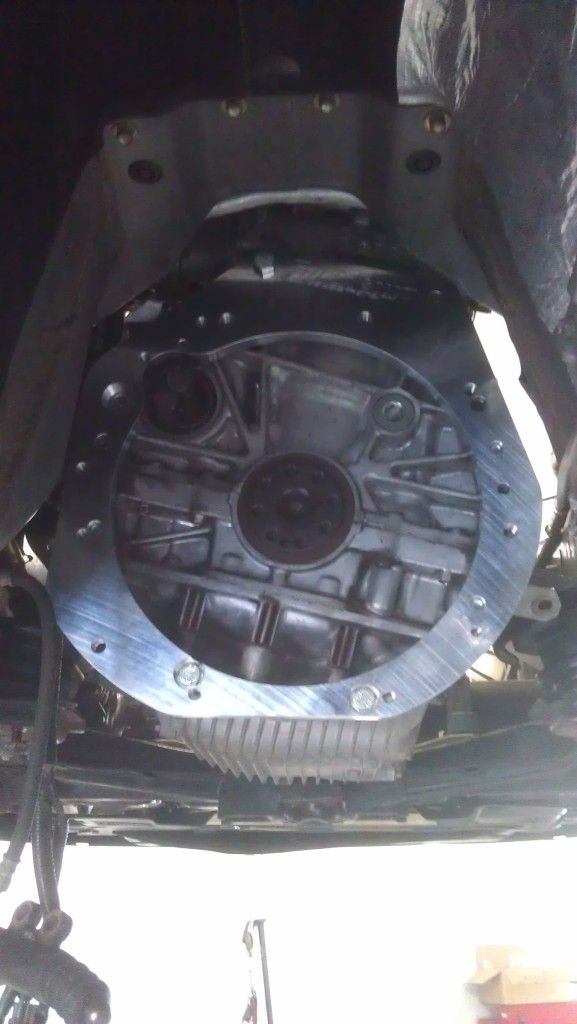

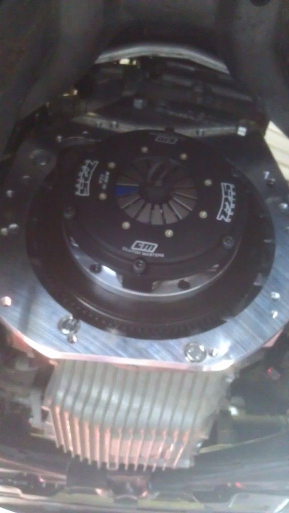

Started on the trans today tomorrow the trans install will be done,all the shit is bolted up fo ig but I was go lazy to finish

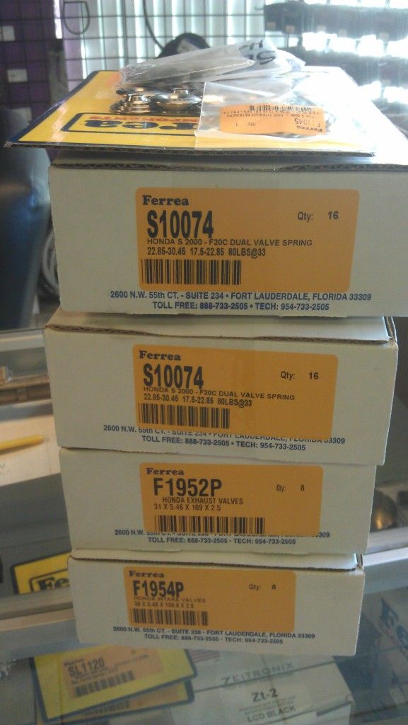

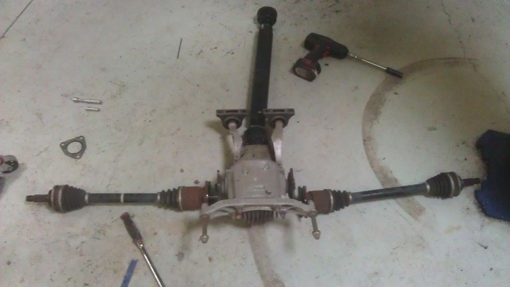

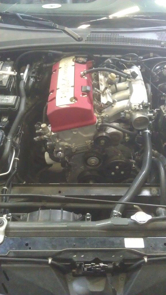

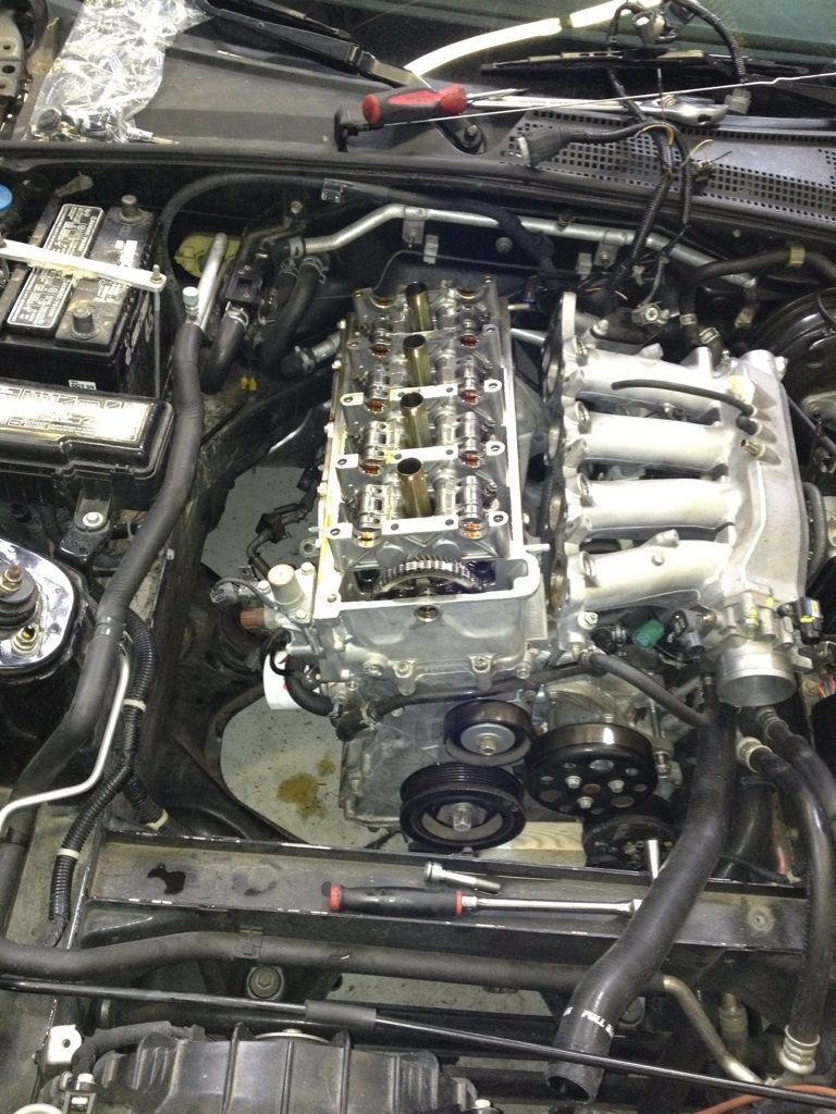

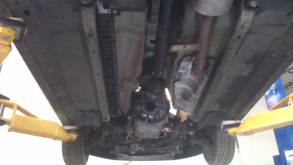

left the trans install alone today, i did notch the bell housing to accept the s2000 starter and just stripped the bay and pulled the head and rear end out not to bad for 3 hrs now im going shooting, head should be done earlie next week with valves, guides and seals and springs along with punching the head stud holes out bigger to accept the L19 studs, should go together fast after that cause all the drive train will be in tomorrow so only thing left is manifold fab piping and exhaust

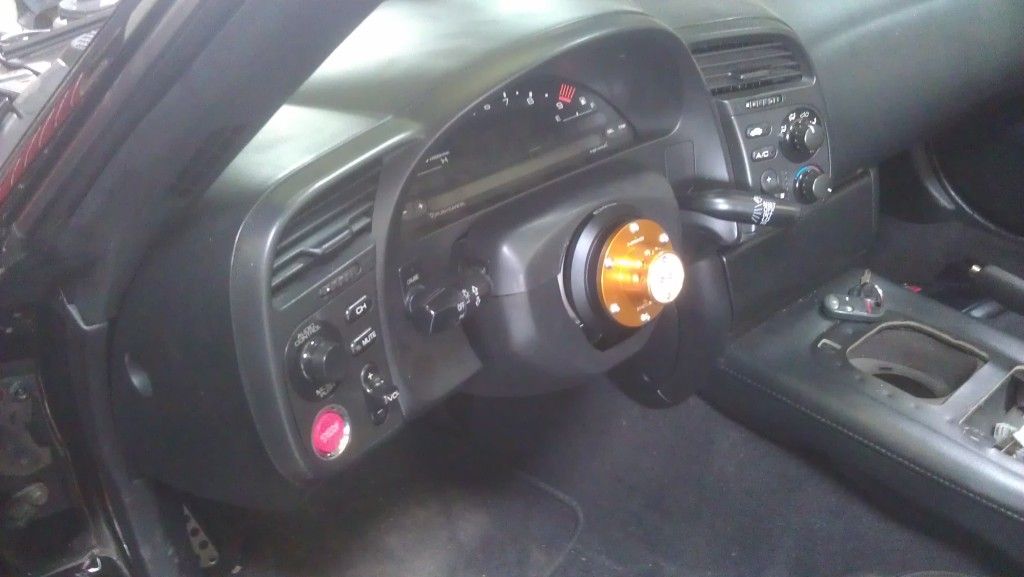

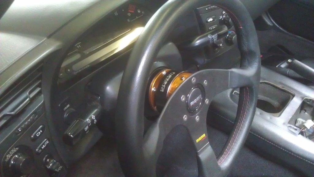

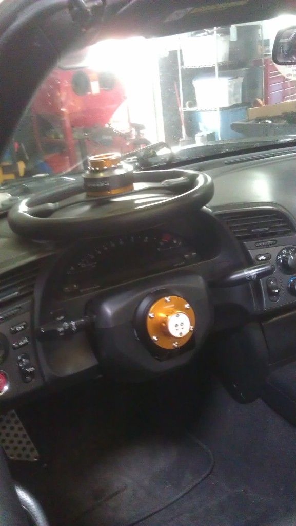

Got my wheel and quick release in today. So when the cage is in I can get my fat ass in and out

i really need one of those for my hatch. its tough to get in with the corbeu seat, and almost impossible with the cage

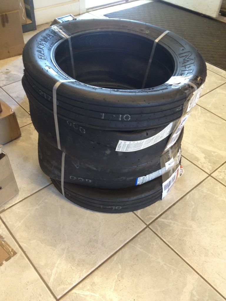

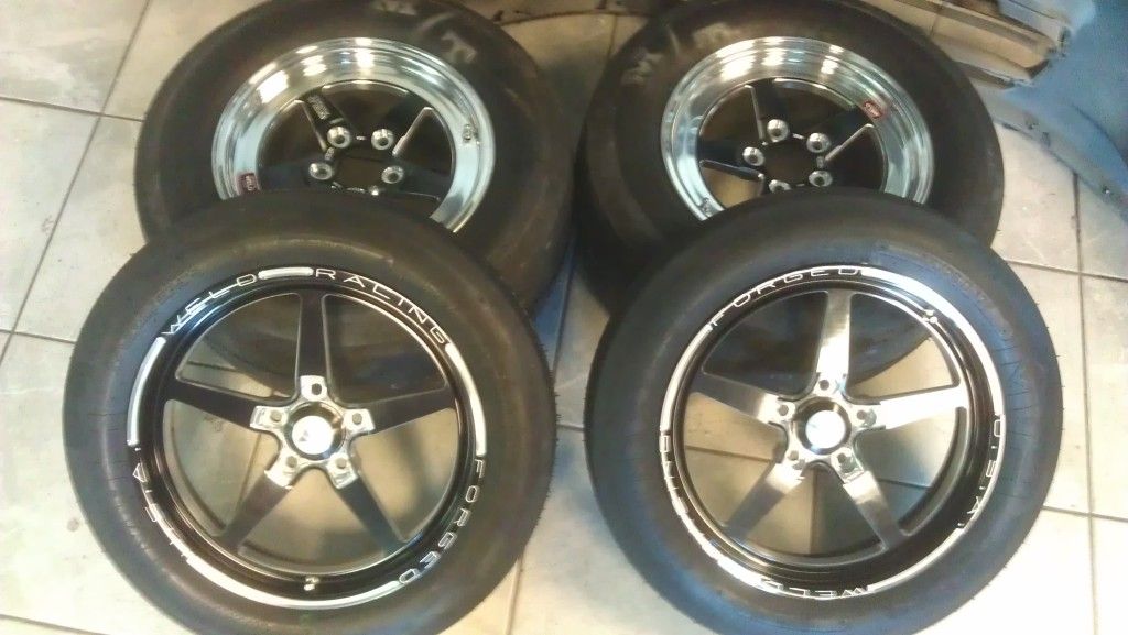

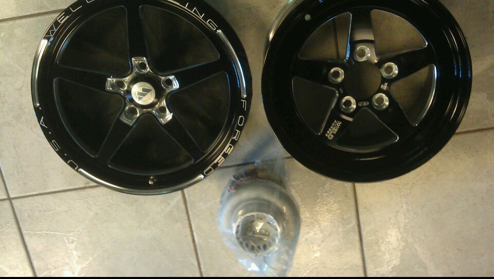

26x10x15 Mickeys and 17x4.5 race master skinnies for the welds

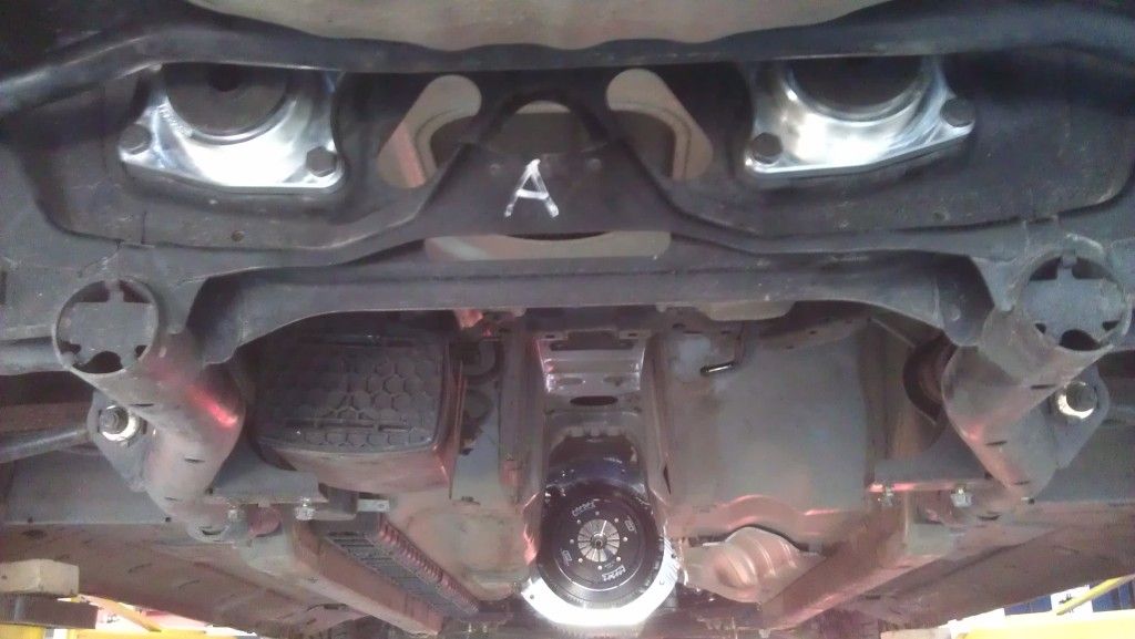

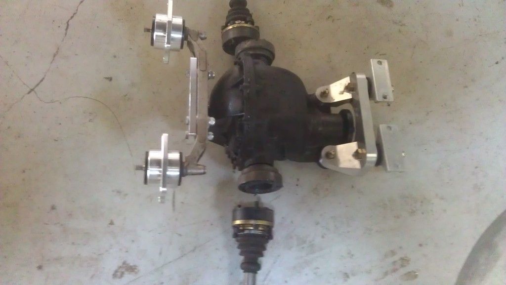

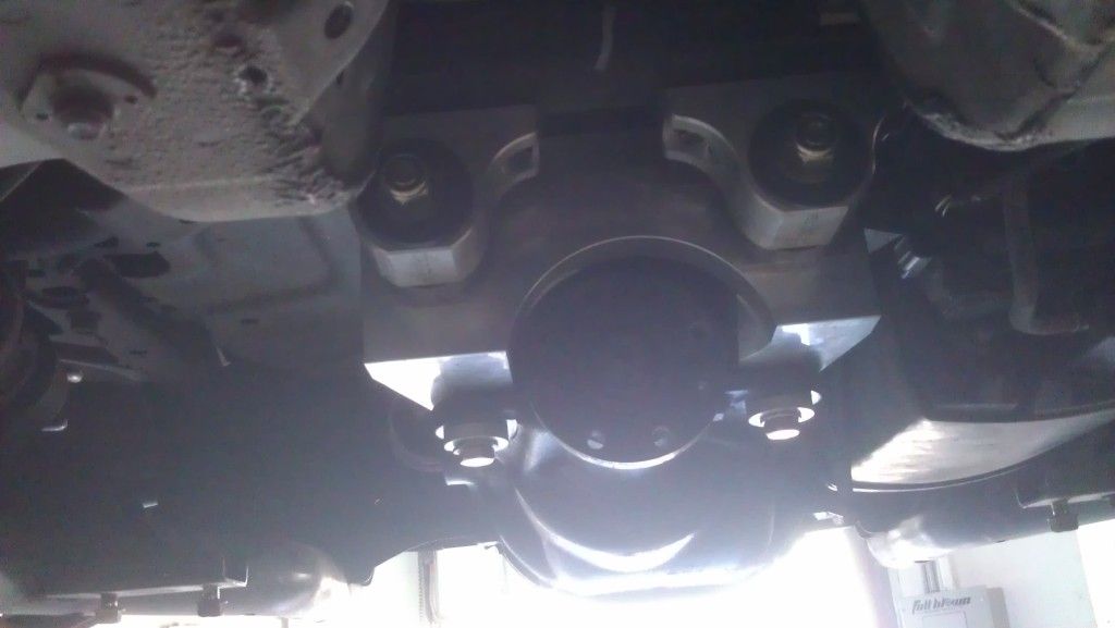

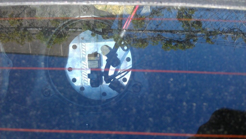

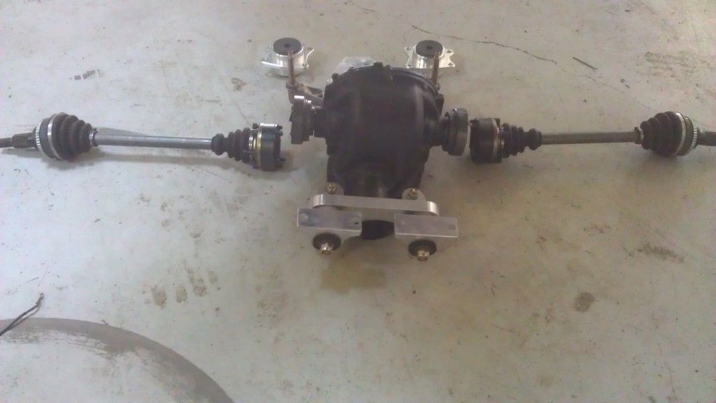

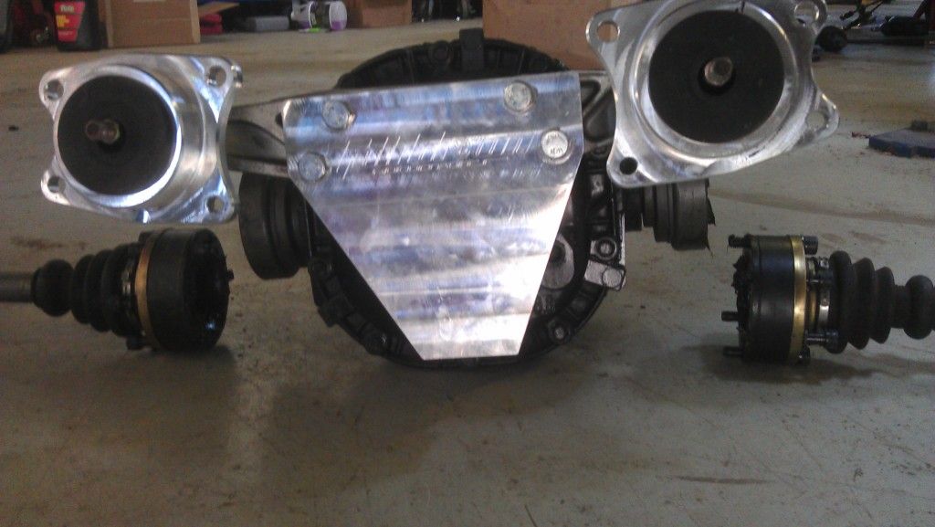

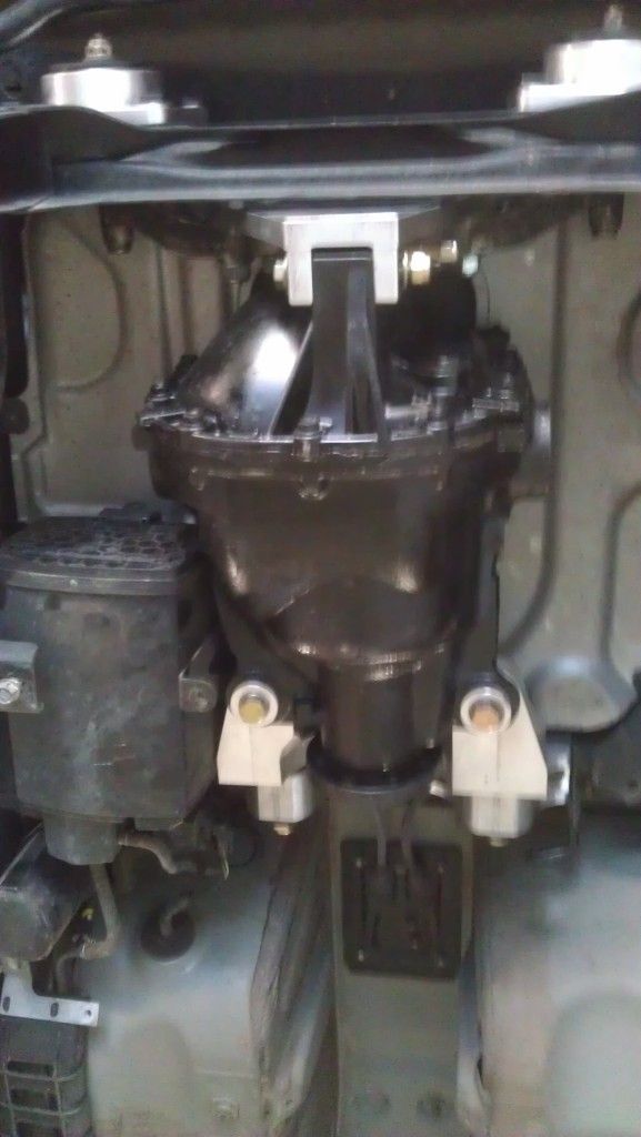

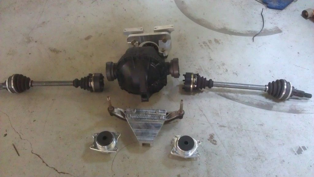

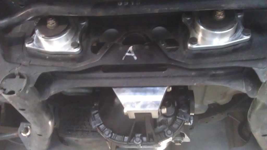

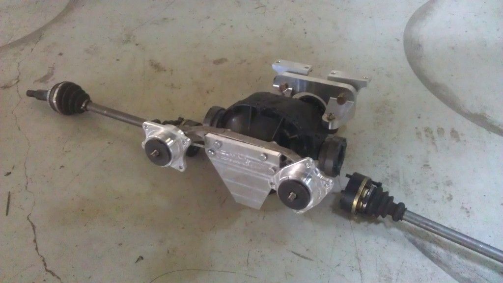

Duel pump hanger with twin 390's installed, Eaton LSD and richmond 3.96  gear set installed in the 8.8 rear,also all mounts bolted up ,and the 5.9 axles showed finally so should be in the car very shortly ,also got my slicks mounted up shits look way to good

Hot Damn that looks sexy!

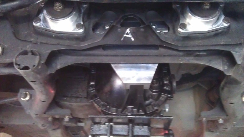

« Reply #57 on: April 26, 2012, 06:54:44 PM »
Rearend install completed and while I was chillin my race pack for my heltec showed up
