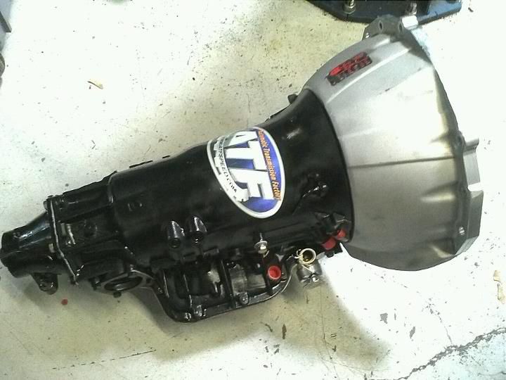

This is the trans Im having built right now, has a little slimer bell housing so firewall modifications should be slim to none I hope either way shits going in ,
http://www.atfspeed.com/store/index.php?main_page=product_info&cPath=193_194_49&products_id=259

I thought so, comes with a milled down bellhousing also to fit in the supra tunnel so im hoping tunnel/fire wall modifications are slim to none

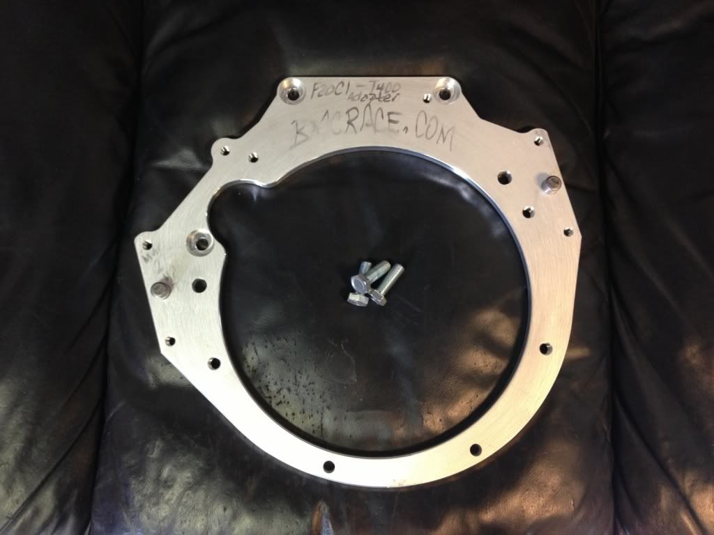

adapter plate showed for the t4oo

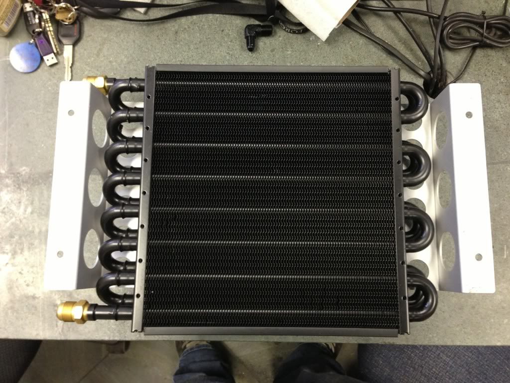

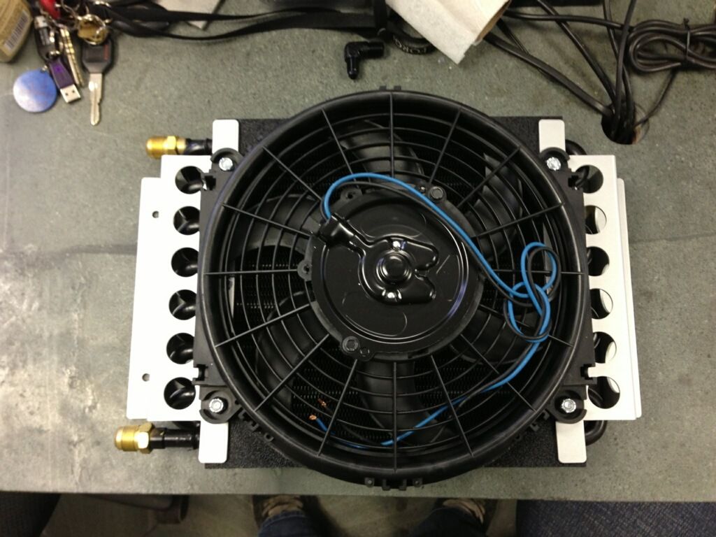

-8 an trans cooler with thermostat switch for the fan

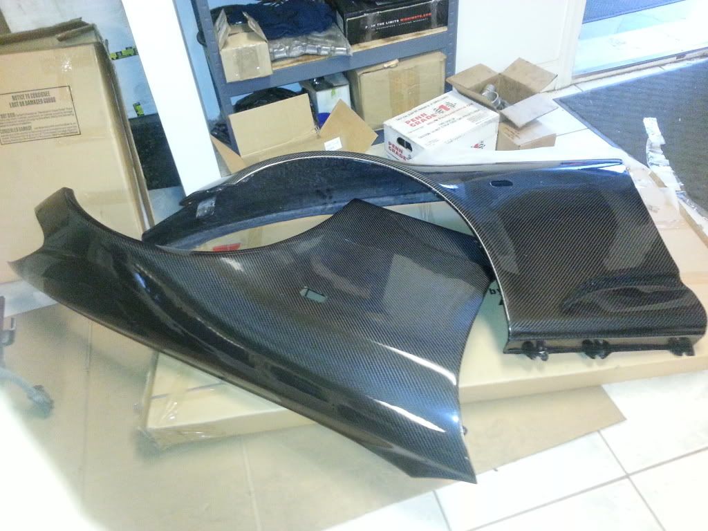

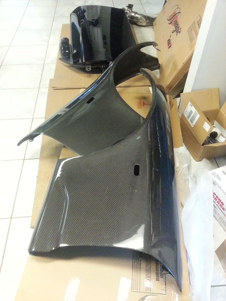

also swooped a nice set of cf fenders just cause they were cheap sad thing is i think there heavier then my stock ones, oh well ill just have to drop a deuce before i race to make up the diff

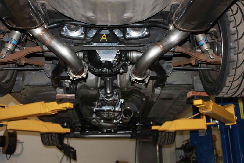

had a exhaust made for the street runs cause open dp is dope but loud as shit at 10k
Only exhaust pic I got right now single 4'to duel 3' all stainless with vbands

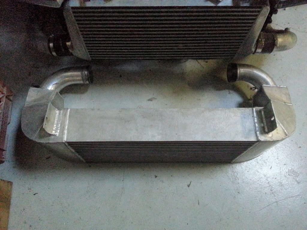

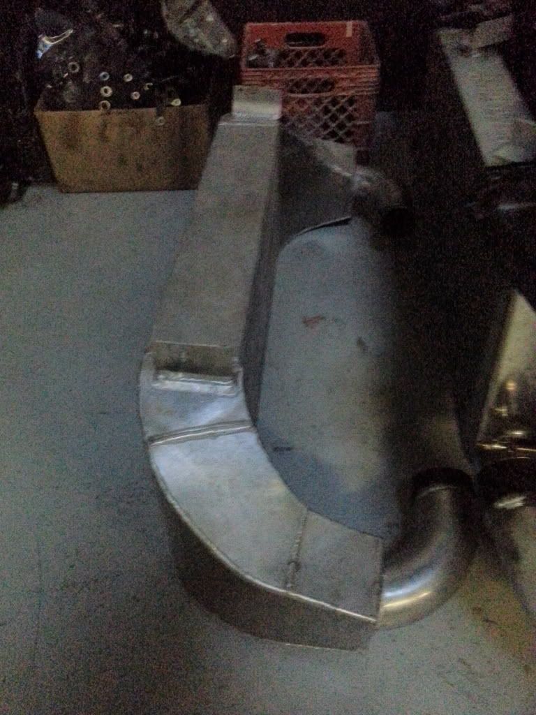

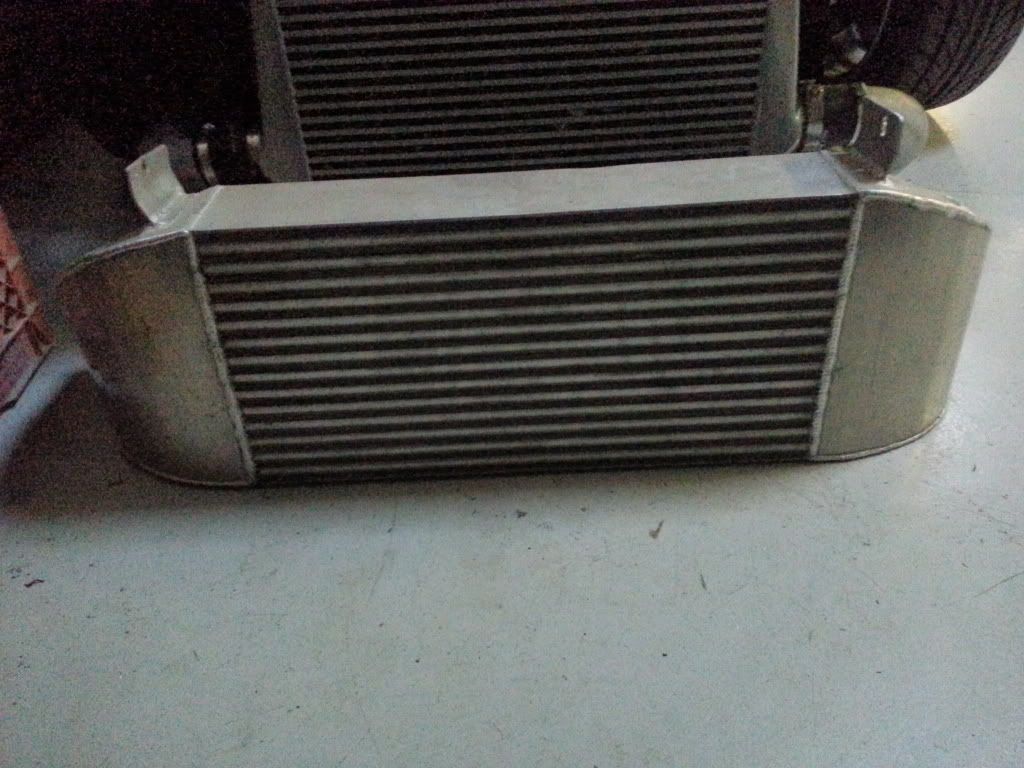

picked up a 1000hp intercooler also, shits crazy on the car takes the whole front end up you could rock it without the bumper and shit looks way good

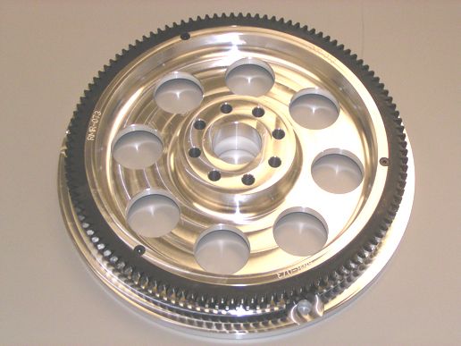

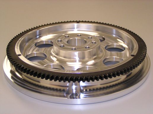

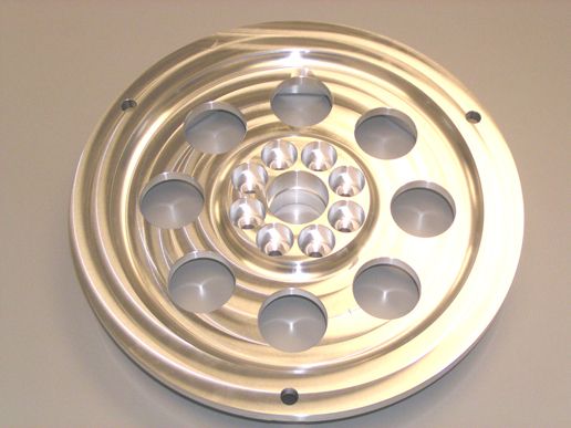

last thing i need to get this bitch in and done is flexplate and for atfspeed to finish my torque converter. i ended up going with a 5200 stall 10' and got a guy to make the flex out of billet as soon as the converter shows so i can take a few measurements for
it should look like this when done
thats about all for now im waiting for some more shit to show up so ill keep this up to date as shit shows, i only have my build here and mine and stealthmodes forum
