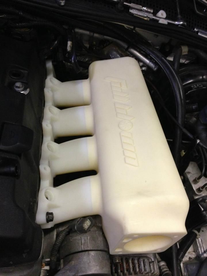

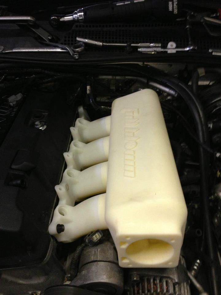

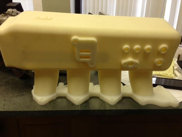

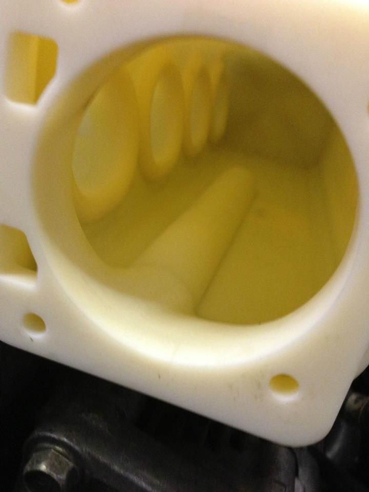

Ran up untill I parked it for the rebuild, might sleeve it still kinda up in the air (funds) but ill see.here is a intake manifold fbm designed for the s2000 chassis that we are testing on my car here is tbe plastic fitment piece real one should be here shortly

« Reply #125 on: December 27, 2012, 11:10:57 PM »
Is that going to be cast or billet? Looks good.
hatchbone
  • Posts: 1708
Re: new drag car
« Reply #126 on: December 27, 2012, 11:13:40 PM »
Casted, should be a cheap option with good fi performance for the s2000 cause as of now there os not much out there for manifolds
walter
  • Posts: 2931
Re: new drag car
« Reply #127 on: December 29, 2012, 10:58:54 AM »
wow! how it's made in plastic one?  :o
carkrazed
  • Posts: 3422
Re: new drag car
« Reply #128 on: December 30, 2012, 10:09:19 PM »
Cmon Walter...................3D printer, lol

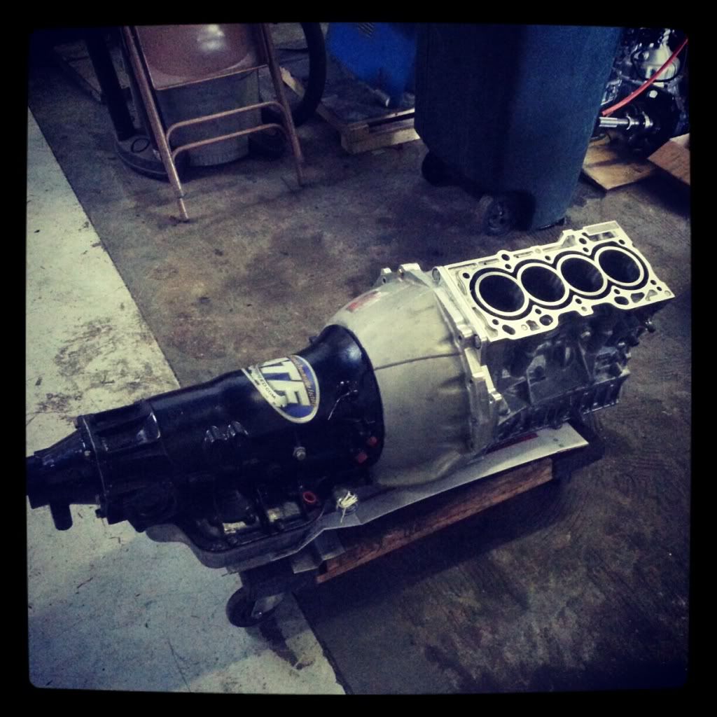

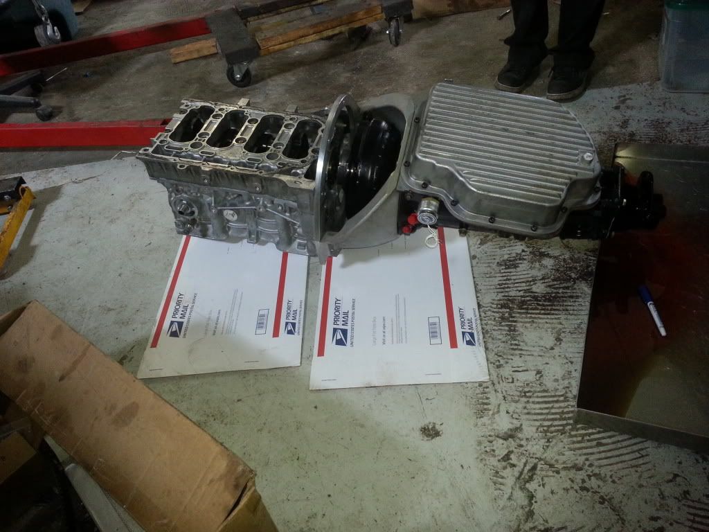

transmission showed up today at fbm,so stealthmode thought he would try rwd out

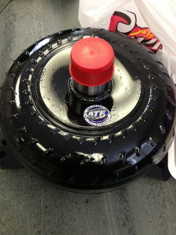

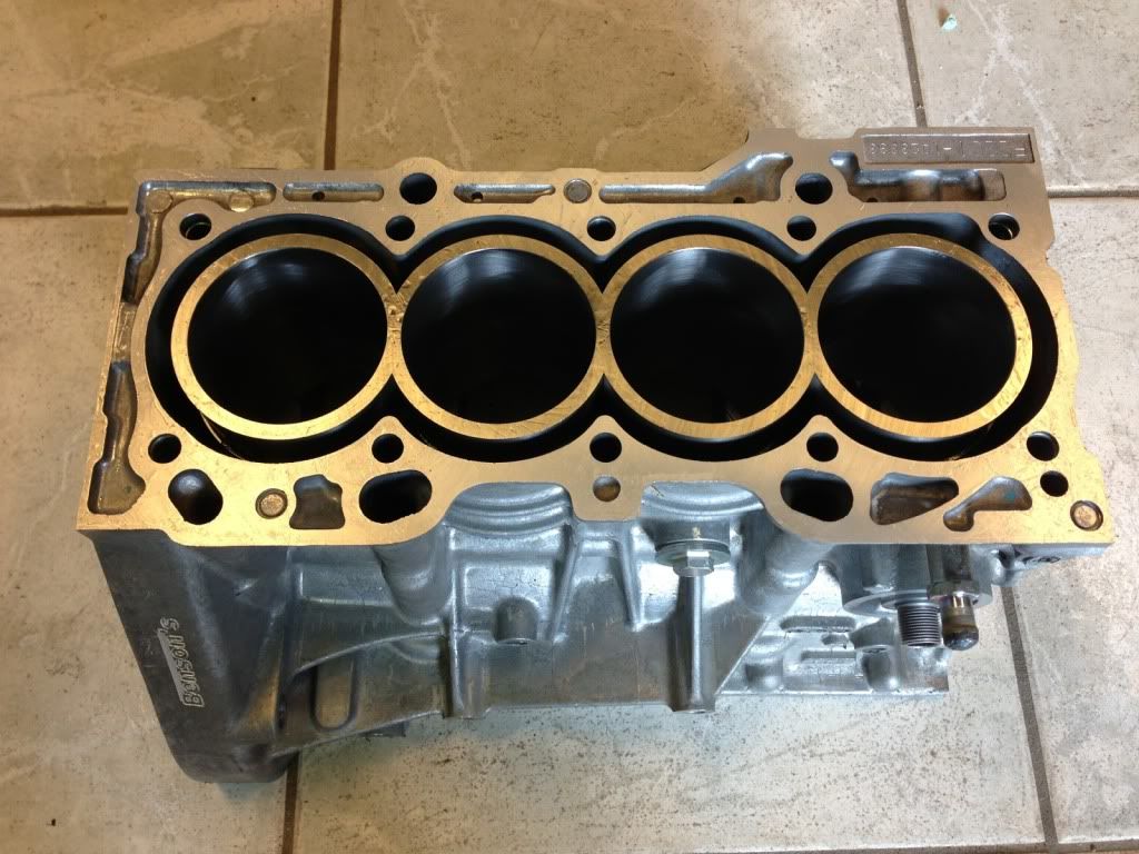

Torque conver finally showed up (6200rpm stall) and also my freshly sleeved f22 from benson

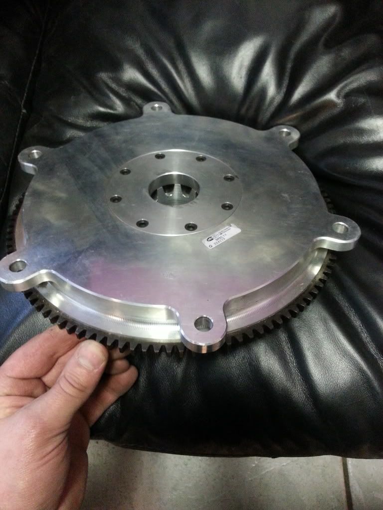

Finally got every thing bolted together to get the backspacing measurements for my billet flex plate today, should look like this when done.kinda excited

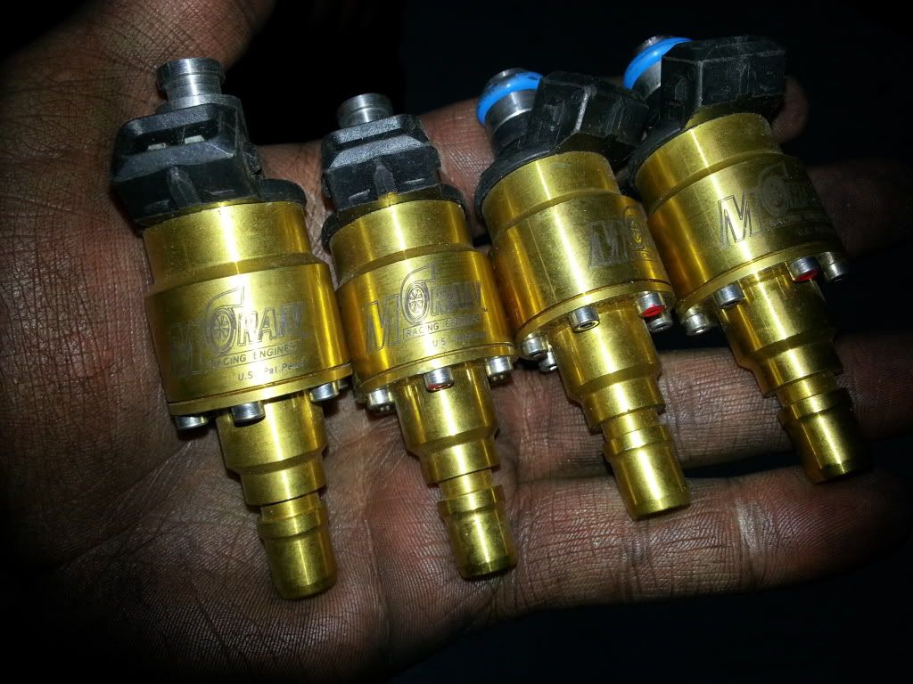

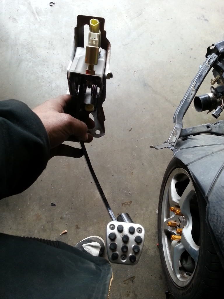

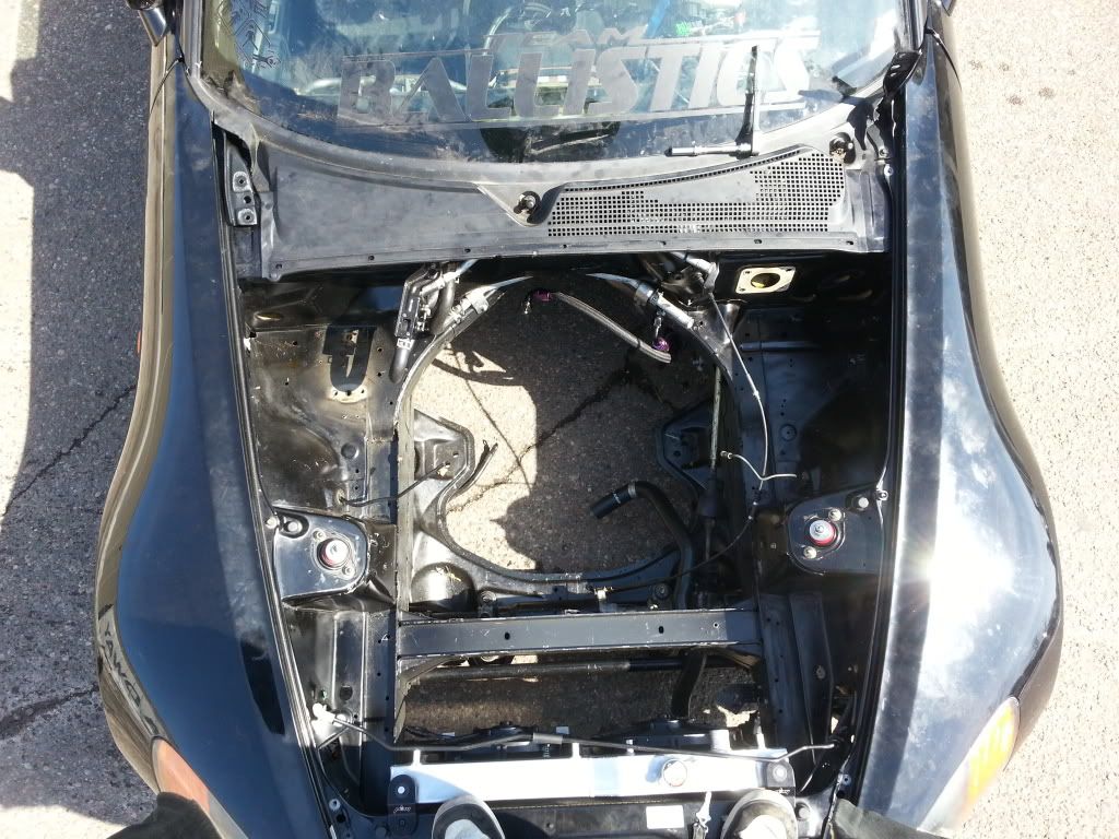

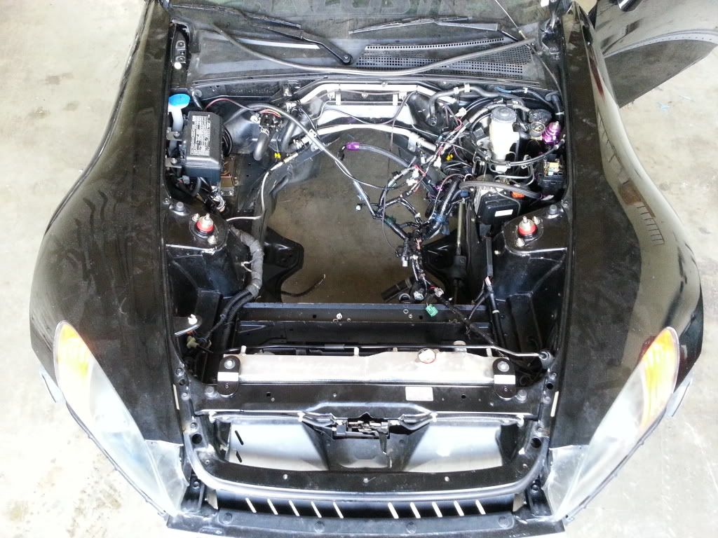

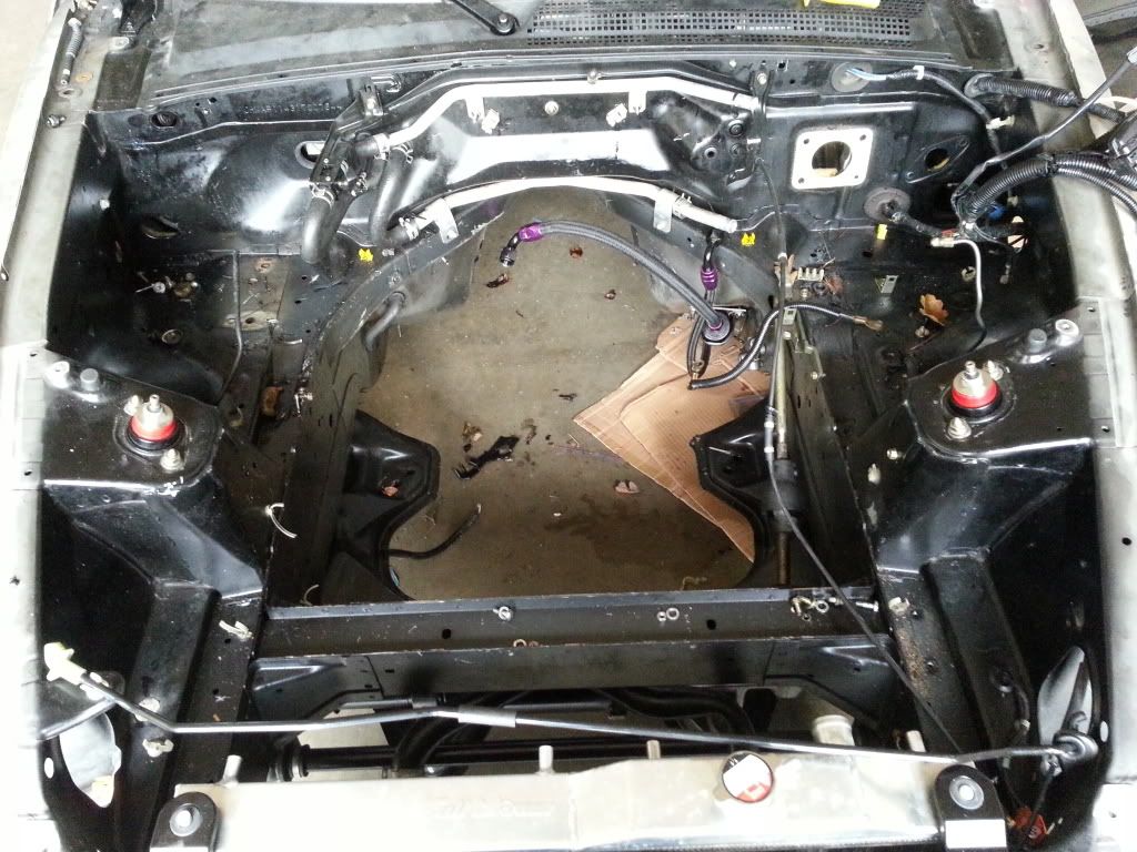

Found a little time to work on the car today, got the bay almost were I need it to be pass side tuck is done tomorrow I just have to do the driver side wires and she should be good to start running all the new brake lines while im waiting for my new head to get built and assembley balanced, got some diff injectors today also.the 2150's were almost maxed last year at 800 so yhese 3000cc should be judt what I need for this year
Heres a before shot
And this is how far I got today
Really the only place these all fit
Clutch pedal ? Aint no body have time for that
And my injectors if 3k aint enough they are upgradable to 5000cc lol

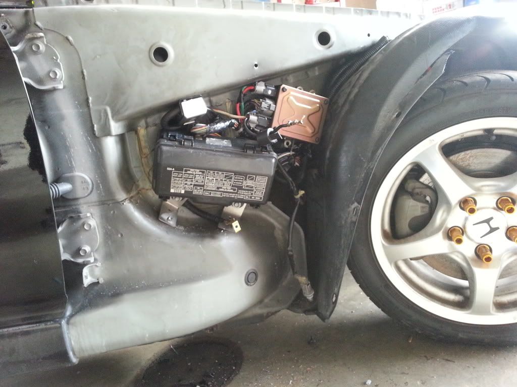

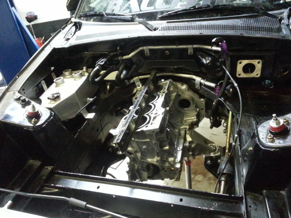

ot the tuck 100% done today, cant see a single wire in the bay test fitted my cf fenders also seen to work good all ready to start test fitting trans/engine next
Before
After
Not sure if this is what they ment by white power lol it will work though

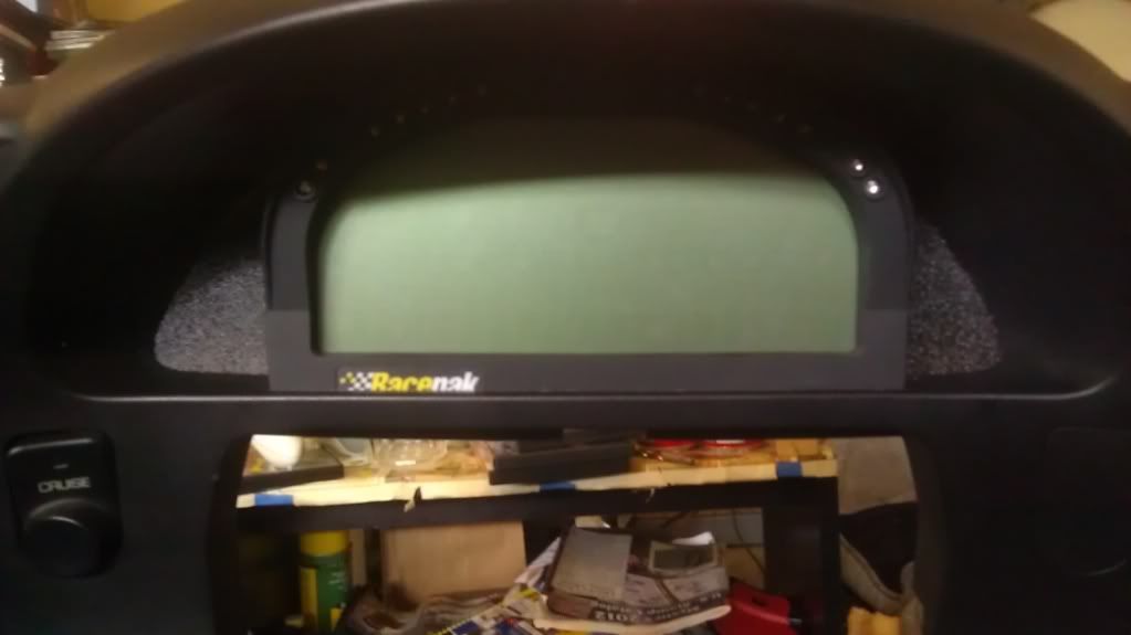

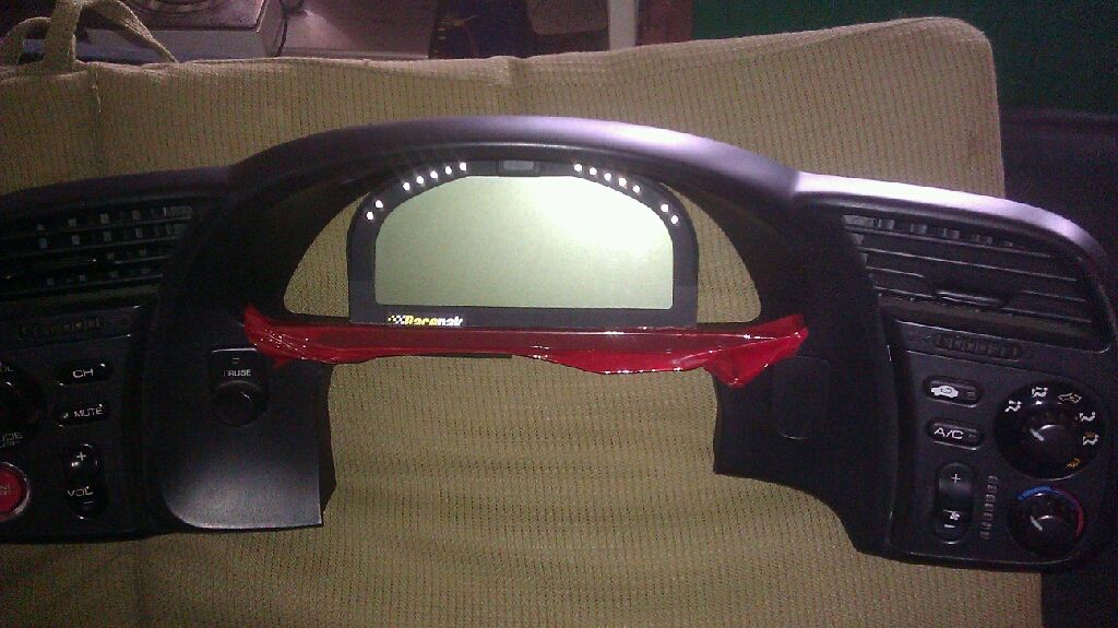

And the start of my cluster setup

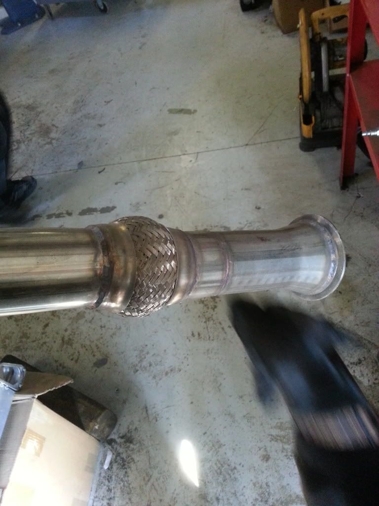

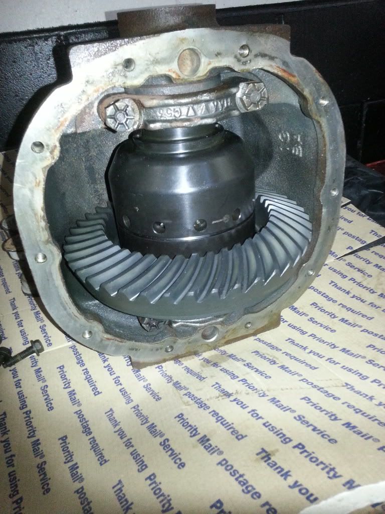

ell wavetrack lsd for the 8.8 showed up so I got it installed today and got the back lash set also finished up my cluster and down pipe yesterday, gonna test fit my engine/trans tomorrow if I aint working then if all clears with no issues im assembling my engine sat

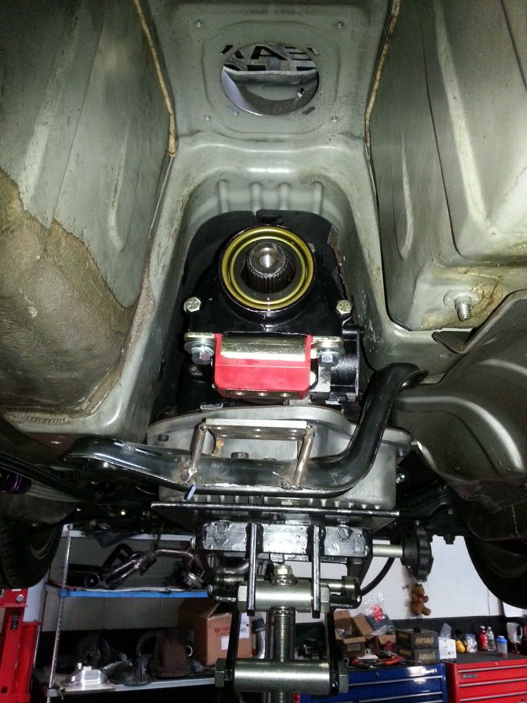

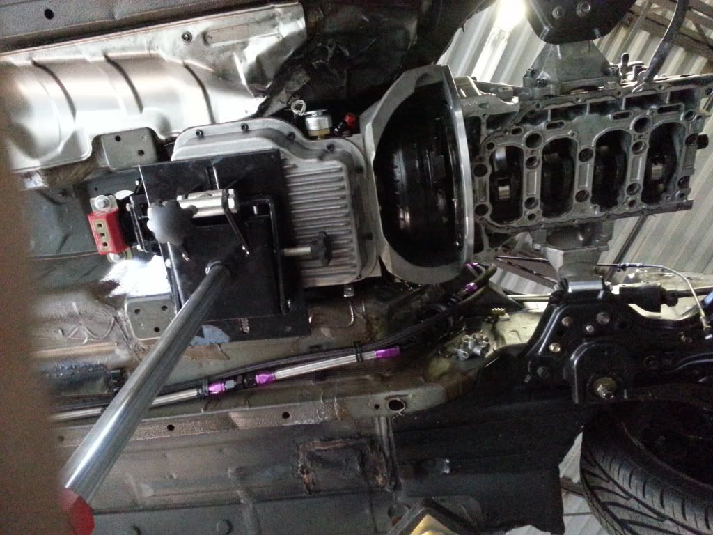

Didn't have to work today so I pulled my car out of halfblown and got it in to fullblown so I could get this trans test fitted and get the mount made for it. turned out well though nothing my 2lbs hammer couldn't solve for me lol also got a pass side harness for my pass so they have a little piece of mind when we out on the streets and my revised mounts showed up also

Custom sfi certified billet flexplate finally showed and thats all I needed to get this slut up and running boo ya
