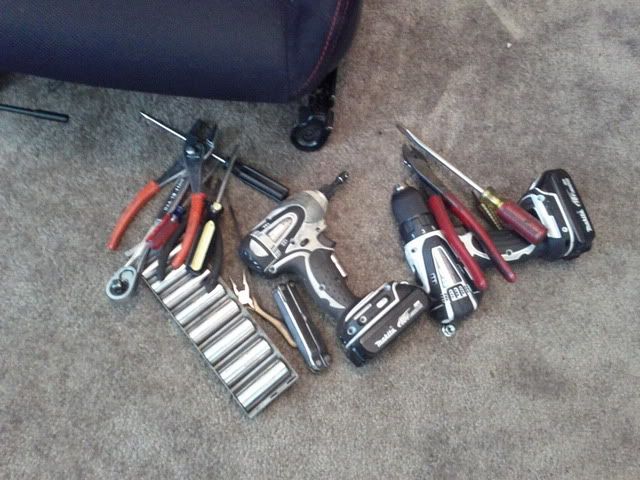

tools required (more or less)

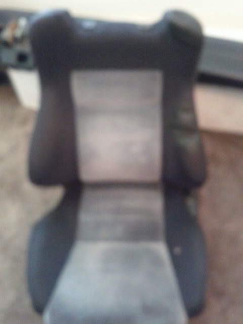

CRX seat (victim #1):
blurry, hides the black fabric duct tape holding it together lol

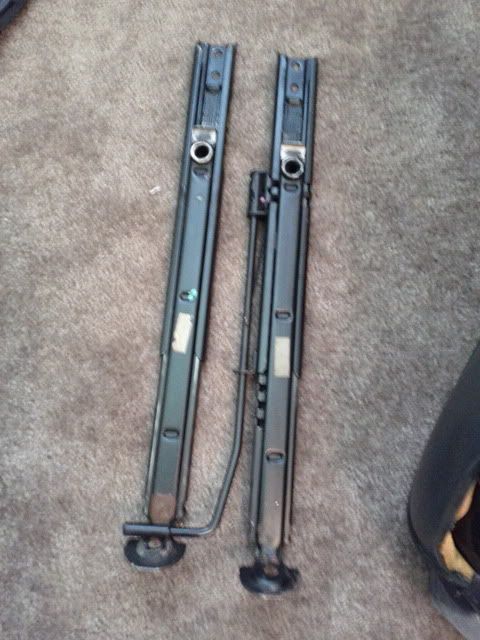

rails
these are keepers, put them in the good pile.

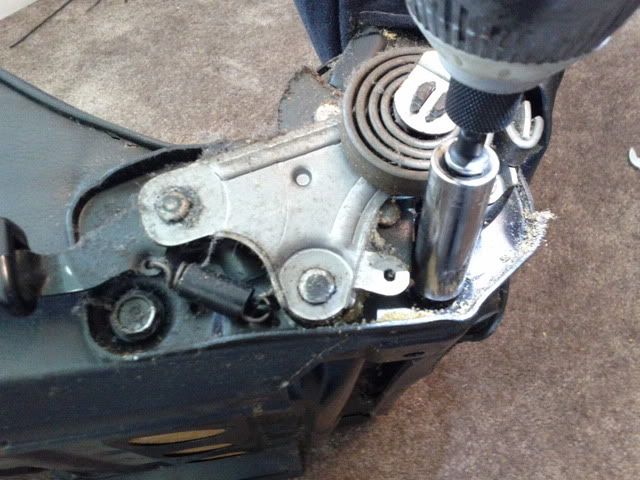

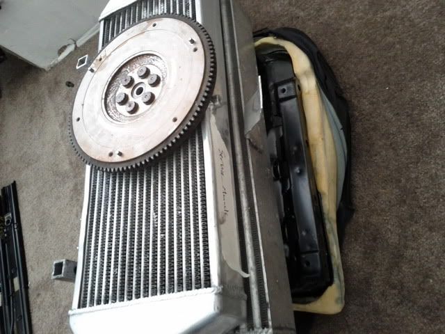

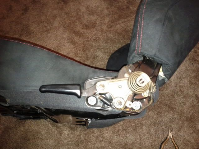

recliner
2 14mm bolts here, one might be hidden, just adjust the seat backwards and you get to it.
other side

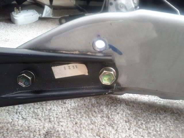

19mm

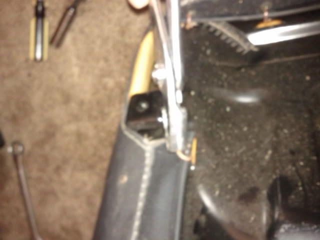

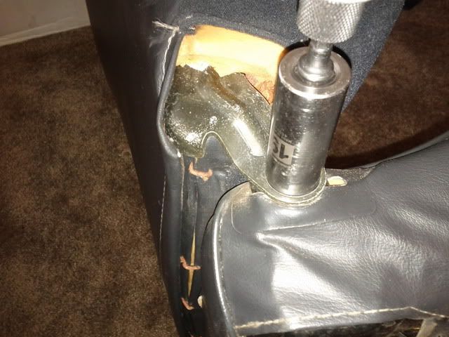

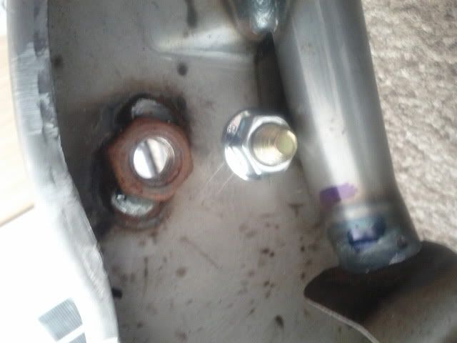

top recliner bolt (14mm)

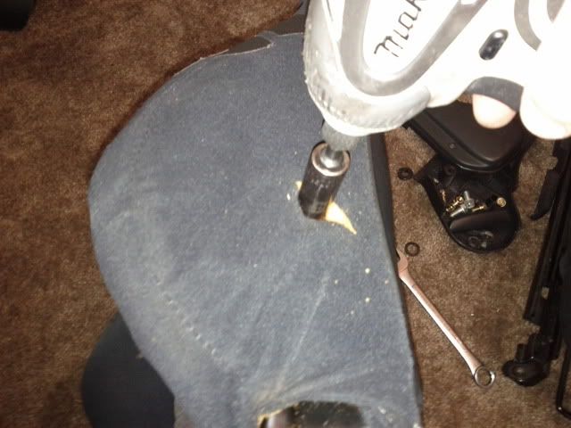

LOL. there are 2 bolts. one is super visible. the other is up like 4inchs (pic of bare recliner below for reference). the CRX seat is fucked, figured it would speed up if i just cut a new hole. for the long way look at the ITR seat disassembly.

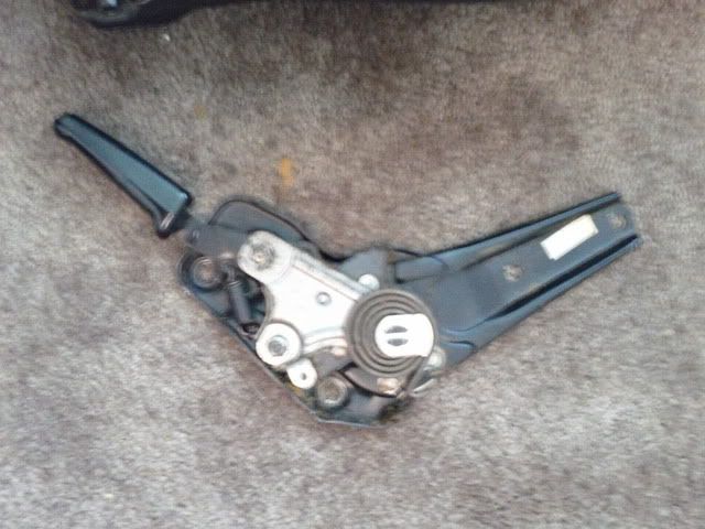

recliner
KEEPER!.. fuck my phone is being a bitch with pics today.

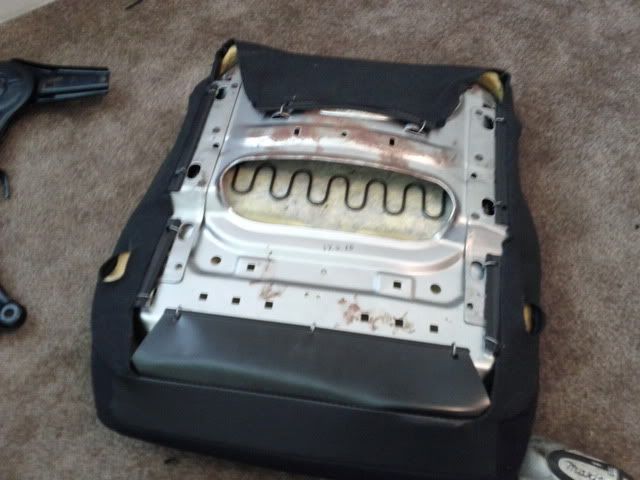

hog rings
sorry, blurry ass pic...
FUCK'EM! they suck ass, your not gonna reuse them. bitch to cut. so what i was doing was grabbing them with pliers, and twisting them (counter-clockwise, but im sure they will be different depending on who was in there last) and ripping them out. youll get it down after a seat or 2..you got 4 to do lol
remove all of them.

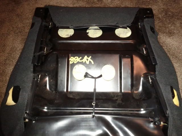

then peal the cover far enough for the pan to drop.

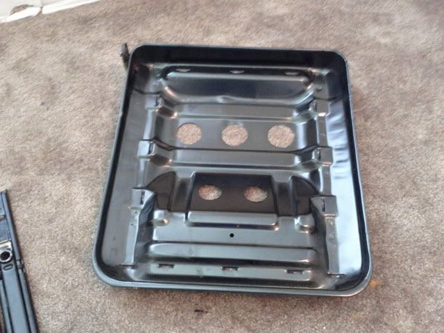

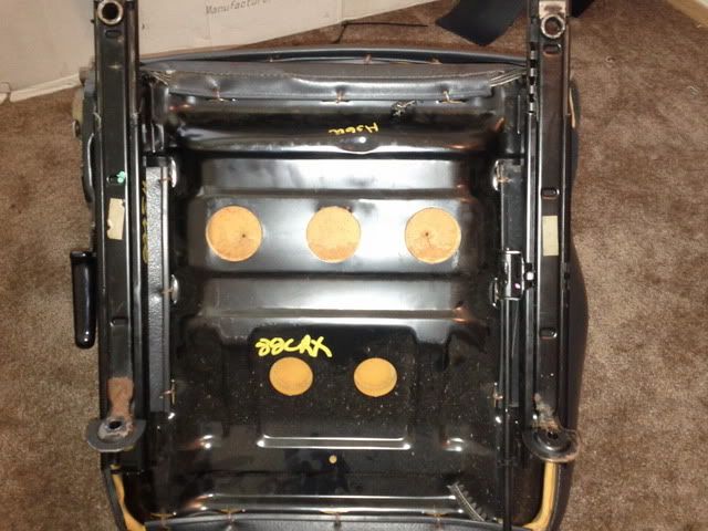

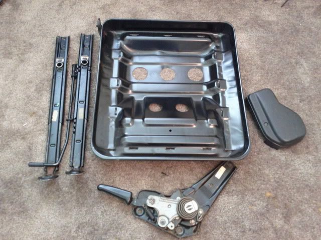

pan
KEEPER!...
KEEPERS!
yep. all that work for these parts. hopefully you didnt have to pay anything for your seats... think i was $50 into mine.

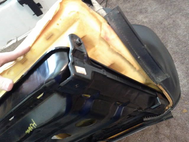

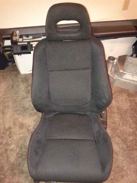

ITR seat (victim #2)
minty fresh. seriously, its near perfect, just dusty

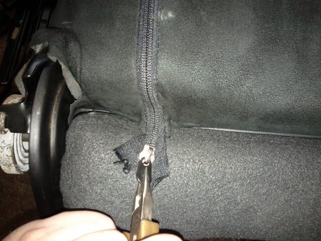

zipper
bet you never knew that fucker was hiding in there? x2 one on each side
oh yeah, the back and front come together and have like an interlocking thing. you will see it. you push on the seem, the two will separate. just the opposite going together.
zzzip

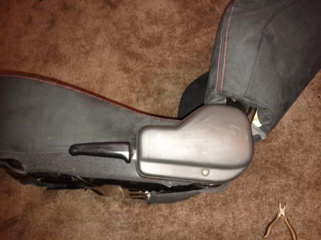

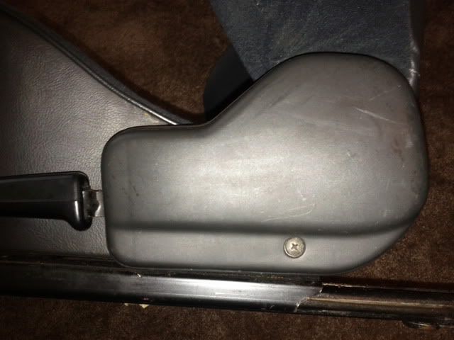

MISSING PIC!
shit, but its easy. remove both side plastic covers. and the recliner handle. tricky to remove the handle, but your not gonna reuse it, so dont stress it.

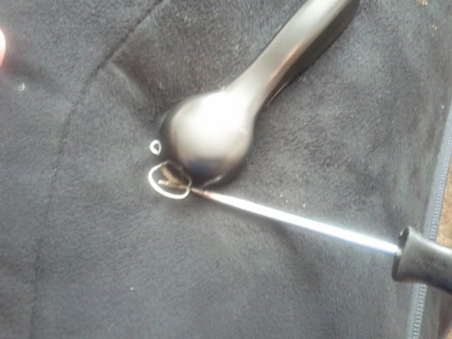

more hog rings!
fuck.... you can also, if you can anyway, slide a screw driver in the ring and pry on it.

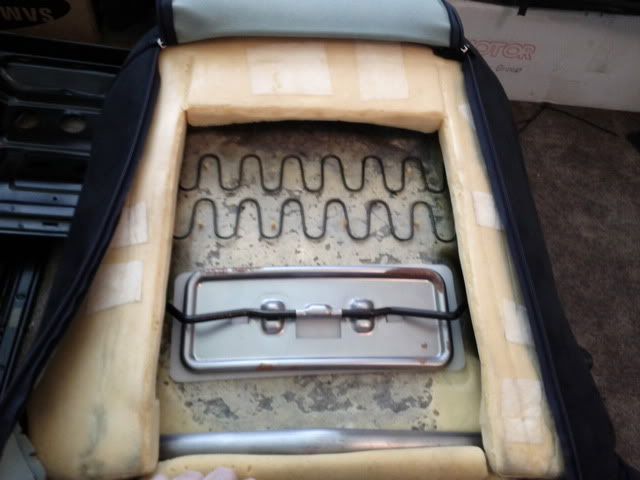

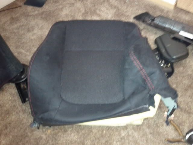

really the same as the CRX seat. remove rings, carefully peal seat cover (your reusing it remember) throw the pan away. you just need the foam/cover. <~KEEPER

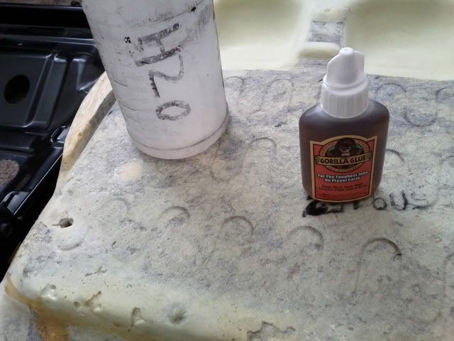

glue?
test fit your CRX pan to the DC2/4 seat bottom. its not perfect. mine kinda wanted to pop up some, out of its little track/trench. so i got some glue. this shit says it works on foam and metal. also said it needs light moisture to cure.
weight
sets in a couple hours....so i went to family dinner.

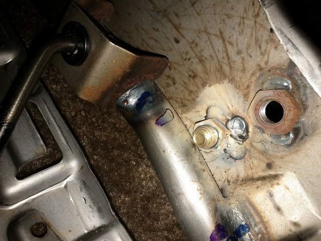

FLUX CORE. this IS a RHMT project isnt it? CRX + fluxcore = RHMT
im sure not needed. but solid. and if i ever take it back apart the fuckin nut wont fall out lol. but i have a welder, so its quick/easy. welding is fun anyway.
btw, tighten those fuckers down good now.
