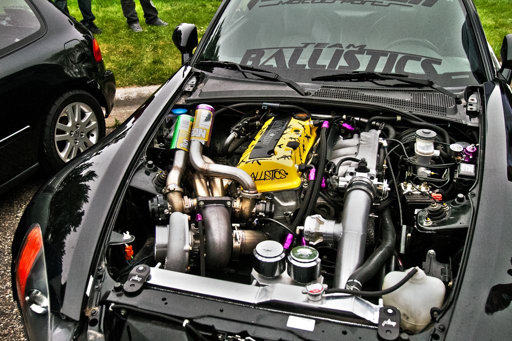

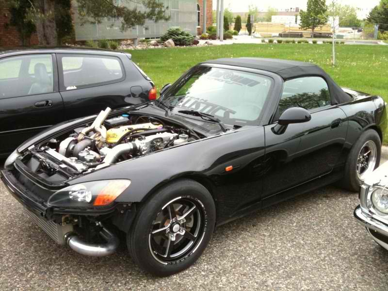

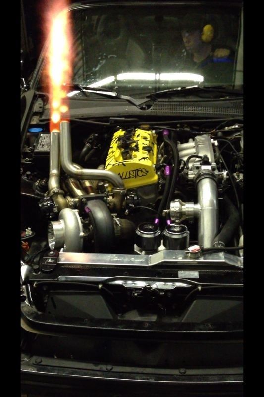

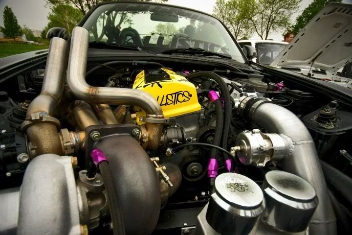

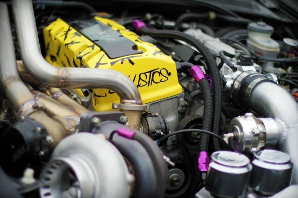

so i purchased a ap1 s2000 three weeks back and decided that i was gonna go after the stock short block record for hp for s2000 in my new drag project,the current record was 759hp tuned by fullblown motor sports out of mn on there dynojet 424, so me and fullblown decided we would give it a shot on my car to see if we could better that so here is a couple pics and dyno vids of the car, and agian thanks to lj at fullblown cause with out him i prob would have never got these numbers out of this thing, and to do it all in two weeks start to finish is quit a accomplishment in it self, enjoy
Engine
Stock f22c
Ferrea Springs/retainers (We knew stock springs and retainers were the only thing that could spoil the party)
FBM H11 Headstuds
Turbo
FBM Stage 2 manifold Twin scroll
FBM 800hp Intercooler
FBM Intercooler piping and Downpipe/dumptube
Precision 6766 JB
Precision 46mm Wastegates
Tial 50mm BOV
Fuel
FIC 2150s
FBM XXL Fuel Rail
FBM Dual Pump Hanger
FBM FB340 pumps
FBM Fuel Regulator
FBM -10 Fuel Filter
Drivetrain
FBM Supra V160 Conversion
FBM 8.8 Rear Diff kit
FBM/DSS 5.9 Driveshaft/Axles
FBM Delrin Bushings
FBM Spec Clutchmasters Twin Disc
Misc
FBM Catchcan
FBM Radiator / Hoses
FBM Billet Radiator Brackets
FBM Spark Plug Cover
Haltech PNP ECU
Racepak Dash
TUNED on E85 @ 30-31 Psi.
This won't be no dyno queen.  We are going to test this at the track shortly :)

Fuck anti lag is so loud its making the back window of the white car move! :o
