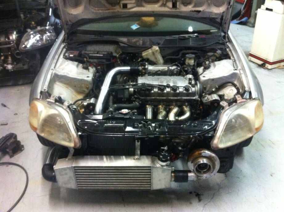

Figured my car is almost done so its time to post a thread.
here is my budget build
Bought this car from a rip off little car lot. I rear ended someone and long story short i got it back for free.
Was a cruiser for a while then got the urge to be able to merge on the freeway better. So i put a simple kit on it still retaining the ps and ac
Car made 180hp on 8 psi.

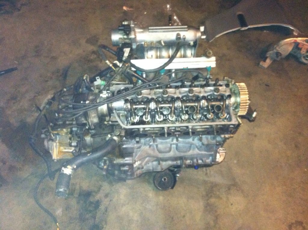

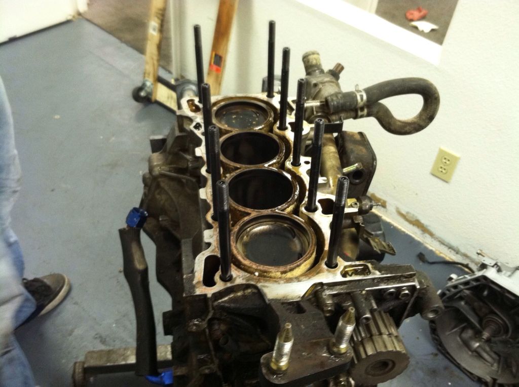

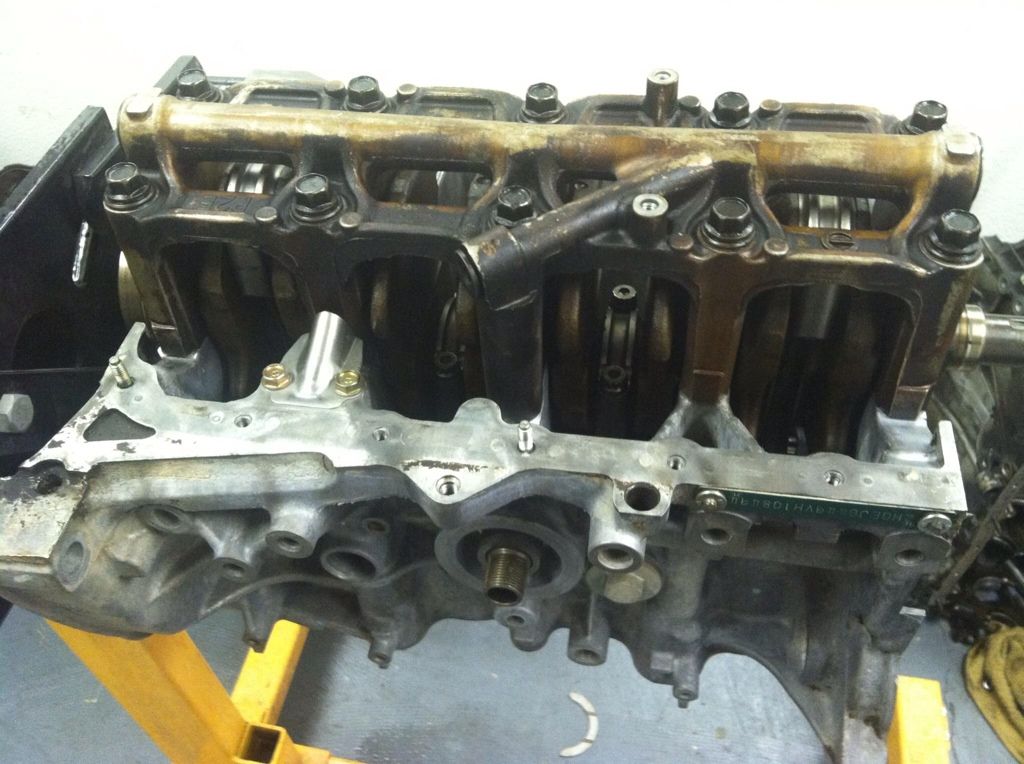

put it on e85 and raised the boost to 16psi... with 190k on it the motor spun every bearing in the motor.
so started the tear down

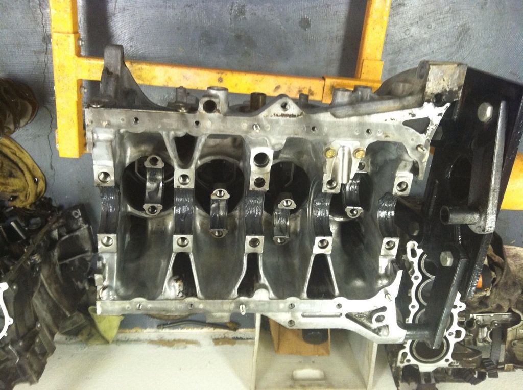

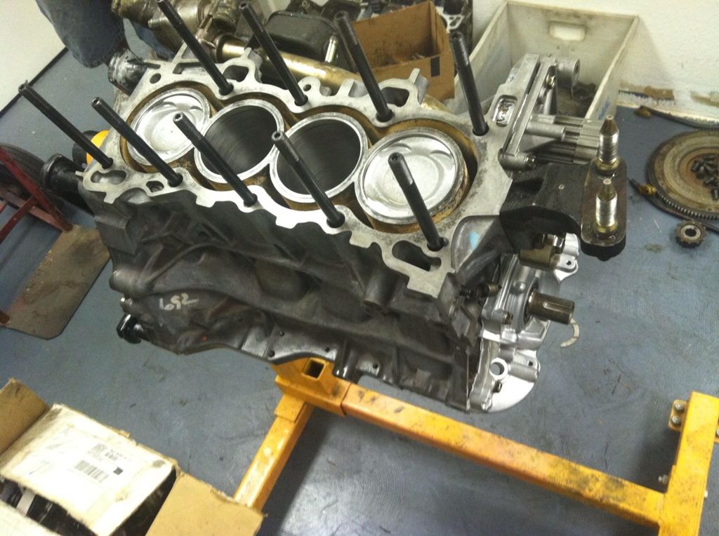

Picked up some eagles and some vitara pistons. A vato assembled the bottom end, block and girdle notched for the rods.
all together
Sold the old set up and started on one i could grow into

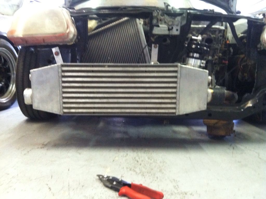

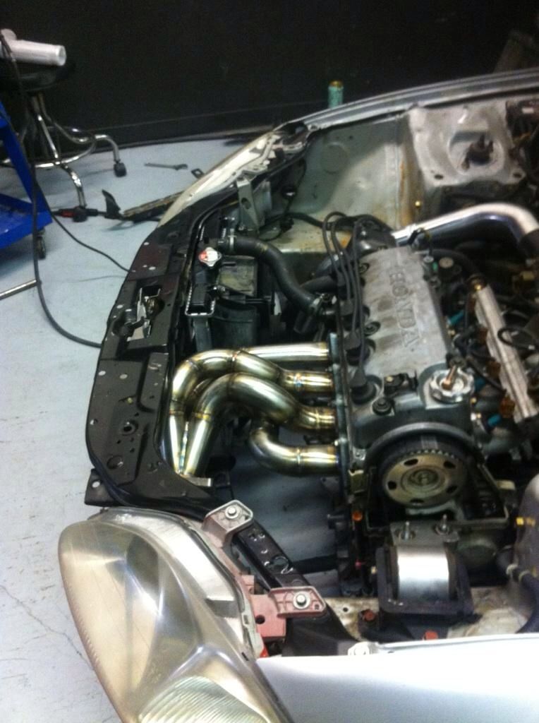

450hp intercooler, tial 50mm getting mounted

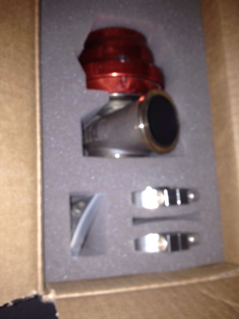

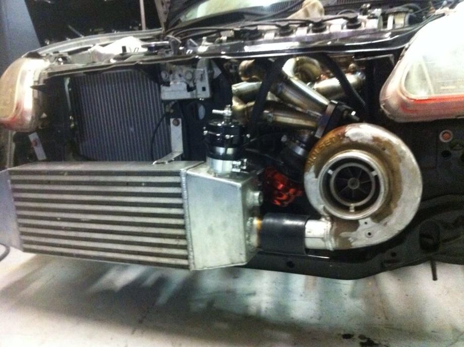

Tial 44mm gate

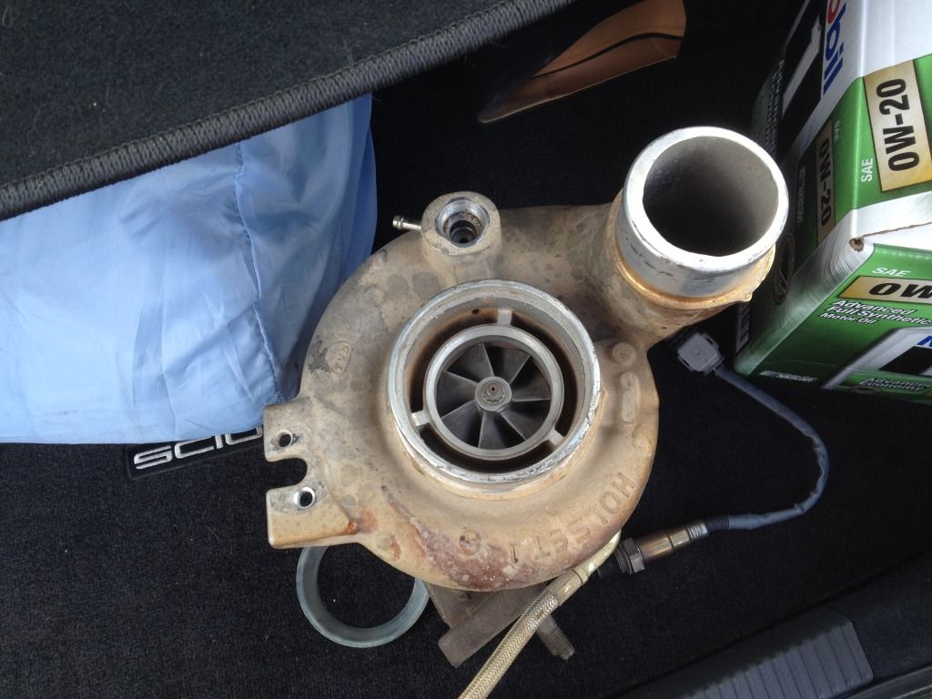

Picked up the big ugly holset he351

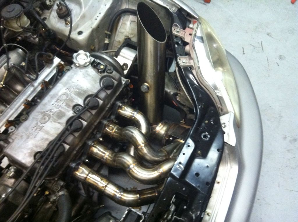

Modified the housing quite a bit to get it to work.

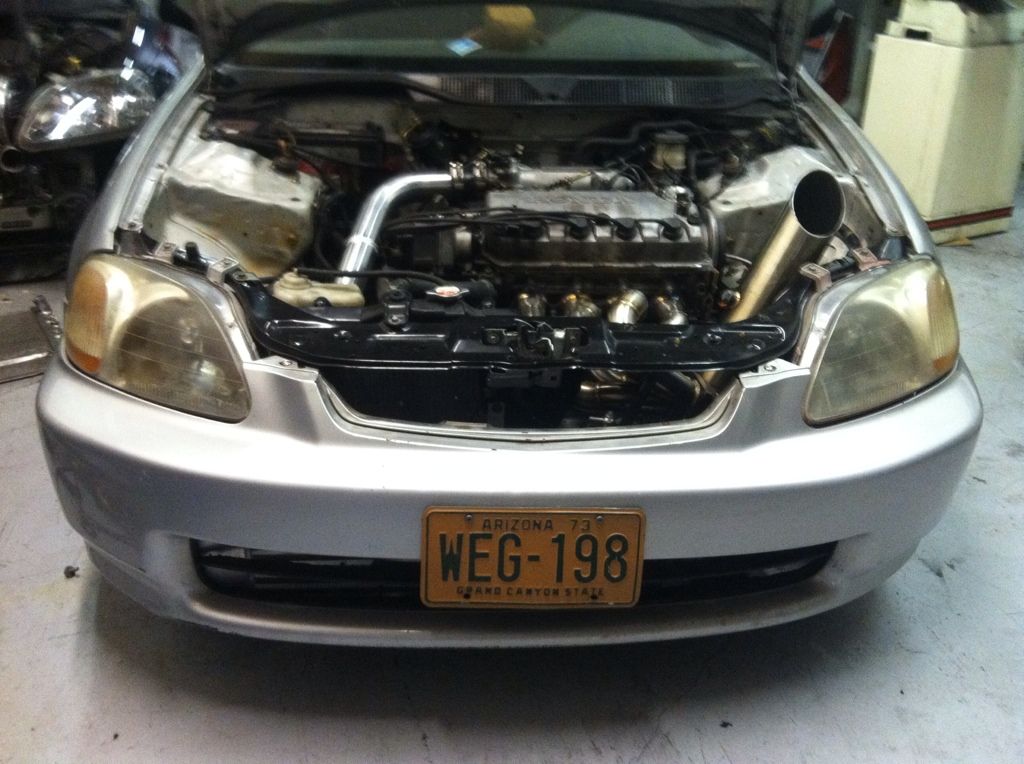

Here is how she is today almost done just need the downpipe made tomorrow and ill be back on the road
Bumper still fits
hoping for 400-450 on the stock head.
dont mind the dirty bay, will be cleaned when i bring it home
Daniel at boost junkyz did an amazing job with what I gave him.

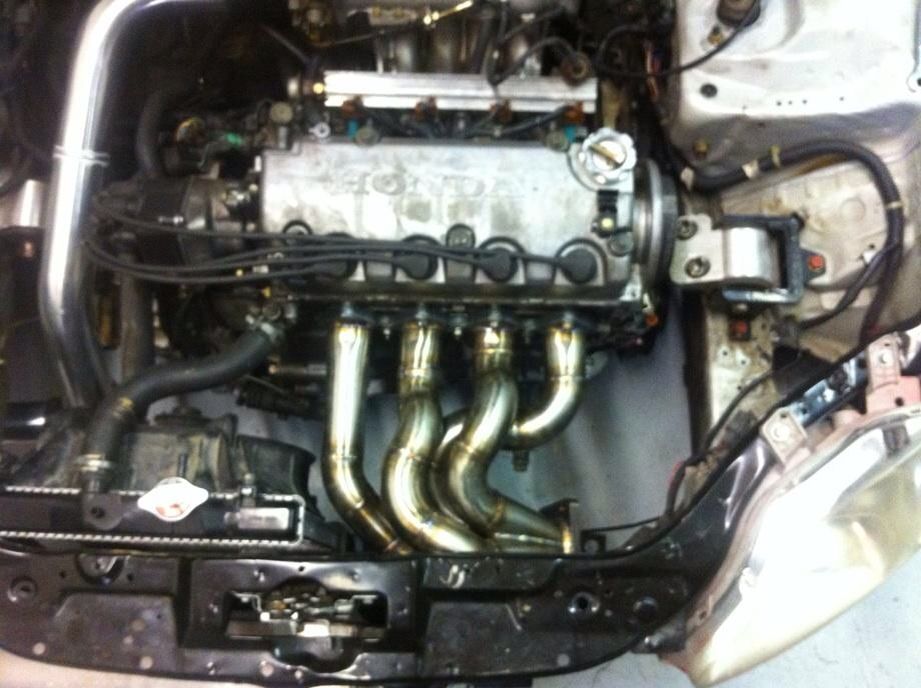

« Reply #2 on: May 08, 2012, 09:06:25 AM »
Fuck thats solid! Is that a twin scroll manifold?
Rx7toCivic
  • Posts: 46
Re: Round 2 on this pile of shit
« Reply #3 on: May 08, 2012, 09:57:47 AM »
No just open.
Wanted to go with a t4 framed setup but this is what I could find for the money I wanted to spend.

Shit's proper all sorts of bad ass!
Questions:
What are you going to do for oil drainage?  Pump of sorts?
What caused your bearing failure?  Bolts let go?  Shitty neglected oil?   Oil pump having trouble getting it up?
Rx7toCivic
  • Posts: 46
« Reply #6 on: May 10, 2012, 09:56:37 AM »
Pump was old. Just good old lack of oil pressure.
The drain is fine, turbo is still above the top of the pan, it's about the angle of a handicap ramp.
All done for now. Need to clean out the bay, swap the 660's for 1000's when I grab a resistor box then make a dyno appointment.

367/300 then the intercooler cracked at 27 psi. fail
