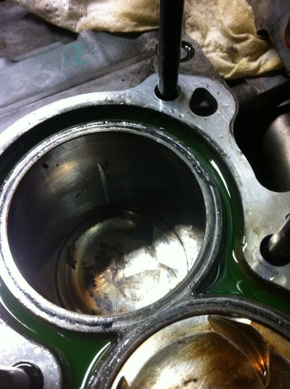

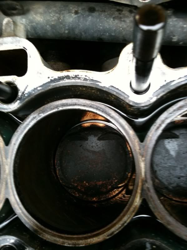

Been very busy but finally had some time to take the head off for inspection. First thing I notice was the metal in the pan. About a nickle sized chunk. I take off the girdle and plate to look into the engine and sure enough I notice #4 piston is toast on the bottom where the wrist pin is. Wrist pin floated to the side and made the mark you see here. I will take more pics of the carnage later.
Re: PTW clearance issue.. Question on piston slap
« Reply #19 on: July 09, 2012, 11:03:42 AM »
Could be my phone, but do the tops of your sleeves look fucked?

Re: PTW clearance issue.. Question on piston slap.. Problem found
« Reply #21 on: July 10, 2012, 11:26:34 AM »
Bad install.........
« Reply #22 on: July 17, 2012, 05:04:01 PM »
Is there a section of piston missing, or did the spiral lock/clip come out? It would be roughly nickle-sized.
